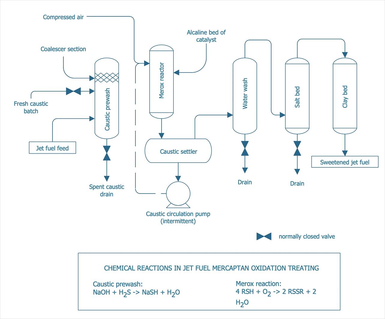

The list data structure in Python is more commonly referred to as an array structure in other programming languages. There are a myriad of resources online giving textual definitions of what a list is. So rather than repeat common literature, let’s use a manufacturing process example to better suit our controls engineering domain. Let’s take an arbitrary chemical process “Jet Fuel Mercaptan Oxidation Treating” as illustrated below.
Process flow diagram
Figure 1. Chemical process flow used to relate concepts of a Python list. Image used courtesy of ConceptDraw
In our chemical process, there are numerous individual equipment entities analogous to variables of data types. These include the pump, pipewash, reactors, and beds. While each of these elements is singular, it is the collection or union of them within the process that is of importance. An engineer could not obtain the desired outcome of sweetened jet fuel with a single reactor. The list data structure, much like the process flow diagram, groups these individual entities together for the importance of the domain application. The analogous Python list appears as below:

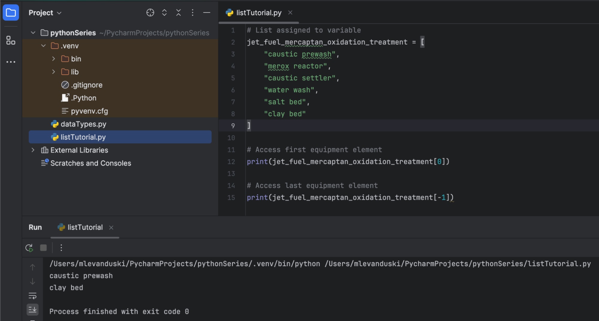

Lists in Python retain the order or placement of elements within them by using an index. The index is a numeric indication of an element's place in the list. We can access the equipment position by calling the list variable with square brackets containing the index value like below:
The first item is denoted by position 0 which may conceptually seem odd. However, much like in many PLCs, Python is a 0-based indexing system which is a fancy way of saying the first element is denoted by a 0 instead of a 1. The return in PyCharm is below:
Numeric index value
Figure 2. Using the numeric index value to access equipment specified at that place in the list. Image used courtesy of the author

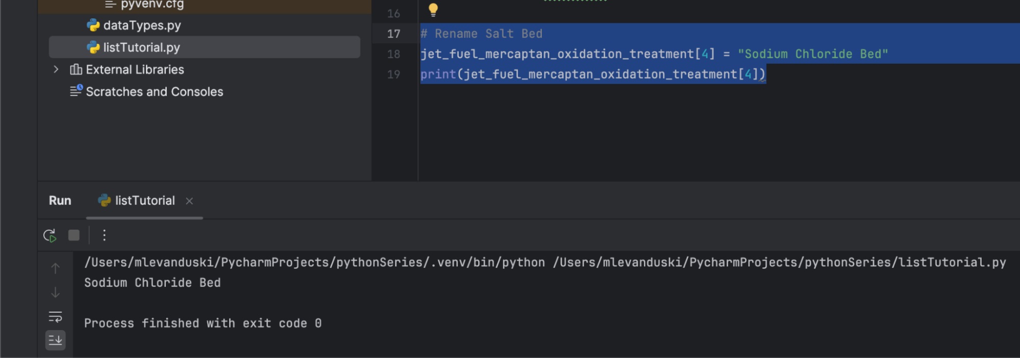

Mutability is a complex way of saying that individual items within a list can be changed. Continuing with our example, let's say an engineer wanted to rename the salt bed to indicate a more specific name such as “Sodium Chloride Bed”. One way to accomplish this is by reassigning the index value of the “Salt Bed” item to “Sodium Chloride Bed”:
The output of the fifth equipment element (remember, this is item #4 starting at #0) in our list now appears as below:
Renaming elements
Figure 3. Renaming an equipment element in the list. Image used courtesy of the author
