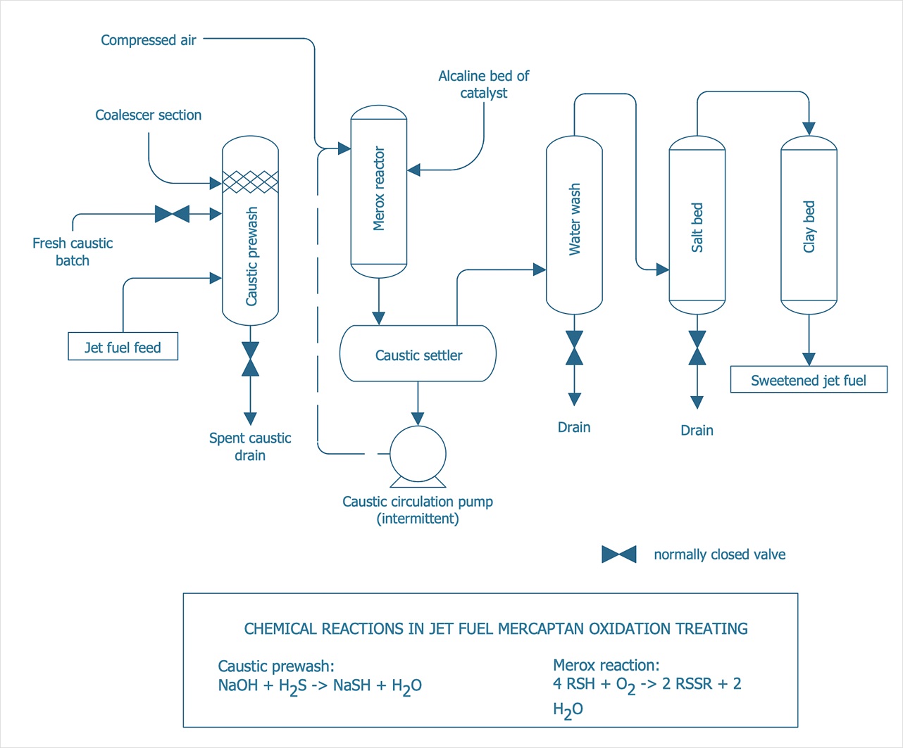

Chemical process diagram
Figure 1. A chemical process diagram used to relate concepts of a Python dictionary. Image used courtesy of ConceptDraw
Using the handy chemical process flow in Figure 1 again, each of the equipment objects in the process should be viewed as a collective whole. A dictionary allows us to group objects together just as the list does.

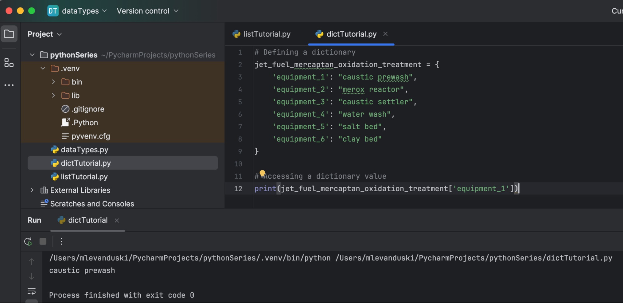

Dictionaries, like lists, preserve the order of objects. Order of equipment in the jet fuel mercaptan oxidation process is important to obtain the desired sweetened jet fuel product. However, instead of specifying a numeric offset, dictionary objects are accessed by indicating the key name:
Accessing a data value in a dictionary
Figure 2. Accessing an indicated data value by recalling a key name. Image used courtesy of the author

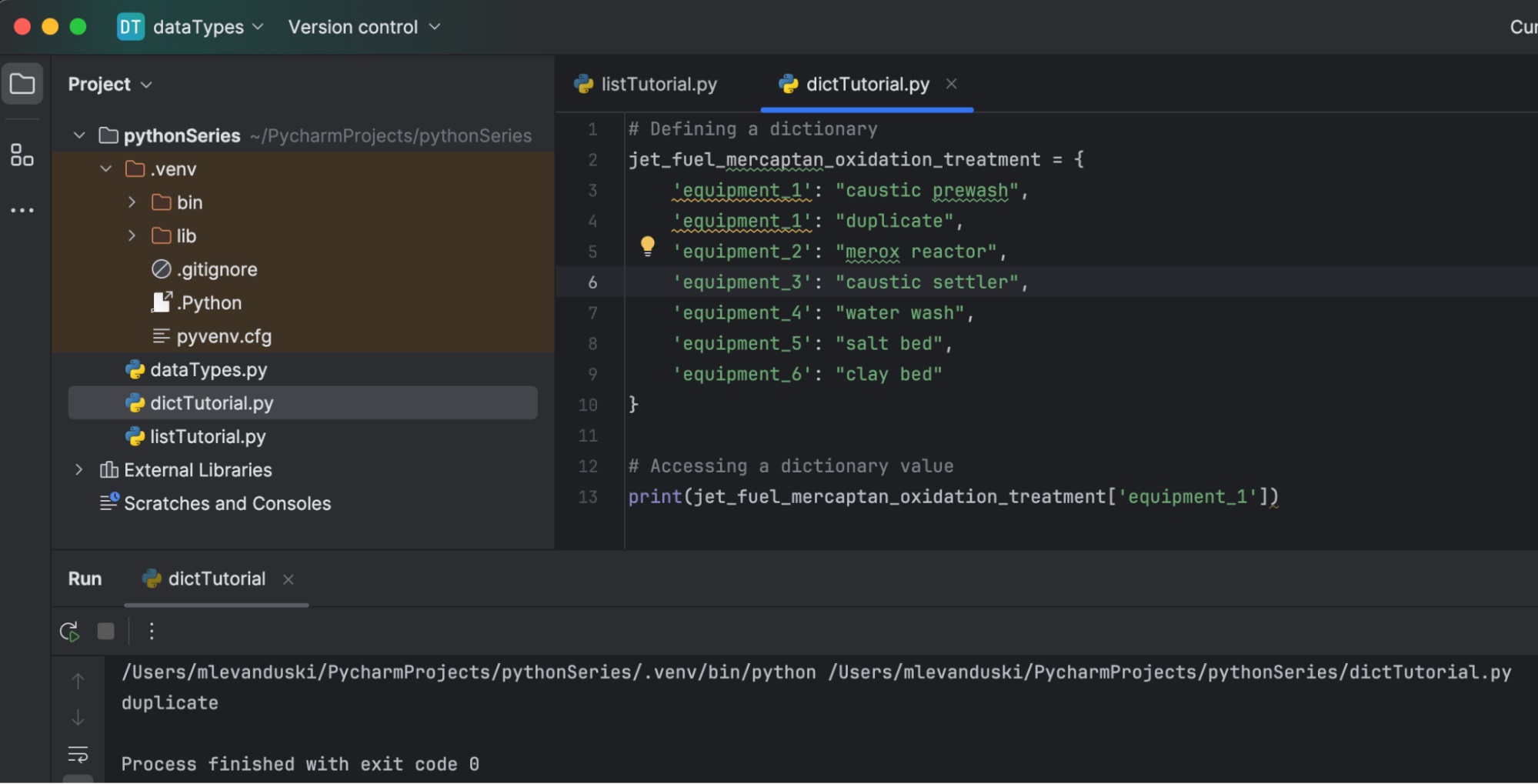

Duplicate Keys

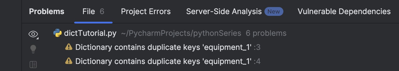

What would happen if we had 2 keys of the same name? Wouldn’t pulling the associated value cause a conflict? Let’s try it out for a duplicate “equipment_1” key:
Duplicate key name example
Figure 3. An example of an error-prone duplicate key name. Image used courtesy of the author
The return will be the second key overwriting the first key, as shown above. However, dictionaries should not contain duplicate keys; notice how the Pycharm editor has issued yellow squiggly lines underneath 'equipment_1?' It is a warning that duplicate keys are a bad idea:
Duplicate key name error message
Figure 4. Error resulting from a duplicate key name. Image used courtesy of the author

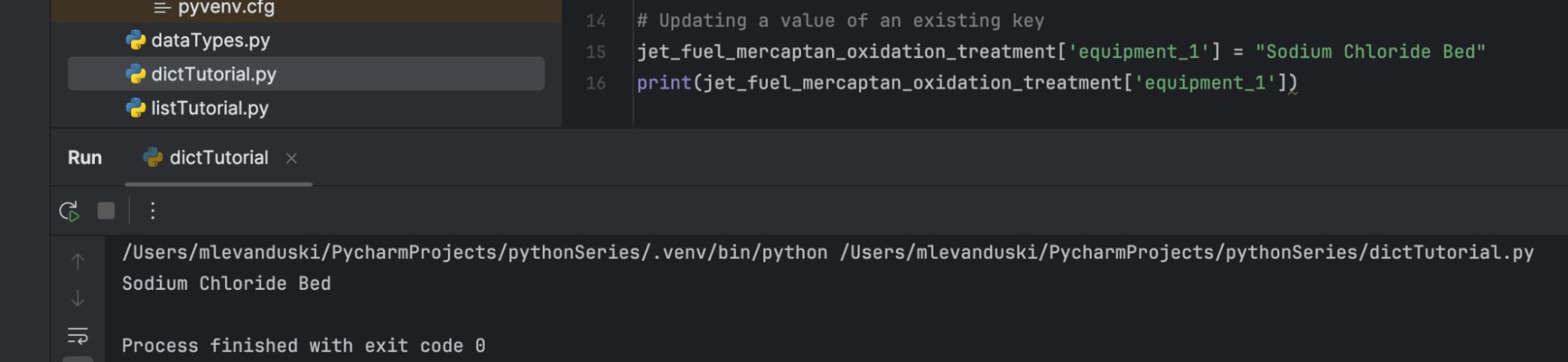

Updating a Value
Let’s say that our engineer once again wants to update the “Salt Bed” equipment name to “Sodium Chloride Bed”:
Editing a variable key name
Figure 5. Editing the name of a variable in a data set. Image used courtesy of the author
We update the value by accessing the existing key name ('equipment_1') and reassigning it with the value of “Sodium Chloride Bed”.

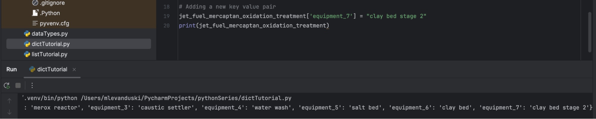

Adding a Key Value Pair
The engineer managing this process wants to add a second stage of water wash equipment to the process. This can be accomplished with the same syntax used to update an existing key’s value:
Adding a key name entry to a dictionary in Python
Figure 6. Adding a new entry to the data set. Image used courtesy of the author

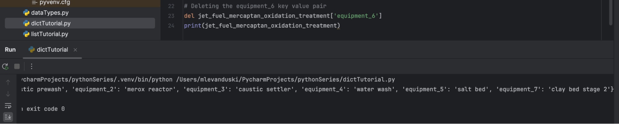

Deleting a Key Value Pair
After adding the second stage clay bed, the engineer realizes the new equipment added is much more efficient than the original clay bed assigned to the ‘equipment_6’ key. Deleting the original ‘equipment_6’ key from the process can be accomplished with the del keyword:
Deleting a value from a Python dictionary
Figure 7. Deleting an entry from the value set. Image used courtesy of the author

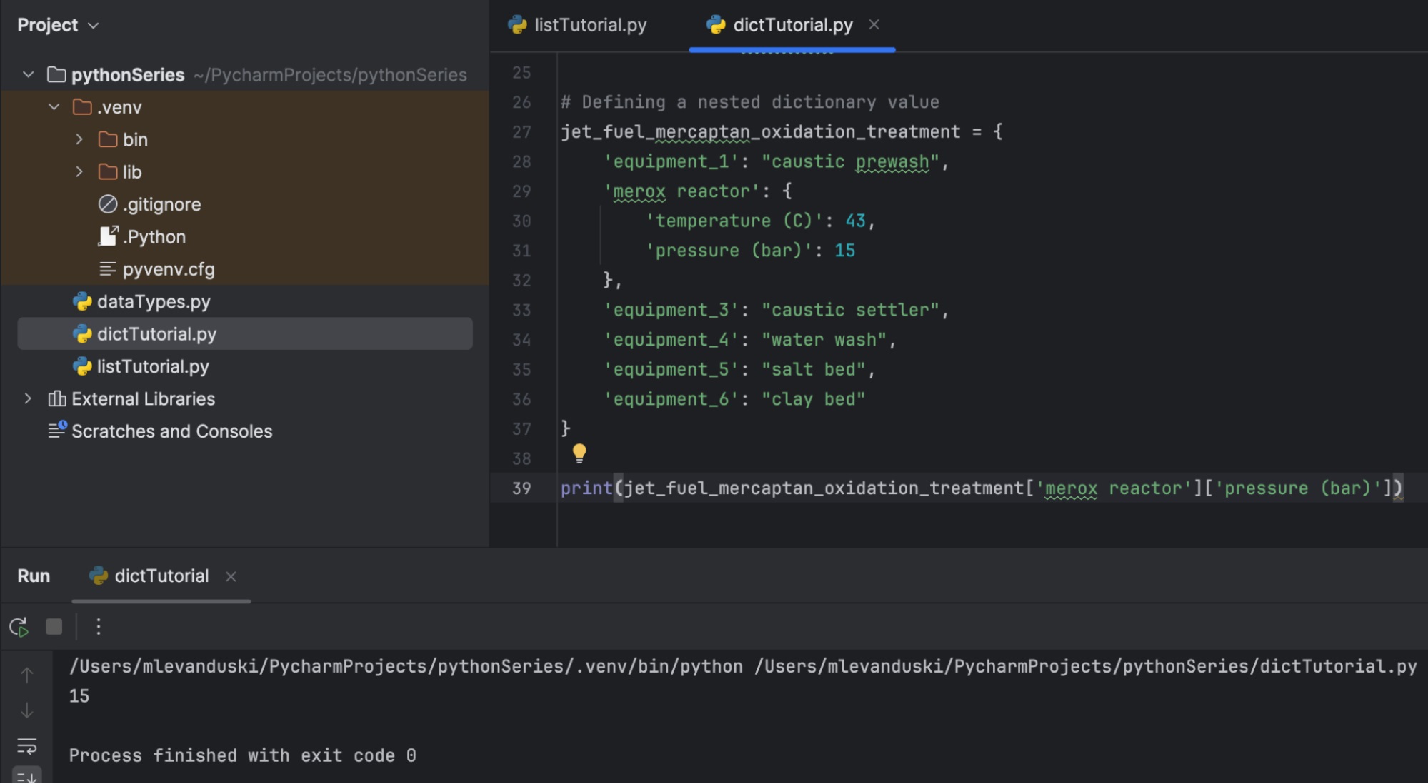

Nested Dictionaries
From an engineering perspective, a benefit of using the dictionary structure is the ability to assign additional metadata to objects. In the jet_fuel_mercaptan_oxidation_treatment chemical process, the equipment objects have many more associated attributes than just a textual name. For example, temperature and pressure are often the key parameters to a successful chemical reaction. An engineer managing this process could log and display the temperature and pressure parameters of the Merox reactor by using a nested dictionary:
The actual values would likely be an integrated real time data feed, but for the scope of this article we will harcode integer values.
Accessing nested dictionary keys requires slightly different syntax. Let’s access the pressure value of the reactor:
Nesting an entry in a Python dictionary
Figure 8. Accessing a value nested within a parent data entry. Image used courtesy of the author
