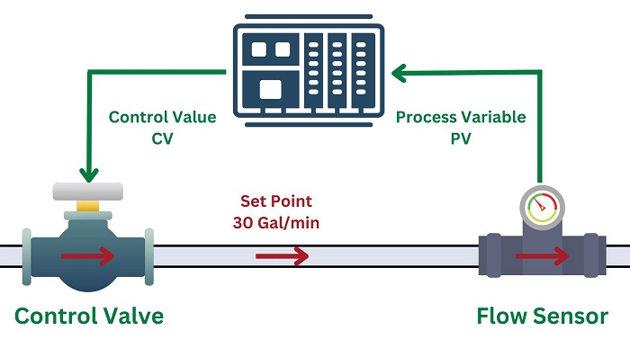

Before diving further in how to work with tuples, why is immutability important? Take an example of a PID control block throttling a valve to control the flow rate of gas in a line. In this example, once the Kp, Ki, and Kd are tuned to control the gas flow rate they should not be changed.
Some industries are heavily regulated, including medical, pharma, or food & bev. But in various other, less highly regulated applications, parameters have a tendency to drift in production during “troubleshooting” steps taken by well-intentioned technicians or operators.
In the following gas line scenario, manipulation of the PID tuning may be disastrous and compromise the safety of personnel and plant assets. In this theoretical example, you would use a tuple to maintain the tuning integrity of the controller in the fast-paced automation environment.
PID flow control example
Figure 1. PID control of valve controlling gas flow rate in a pipe.
Using a Tuple Literal
To construct the tuple for the process in Figure 1, we will first use a tuple literal. This is straightforward, we will create parentheses and define each of the Kp, Ki, and Kd parameters within the parentheses For more info about these parameters and PID loops in general, check out this article, then pick back up right here.
