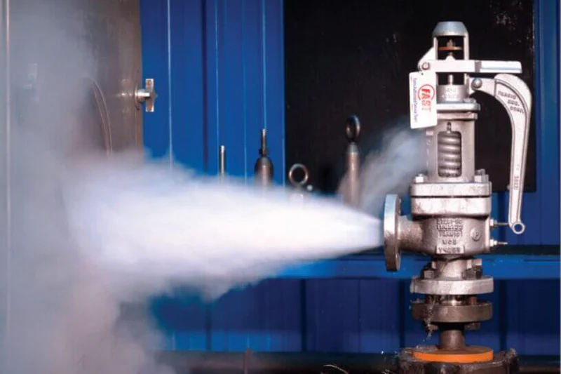

Conditional statements are the first form of control flow we will learn. They are known formally as if / else statements. The underlying logic of if / else statements is likely something you have encountered before in the controls automation space. Take, for example, the pressure relief valve below.
Pressure relief valve in action
Figure 1. Pressure relief valve. Image used courtesy of Liberty Supply

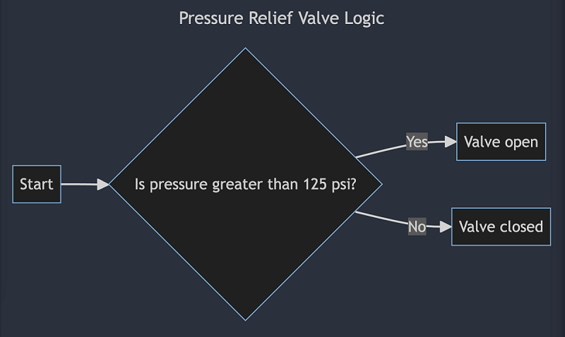

The valve is a safety mechanism to prevent a system from over-pressurizing and exploding. If the pressure of the system exceeds a certain value, the spring force of the valve is overcome by the gas, and a blow-off of the excess pressure occurs. However, if the pressure remains under the critical threshold the spring pressure keeps the valve closed to the system. The logic can be visualized below.
Pressure relief valve logical flow
Figure 2. Pressure relief valve logical flowchart. Image used courtesy of the author
In Python code, the implementation of the logic that would run a digital version of our pressure relief valve might look like what is shown below:
The input function will allow us to enter a system pressure for the simulated process in the terminal. The pressure variable will be compared against the setpoint variable to determine if it is greater than the setpoint pressure. If greater, the valve will be set high to an open state. If the pressure is less than the setpoint, the valve will remain low in a closed state.

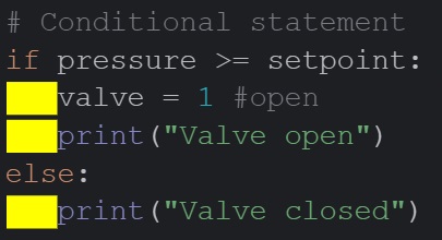

Indentation
Did you notice the indentation or spacing of code below the if and else keywords in the example? The spacing is highlighted in yellow in a high-contrast section of our code below:
Indentation in python code

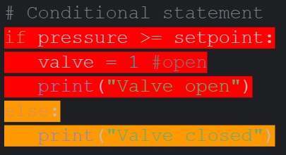

There is significance in the indentation. The indentation represents the code to execute when either the if or else statement evaluates to ‘True.’ The code is conditionally executed; not every line of code executes in the program. To visually represent this, the if block execution is denoted by red highlighting, whereas the else block is denoted in orange in this high-contrast image:
IF and ELSE components of python code
Depending on which condition evaluates to true, the indented code for either the if (red) block or else (orange) block executes, but not both. So, in our previous example, when the pressure was greater than the setpoint, the valve flipped high and activated. The else block was skipped since the if statement evaluated to true:
Similarly, when the pressure was less than the setpoint, the else block evaluated to 'True' and the orange single-line print statement was executed, “skipping” the if block:

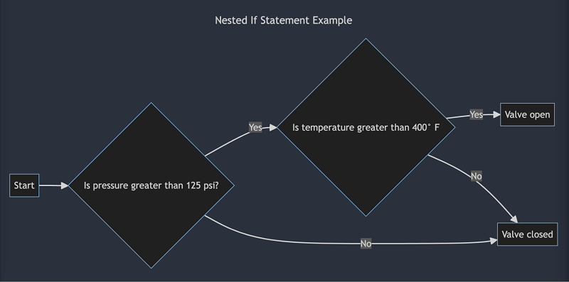

In the situation where there are multiple conditions in which one depends on another, nested if statements can be used. Our prior example had one condition: the pressure relief valve must reach 125 psi or greater to open. However, once this occurs, let’s say the process temperature must also be greater than or equal to 400° F for the pressure relief valve to open. Visually, this scenario is represented below:
Pressure and temperature relief valve logical flow
Figure 3. A scenario where temperature depends on pressure conditions. Image used courtesy of the author
Programmatically, the logic for this dependency can be given by the nested if statement:
