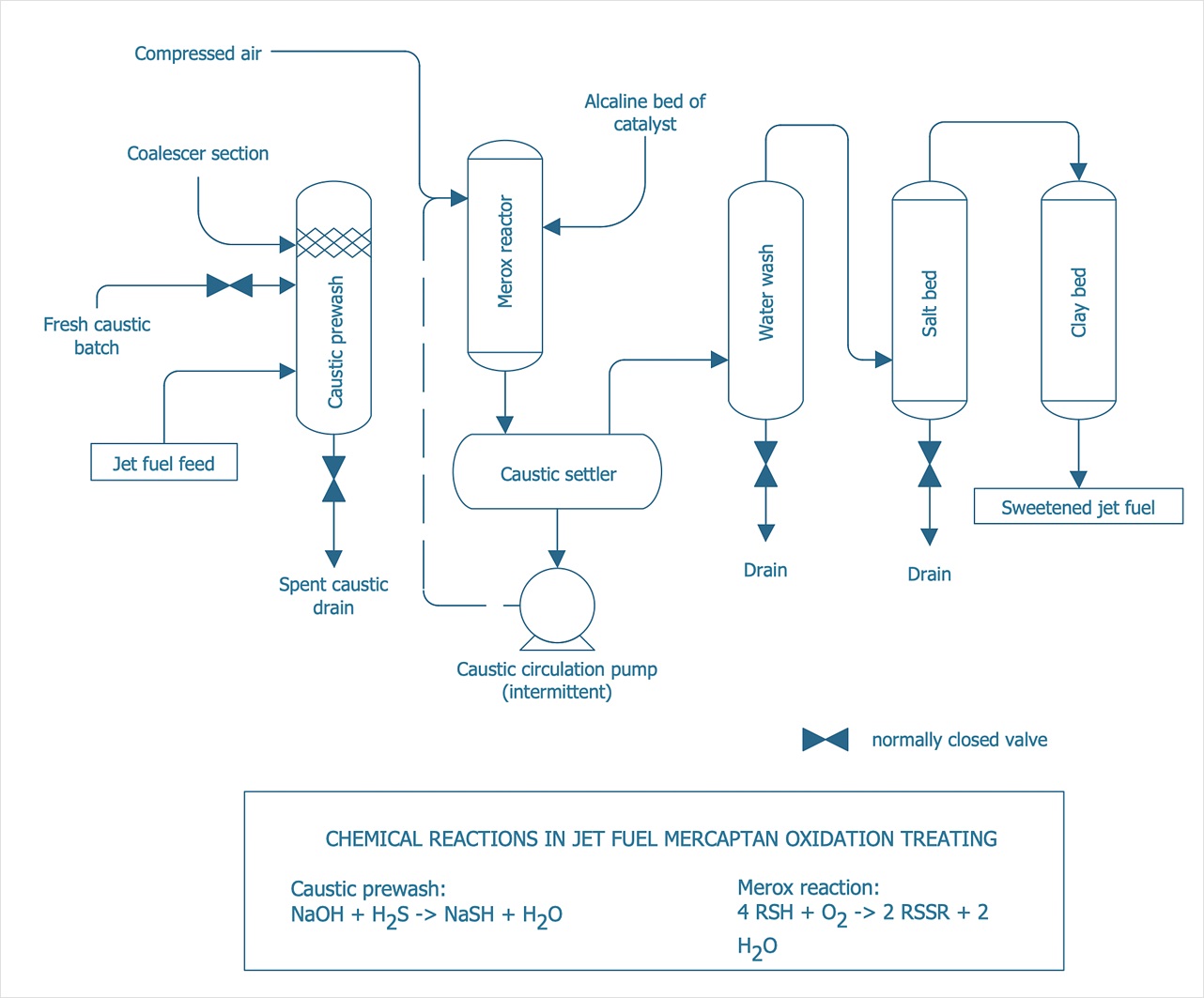

Let’s go back to our familiar example of the jet fuel mercaptan oxidation treatment used in learning lists. Recall the general process flow diagram below:
Figure 1. The chemical process flow used to relate concepts of a Python list. Image used courtesy of ConceptDraw

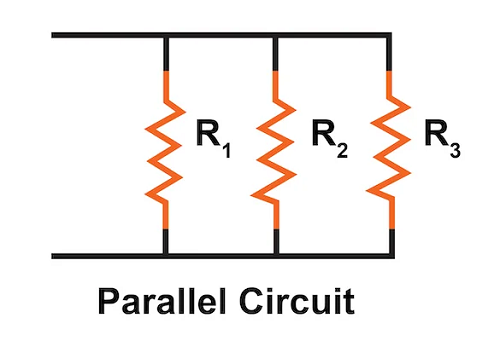

Working with individual lists is great for learning the basic concepts. However, in reality, some tricky situations arise where you may need to traverse two lists in parallel. Much like current flow through multiple resistors in a parallel circuit, the for loop can flow through two lists simultaneously.
Figure 2. Simple parallel circuit. Image used courtesy of allaboutcircuits
