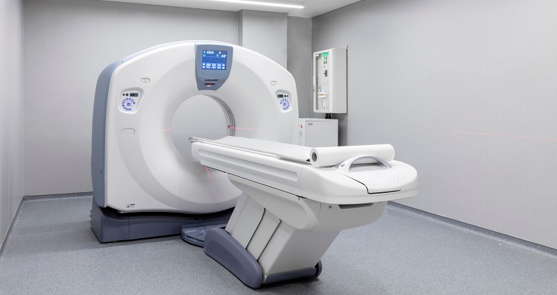

positron emission tomography (PET) scanner
Figure 2. A Positron Emission Tomography (PET) scanner. Image used courtesy of Adobe Stock
Scintillation detectors are ubiquitous in medical imaging devices, especially PET scanners, which use radioactive tracers to image internal organs and tissues. These detectors are also useful in environmental monitoring.

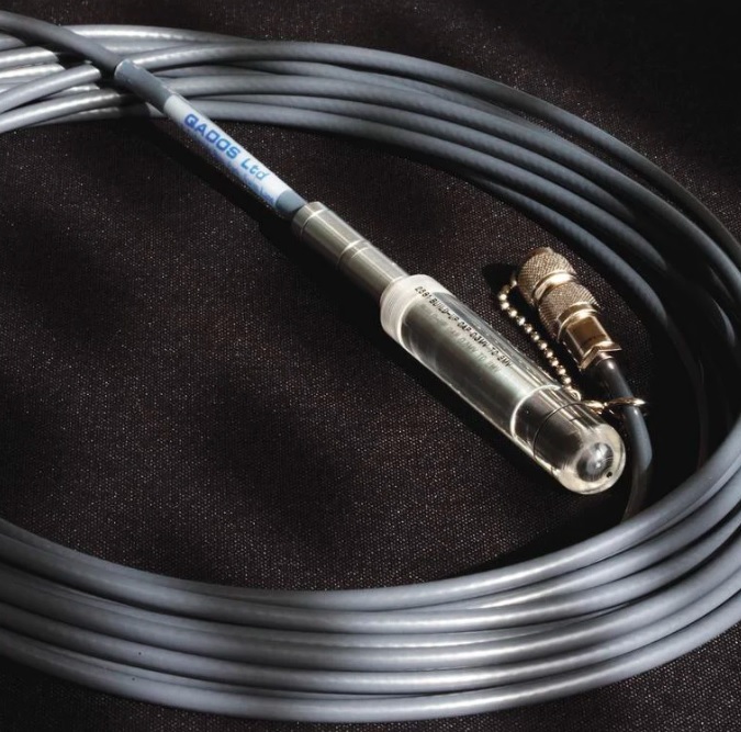

Ionization Chamber
These sensors consist of a gas-filled chamber with two electrodes. One of the electrodes is a positively charged anode, and the other is a negatively charged cathode. The gas in the chamber is ionized when radiation passes through it, producing a small electrical current, which is used to calculate the amount of radiation present.
medical dosimetry ion chamber
Figure 3. A medical dosimetry ion chamber. Image used courtesy of Rotunda Scientific
Ionization chambers are useful tools in medical dosimetry, a field of medicine that manages radiation therapy for cancer patients. They are also used as monitoring tools in nuclear power plants.

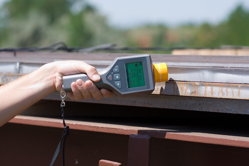

Geiger Counter / Geiger-Muller Counter
These sensors are designed to detect small amounts of radiation. In this case, a gas-filled chamber has an additional central wire electrode and a surrounding cylindrical electrode. When radiation enters the chamber, the ionized gas emits electrons toward the electrodes, which amplifies the signal. The measurement process produces that clicking sound popularized in many movies.
Geiger Muller counter / Geiger Muller counter / Geiger Müller counter / Geiger–Müller counter / Geiger counter
Figure 4. A Geiger-Muller counter. Image used courtesy of Adobe Stock
Geiger-Muller counters are primarily used for environmental radiation monitoring and surveying.
