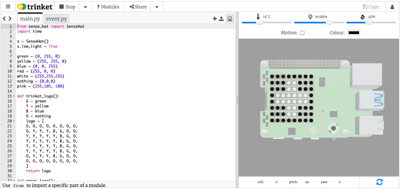

Sense HAT Emulator
If you do not have access to a Raspberry Pi or a Sense HAT, no need to worry! You can still follow along with a Sense HAT emulator created by a partnership with trinket.io and the Raspberry Pi Foundation.
The tool has a scripting window on the left-hand side, with a “main.py” file active. This file is what drives the simulated output on the Sense HAT model on the right-hand side of the window. The right-hand side of the window can also accept inputs to the Sense HAT. There are sliders that can be toggled to change the environment surrounding the virtual Sense HAT. Mirroring the scripting on the physical device will follow the same process as outlined in the ‘Showing a Message’ section of the Sense HAT article.
The sense HAT emulator space
Figure 1. The Sense HAT emulator window. Image used courtesy of Trinket

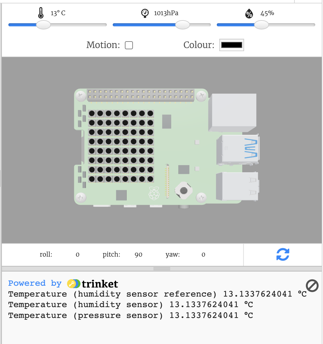

Calling these methods is performed as shown in the below script. You can plug this into the main.py file on the left-hand side of the trinket.io emulator if you are following along. The temperature slider bar on the right will control the current environment and should match the reading of the sensors. It’s important that we create an instance variable called sense that builds a sense HAT object from the SenseHat() class within the sense_hat Python module. This module is maintained by the Raspberry Pi foundation and significantly reduces the programming required.
from sense_hat import SenseHat
sense = SenseHat()
temp = sense.get_temperature()
print("Temperature (humidity sensor reference) %s °C" %(temp))
temp2 = sense.get_temperature_from_humidity()
print("Temperature (humidity sensor) %s °C" %(temp2))
temp3 = sense.get_temperature_from_humidity()
print("Temperature (pressure sensor) %s °C" %(temp3))
The output should appear as below:
Temperature data from emulator
Figure 3. The output of the temperature sensor script in the Trinket emulator. Image used courtesy of Trinket

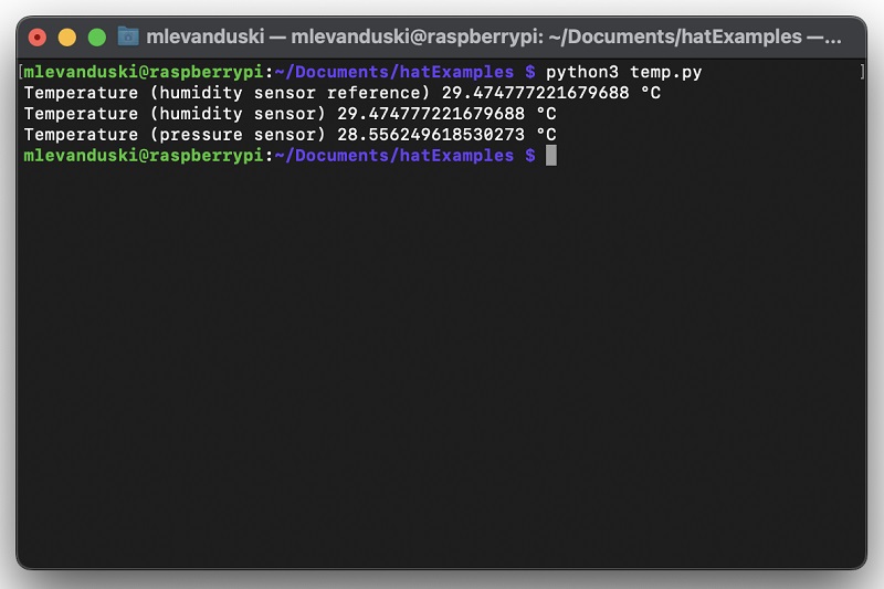

In the simulator, all three temperatures are the same. I’m willing to bet that on the real device, there is some variation. Sure enough, running the same Python code in a file named “temp.py” on the physical system proves that assumption.
Temperature data from real Raspberry Pi system
Figure 4. Real-world temperature data output from two different sensor sources. Image provided by the author
This output shows that, in reality, there is a slight variance between the humidity and pressure sensors’ readouts for temperature. Furthermore, the get_temperature() method yields the same result as the humidity sensor readout, proving it is simply a reference.

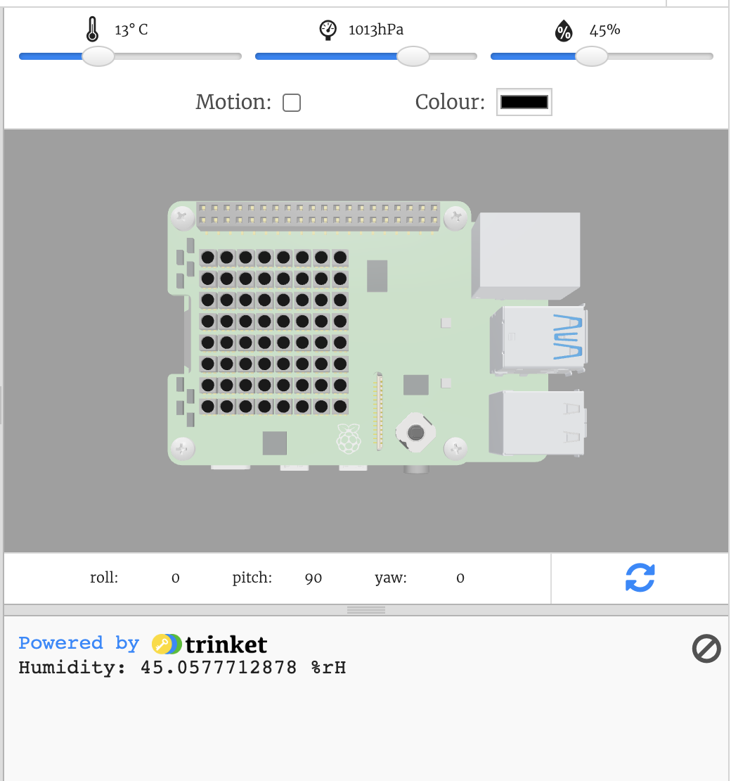

Last but certainly not least is the humidity sensor. As with pressure, there is only one method available that returns the percentage of relative humidity.
sense = SenseHat()
humidity = sense.get_humidity()
print("Humidity: %s %%rH" % humidity)
This code above yields:
Humidity sensor data from eumlator
Figure 6. The output of the humidity sensor script in the Trinket emulator. Image used courtesy of Trinket
