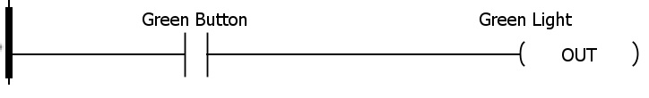

The easiest ladder logic line is a single normally open contact (often called XIC) operating a momentary output coil, as shown in the image below.
open contact XIC operating a momentary output coil
In plain English, this logic would read: ‘If the green button is energized, then energize the green light, but if the green button is NOT energized, the green light should also be de-energized’.

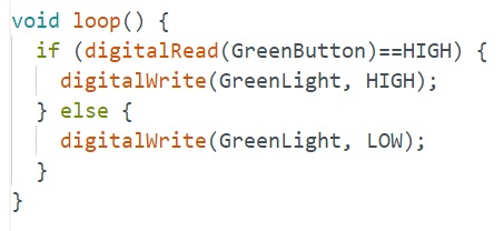

Here is the same program displayed in the Arduino IDE to check your progress inside the void loop() function.
ladder logic statement in Arduino IDE

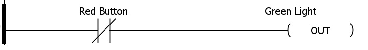

Normally Closed Contact and Output Coil
If the real-world button is normally closed, or if logic dictates that the contact should be used to turn off the load device, there may be a normally closed contact (or XIO) used in place of the XIC. The logic and following Arduino program will look very similar.
normally closed contact (XIO) used in place of XIC
The only difference between XIC and XIO is that the comparison will be true if current is flowing, in the case of the former command, and if current ceases to flow, in the case of the latter command, so we simply compare to a low state instead of a high state.
if (digitalRead(RedButton)==LOW) {
     digitalWrite(GreenLight, HIGH);
} else {
     digitalWrite(GreenLight, LOW);

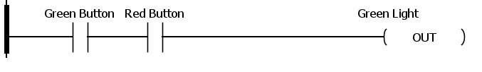

Series Contacts with an Output Coil
In the Arduino IDE, two ampersand (&&) symbols indicate the ‘AND’ comparison. If two input contacts are arranged in series, we say ‘signal 1 AND signal 2 must be energized in order for the load to energize’.
Arduino IDE series contacts with output coil
To create this logic in the Arduino IF structure, we compare both of the contacts independently.
if (digitalRead(GreenButton)==HIGH && digitalRead(RedButton)==HIGH ) {
} else {

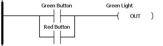

Parallel Contacts with an Output Coil
The next simplest ladder logic structure is the parallel input contacts, where either one signal OR the other must be energized for the load to energize.
simplest ladder logic structure is parallel input contacts
In the Arduino structure, two vertical lines (called pipes, || ) complete the OR comparison.
if (digitalRead(GreenButton)==HIGH || digitalRead(RedButton)==HIGH ) {
} else {

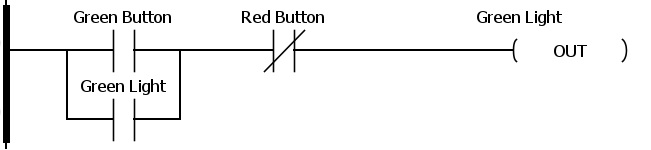

Combinational Logic - the Seal-in Circuit
Perhaps one of the most common examples of combinational series-parallel logic circuit is the ‘latch’ or seal-in circuit, which is very common for motor controls using auxiliary contacts on a contactor or motor starter.
The biggest point of confusion for this logic is the use of the output (green light in our case) as an INPUT condition. In other words, you must both energize the load, but then also check the load to see if it is on or off.
This feedback is the reason for using an auxiliary contact in a real-world version of this common control circuit. For more information about this circuit, see our article about motor control circuits.
The ladder logic appears as below.
auxiliary contact in a real-world control circuit
As long as we are careful to construct the IF statement in the right order, there is no limit to the complexity of a ladder line that can be built. DigitalRead can measure the value of an output or input terminal with ease.
if (( digitalRead(GreenButton)==HIGH || digitalRead(GreenLight)==HIGH ) && digitalRead(RedButton) == LOW) {
} else {

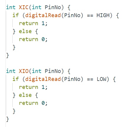

Since a normally open (or XIC) instruction should return either a TRUE or FALSE value when compared, then I would be able to write a function and call it XIC, then within that function, choose to return the TRUE (1) value if energized, and a FALSE (0) value if not energized.
Place this outside of the main void loop() function:
int XIC(int PinNumber) {
if (digitalRead(PinNumber)==HIGH) {
     return 1;
} else {
     return 0;
Now, when we need to use a normally open or XIC instruction, we simply need to write XIC and provide the name of the pin (or ‘tag’) we wish to use. Since the comparison is already done in the subroutine, we only need to call the XIC subroutine to return the TRUE or FALSE comparison value, and so we no longer need to use the '==' comparator.
Immediate simplification!
if (XIC(GreenButton)) {
} else {

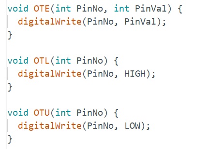

We can do the same for our entire remaining set of XIC, XIO, and for the output OTE, OTL, and OTU like the following:
write the XIC and provide the name of the pin/tag
remaining set of XIC, XIO, and outputs OTE, OTL, and OTU
With these subroutines provided, a few of the previous sample codes can be rewritten to look like the following.
small selection of sample codes

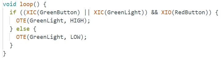

Finally, the combinational latching circuit can be easily built, with the actual screenshot of the code shown below to illustrate how the colors should appear in the current IDE version.

    In the section “Series Contacts with an Output Coil”, GreenButton is being read twice. Shouldn’t it be:
    And in the next section “Parallel Contacts with an Output Coil”, again the GreenButton is being read twice. Shouldn’t it be:
    Like. Reply
    • D
      David Peterson August 04, 2022
      Good catch, thanks - fixed. On second inspection, there was a parenthesis missing on a later code as well. Who is that programmer anyway?...
