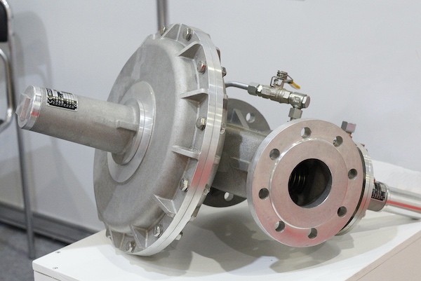

Gas pressure regulator and air pressure regulator
Figure 1. A gas pressure regulator valve.
A pressure regulator is employed in nearly every fluid system to keep the pressure maintained. There is a slight difference between the input to a gas or hydraulic fluid system. Although the physics of liquids and gasses behave similarly, it is best not to let a compressor run continually, as opposed to a liquid pump, so the two systems have a slightly different construction.

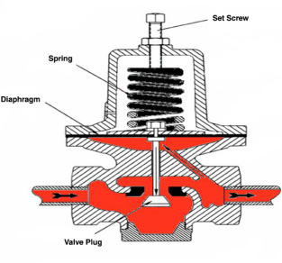

The common construction of a mechanical regulator has two main parts.
The first part is an adjustable spring to create a specific force on the system. This is usually adjustable with a handle or screw element that can be set by the user. Slowly rotating the handle or screw will pre-load the spring to set the required force differently. The force of the spring divided by the valve size results in constant pressure, which is critical to the regulator’s function.
The second part is the valve assembly inside the regulator, a small valve which is usually a type of poppet or butterfly construction. When these valves open, the fluid moves around them. In the case of regulators, the internal valves are not controlled directly by the handle or screw, but rather the spring is an intermediate between the operator and the valve.
How does a pressure regulator work?
Figure 2. A view of the basic parts of a pressure regulator. Image courtesy of Lesman.
When the fluid is introduced into the regulator, it is at high pressure. The spring applies a constant force on the valve which holds it slightly open. The fluid flows through the valve and begins filling the valve’s outlet side, pushing it closed again.
As that valve begins to close, it will quickly reach an equilibrium point. If the outlet pressure increases, it causes the valve to close too much, causing the pressure on the outlet side to suddenly decrease again, and the valve opens again. In this way, the regulator relies on a form of introduced feedback from output to control.
If the spring is tightened, it will hold the internal valve open with a greater force. Therefore, the outlet pressure will need to be higher in order to close the valve and reach equilibrium. This means that in order to increase system pressure, the spring should be tightened. It should be loosened to decrease pressure.
