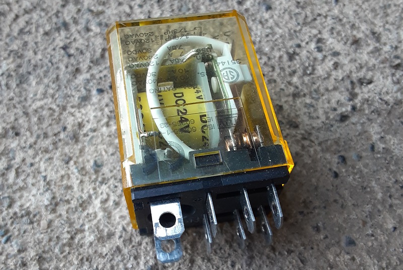

Electrical Relay / Electronic Relay / Ice Cube Relay
Start with the basic electrical (electromechanical) relay. The basic device has a coil of wire which, when a current is passed through, generates a magnetic field and closes another circuit.
These have long since been used for two main purposes: isolation and amplification. The two circuits are electrically isolated, so if the output contact circuit carries a dangerous voltage and current, the operator or controller attached to the coil circuit remains safe. For amplification, the coil circuit is often low voltage and very low current, so the much larger current can safely pass through the robust relay contacts.
In times past, the relay was the primary local control device, forming vast networks of interlocked logical control systems. The PLC has largely replaced this function in modern times.
Close up view of a mechanical relay with PCB mounts
Figure 1. A typical mechanical, or 'ice cube' relay. Image used courtesy of the author

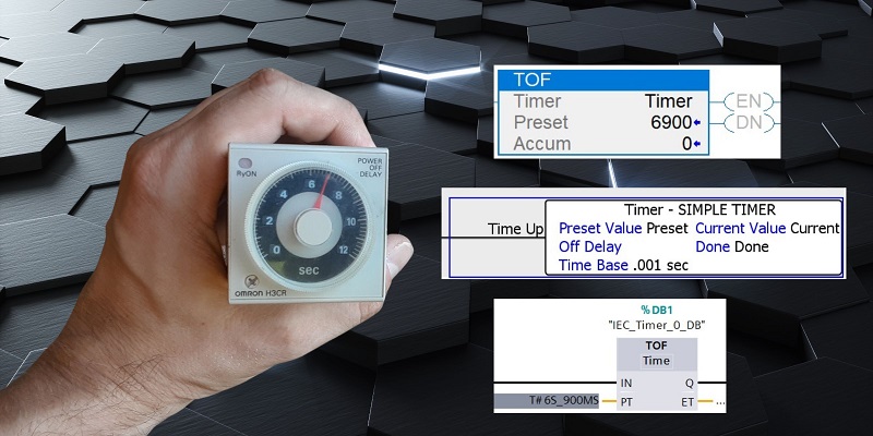

Timer Relay / Time-Delay Relay
Due to the advent of PLCs with built-in timing functionality, the use of timer relays has also diminished, but they still appear in some installations where a PLC is overkill.
The timer relay, designated either as an On-Delay or Off-Delay type, allows the input signal to affect the output, but not immediately. Timers are a great solution for either delaying when a load device turns on, or delaying when the load device turns off.
Comparing relay and PLC timers
Figure 2. Relay timer compared to modern equivalent PLC software timers. Image used courtesy of the author

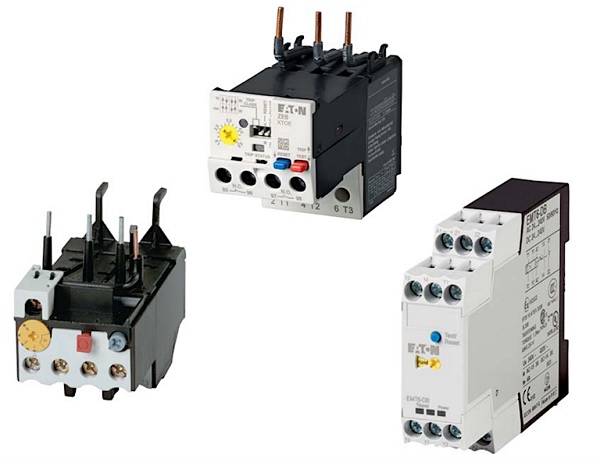

Overload Relay / Thermal Relay
The overload used for protecting large motor systems is one relay that is NOT experiencing a decrease in usage from PLC technology. Perhaps the rise of the inverter (VFD) is responsible for decreasing its popularity, but you are bound to encounter many overload relays.
These can also be called thermal relays, but most overloads (you’ll see them listed as OL on a schematic) contain a combination of magnetic and thermal overload components. The magnetic component opens the circuit instantly in case of heavy excess motor current, (excessive motor inrush current). The thermal component takes a bit longer to react and open the circuit, so it’s used to protect against steady-state current rise (excessive sull-load amps, or FLA).
In fact, since the ‘control’ circuit is a high motor current/voltage, while the ‘contact’ output circuit is a small control voltage, these are actually a step-down amplifier relay! These relays will almost always be found attached to the motor starter contactor, which is actually another kind of special relay described later.
Small selection of overload OL relays
Figure 3. An array of electric overload relays. Image used courtesy of Eaton

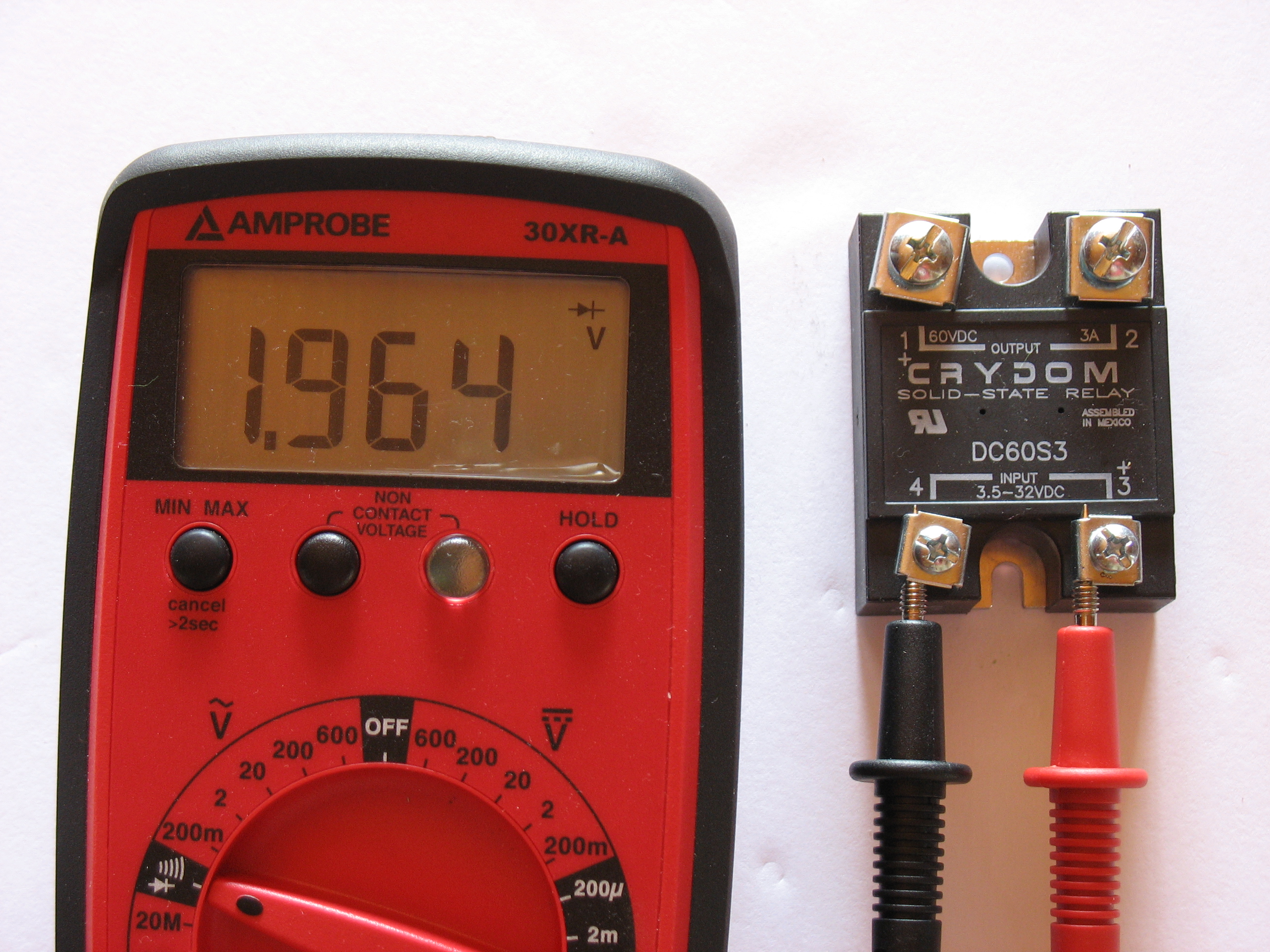

Solid State Relay (SSR)
This relay offers the same purpose as the typical electromechanical relay, but, as the name implies, it does not operate by means of a magnetic attraction of a circuit element. Transistors allow for very rapid switching with a long life, and models can accommodate either AC or DC loads. The input circuit (sometimes still called a ‘coil’ but it’s actually an LED) uses very low power compared to a wire coil.
These must be used with a bit of caution despite the advantages. Solid-state transistors do dissipate some heat when energized, more than mechanical relay contacts, so they often have a lower load current rating, and they will heat up a lot more. Be sure to use proper thermal mitigation.
Solid state relay with a diode test function for coil voltage
Figure 4. Solid-state relays (SSRs) usually require only a couple of volts to energize the input ‘coil’ circuit. Image used courtesy of the author

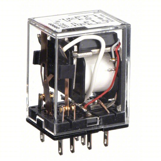

Latching Relay / Interlock Relay / Set-Reset Relay
This kind of relay actually has two definitions.
Most commonly, a ‘latching’ relay is not a kind of relay itself, but rather, a wiring strategy. One of the contacts is connected in parallel with the input device, like a ‘start’ button. When the button is pressed, the contact energizes and latches the relay in the ‘on’ position until a ‘stop’ button is pressed.
Alternatively, there are relays that contain two input coils, one to close the circuit and another to open the circuit. There is no spring return to a normal position. The relay is also used for latching start/stop operations, but since a standard 2-pole (or greater) relay performs this job, and is more cost-effective and more widely available, the 2-coil relay is not very common.
A latching relay, or set-reset relay
Figure 6. A dual-coil latching relay. A close look at the top reveals two small rectangular icons marked with ‘S’ and ‘R’ which indicate the independent set/reset coil sources. Image used courtesy of Grainger

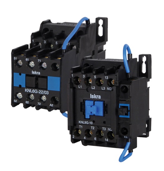

Contactor Relay
Another robust relay that will not disappear anytime soon is the contactor, a main component of the motor starter when connected just before the overload relay (described above).
The contactor has a low-voltage coil, at least, lower than most motor voltages. The coils can be up to 230 VAC, but down to 24 volts like a normal control circuit. Three or four main contacts are all normally open, with one sometimes reserved for a control circuit to verify operation. (PS, do NOT connect the gnd/earth wire to this fourth contact; ground should be a permanent bond).
Contactors can also be outfitted with diodes to prevent flyback, as well as the previously mentioned overloads and additional auxiliary contacts for a highly modular motor-driving thrill ride of a lifetime.
Contactor relays
Figure 7. Contactors are usually larger than their relay counterparts. Image used courtesy of Iskara
