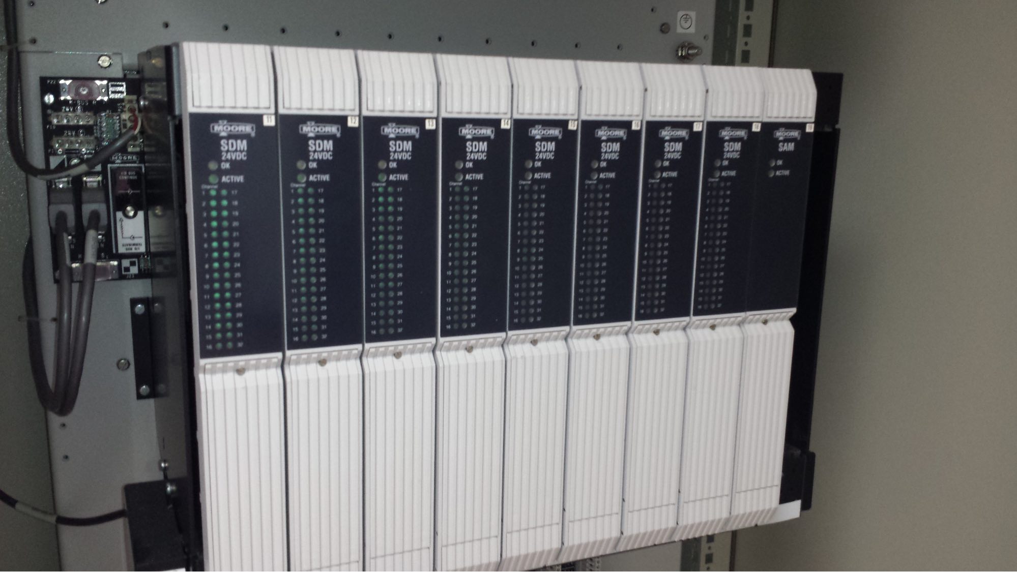

The first option that was considered was to completely remove all the old hardware, including field terminations, and replace it with the new system hardware and terminations. The existing system was generally laid out in such a way that the processors and I/O (input/output) modules along with power supplies were housed in one cabinet while field terminations assemblies were housed in another cabinet. The input/output modules were connected to the field termination assemblies via factory-made cables.

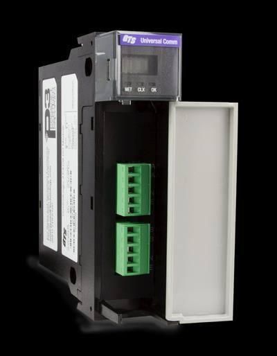

Another option that was considered, was to keep all of the existing I/O modules along with field terminations and install APACS Profibus communication modules in each of the existing I/O chassis. Controllogix processors and chassis would be added with new control logic and Profibus communications modules (being made by Prosoft Technology) would communicate to the existing hardware.
At the time, Prosoft Technology also was developing a Controllogix APACS I/O that would directly interface the existing APACS I/O, but it was not going to be available in time to be included in the control system design so it was never really considered. Either of these methods would have been somewhat more economical than other methods, but eventually, the aging hardware would still need to be replaced in the future. Since the facility had at least another 15 to 20-year life expectancy, it was decided not to use either of these methods.

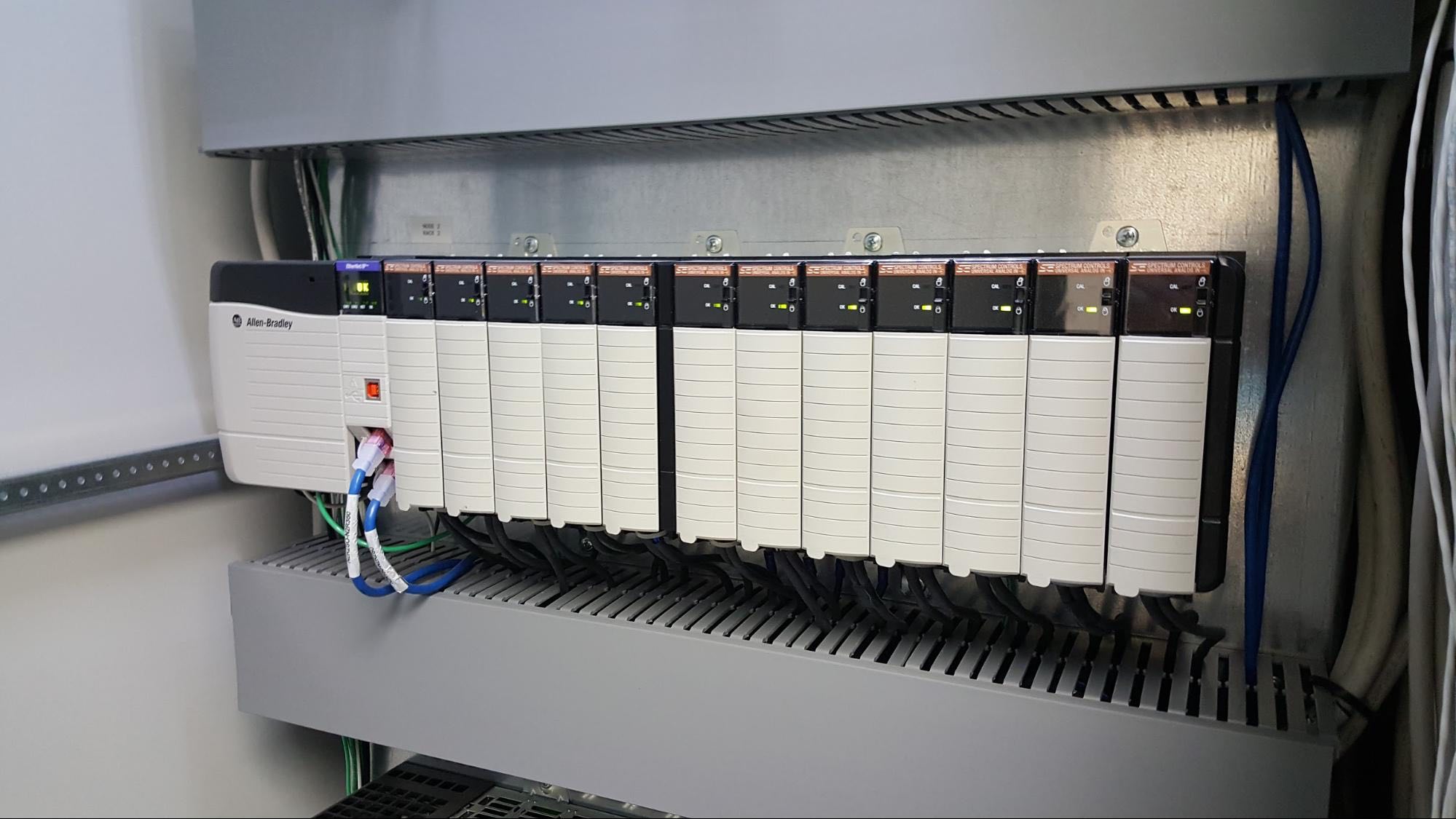

In the end, the method that was chosen was to reuse the existing field terminations and install all new Controllogix processors, power supplies, and I/O modules. The Controllogix I/O modules would interface with the existing field terminations via custom/retrofitted cables that originally interfaced with the APACS I/O modules and Moore Products Marshalled Termination Assemblies (MTAs), which were used for field terminations.

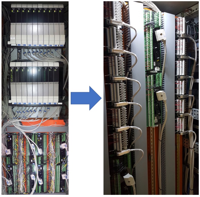

Before and after. Take advantage of the retrofit to clean up some untidy wiring.

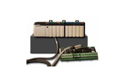

Rockwell Automation actually offers new cables for purchase to interface between the Controllogix I/O and the MTAs, but the facility had an abundance of spare cables available that were custom fabricated by the electrical contractor to interface the new I/O with the existing field termination assemblies. This proved to be a good decision as the contractor did a fantastic job with the cables and provided a much more economical solution.

There were several unforeseen obstacles during the design phase, luckily none were insurmountable. As mentioned previously, the existing system was generally laid out with the I/O modules in one cabinet and the field terminations in another. There was one instance as shown in the photo above where both the I/O modules and the field terminations were mixed. In this instance, the existing field terminations and wiring were a mess.  The opportunity was used to clean up the field wiring and terminations, but some of the field wiring was too short. By simply rearranging some of the field termination assemblies and moving some of the I/O channel assignments, all of the wiring was accommodated.

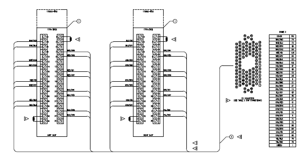

Custom cables were fabricated to connect to the existing termination units.
In almost all cases, the I/O density of the existing system modules and the Controllogix system modules did not match (i.e. 16 channel thermocouple input modules for APACS versus 8 channel thermocouple input modules for Controllogix). The I/O density mismatch was overcome by using the custom cables. For example, one cable would interface two thermocouples I/O modules with one existing thermocouple field termination assembly. The only I/O module type on the new system that did not have a direct interface option with the existing field termination assemblies was the analog current input module.

The new clean look of a recently installed system.
APACS also had the ability to change input channels to output channels on most modules. Fortunately, there were not many instances where the inputs and outputs were mixed on the same module. For the few cases where they were mixed, the inputs or output channels were just reassigned to a different module in the new system.
