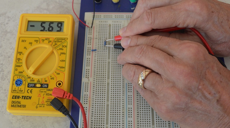

Figure 1. Measuring ohms with a multimeter. The negative reading is explained below. Image provided by author
Sometimes something goes wrong—the reading makes no sense. This article was prompted by a forum discussion of negative resistance readings. That’s not the only possible problem—there are others. Let’s dive into them.

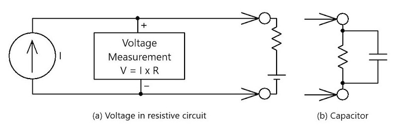

Cause: Assuming your meter is ok, this almost certainly is due to a voltage or power supply in the circuit you’re measuring. The negative reading shown in Figure 1 was made by adding a battery to the circuit. This changes the resistor’s current: it no longer is simply I x R. The meter measures a higher voltage than the fixed current supply should have allowed, which would be impossible unless the resistor was adding current, rather than decreasing it. The reading will be wrong. Figure 3(a) shows a simple example, a battery connected in series with the resistor.
Active voltage sources in circuit
Figure 3. Active voltage sources in the circuit will cause wrong readings. Sometimes a charged capacitor can be the culprit.
Figure 3(b) has a charged capacitor, no battery. In this case the capacitor’s charge probably will change when the meter is connected: the reading will drift. If you wait a while, the capacitor charge will stabilize, the drifting will stop, and the reading should be correct.
Voltages in the circuit can cause problems other than negative readings. Reversing the DC voltage will make it read positive but too high, maybe off scale. If the voltage is AC, who knows?
Diagnosis: Change the meter to read voltage. It should be zero. If not, there is an unwanted voltage somewhere.
Cure: Always make sure all power and voltage sources are disconnected and capacitors, if any, are discharged. See below for more about capacitors.
