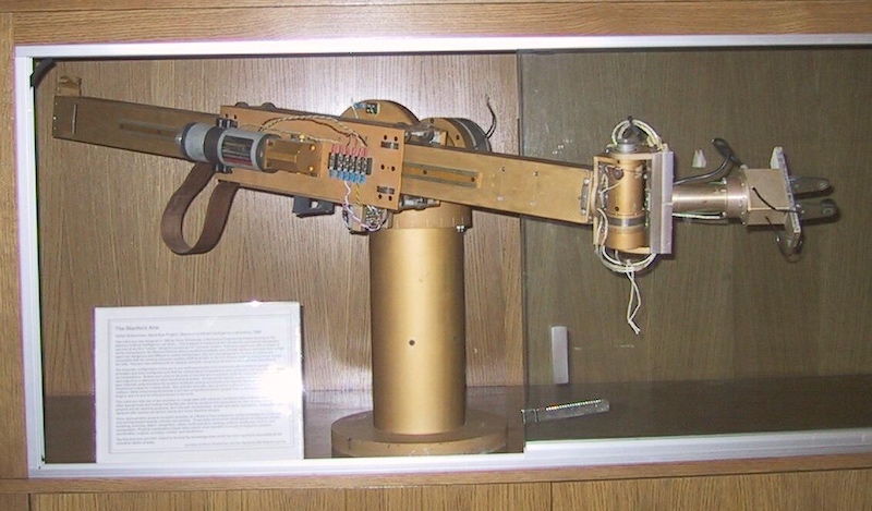

Donald L. Pieper invented the 321 kinematic chain. It is used in most robotic arms with high Degrees of Freedom (DoF) and is made of intersecting revolute joints.
The Stanford arm was one of the first models of this design. It had six degrees of freedom from two revolute joints, a prismatic joint and a spherical joint. Most robotic arms used in industry are advanced iterations of the Stanford arm.
The Stanford arm. Image used courtesy of Stanford University

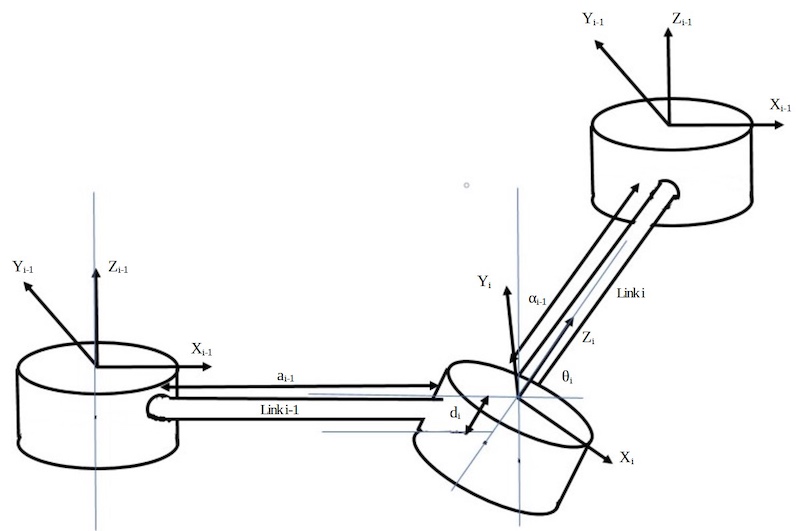

In any kinematic chain, from the base of the robotic arm, different links are serially connected with revolute links or prismatic joints. The end effector or tooltip is attached at the end of the last link. Forward kinematics can calculate the position and orientation of the end effector with joint variables.
Figure 1: Representative image of kinematic chain showing Denavit Hartenberg parameters and reference frames. Information used courtesy of S. Kucuk and Z. Bingul
The Denavit-Hartenberg method is the commonly used method for the forward kinematics model. It uses four parameters at each axis to define a system. They are:
  • ai-1 representing the link length
  • αi-1 denotes the link twist
  • di stands for link offset
  • θi for the joint angle
Denavit-Hartenberg’s model is used when there are multiple reference frames in a system. Different reference frames can be placed at each joint. Zi is pointing in the direction of rotation at the joints or the direction in which the joint slides to and from. Denavit-Hartenberg parameters are decided after the axes of coordinate frames are determined at each joint.
Suppose coordinate frames and DH parameters are clearly marked. The link length ai-1 is measured as the length between the axes Zi and Zi-1 along the Xi-1 axis. αi-1 is the angle between the same two Z axes measured along the Xi axis.
di is the distance between Xi-1 and Xi measured along the Zi axis, and θi is the angle between Xi-1 and Xi. The general Transformation matrix Tii-1 for a link can be written as follows.
Tii-1=Rx(ai-1) Dx(ai-1)Rzi)Qi(di)
Similarly, the transformation matrix for the reference frames at each joint can be calculated, TT01, T12,... The transformation matrix of the end effector in relation to the base can be calculated by multiplying the transformation matrix at each joint.
Tbaseend-effector =  T01T12...Tn-1n
This transformation matrix will give px, py, and pz, the position coordinates of the end-effector.

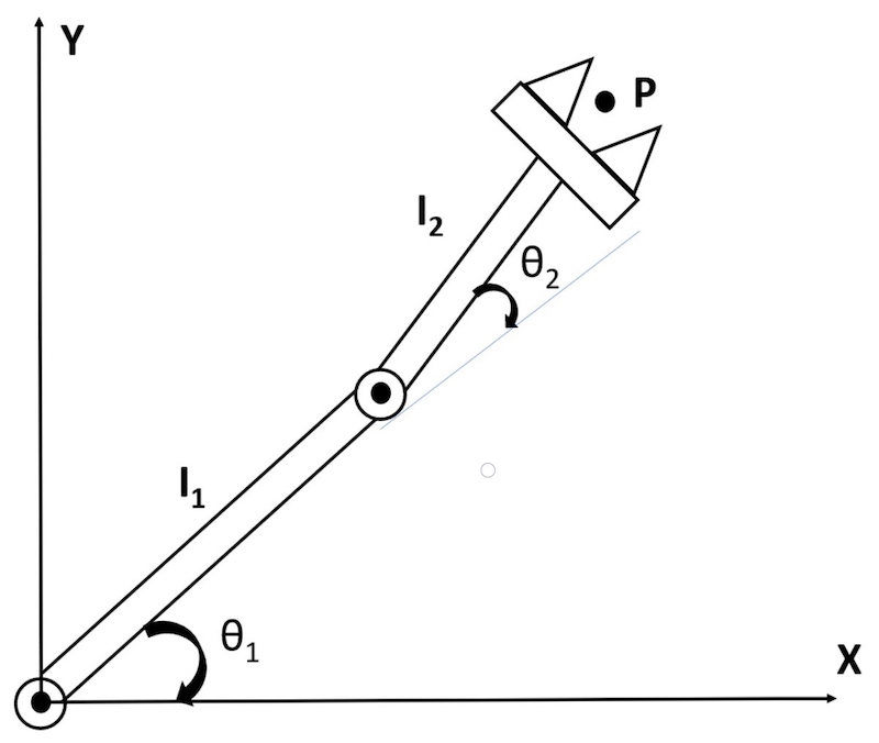

Geometric Solution Approach
In this method, the joint space is divided into multiple two-dimensional planes and trigonometrically finding solutions in each plane.
Figure 2: For example, consider a manipulator with two degrees of freedom. Information used courtesy of S. Kucuk and Z. Bingul

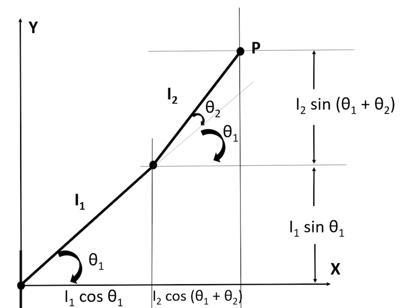

This can be simplified to a simple geometric problem, as shown below.
Figure 3: Now, simple geometry can be applied to calculate the parameters. Information used courtesy of S. Kucuk and Z. Bingul
However, it gets far too complex and time-consuming to calculate when robotic arms with higher degrees of freedoms are involved.
In some robotic arms, the manipulator only operates in two dimensions. In other robotic arms, it operates in three-dimensional space. Keeping track of the different two-dimensional planes with respect to each other becomes tedious with a higher number of joints.

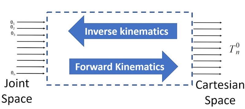

For a kinematic chain, forward kinematics is to calculate the end-effector position in relation to the base. The Denavit-Hartenberg parameters are used for mathematical calculations as it has variables to represent rotational and translational parameters.
The transformation matrix for each joint can be individually calculated and multiplied to obtain the Tend-effectorbase. This final matrix gives the position coordinates of the end effector.
Figure 4: Inverse kinematics is used to find the joint space parameters when Cartesian parameters are known. This is essential to manipulate the end effect by inducing different movements to the different joints.
In simple terms, forward kinematics is used to convert variables in joint space (Denavit-Hartenberg parameters) to Cartesian coordinates, and inverse kinematics is used for the reverse operation.
