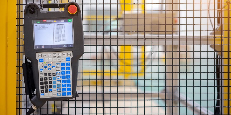

Fault light on FANUC teach pendant
Figure 4. A FANUC robot controller indicates the presence of a fault visually. This is helpful, although faults can originate from other sources than just collisions alone. Image used courtesy of Canva
