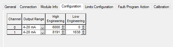

Since the OE2C has an output resolution of only 13 bits, the engineering range default isn’t quite as high as we saw for the input module. By default, sending 8191 (which is just below 2^13) to the Ch2Data tag will produce 20 mA, while sending 1638 will produce 4 mA.
But if 8191 is meant to drive the motor at 60 Hz, this is not immediately clear to most end users. Therefore, it might make more sense to scale the engineering value such that 6000 corresponds to 20 mA (which is 60 Hz) and 0 corresponds to 4 mA (0 Hz).
 scale the engineering value such that 6000 corresponds to 20 mA (which is 60 Hz) and 0 corresponds to 4 milliamps (0 Hz)
We could determine that the High Engineering could be 60, and therefore we are directly driving the motor frequency, however, this is such a low value that it would impossible to drive in fractions of Hz. Therefore 6000 = 60 Hz and the programmer can procesely drive the motor in increments of 1/100 Hz per count.

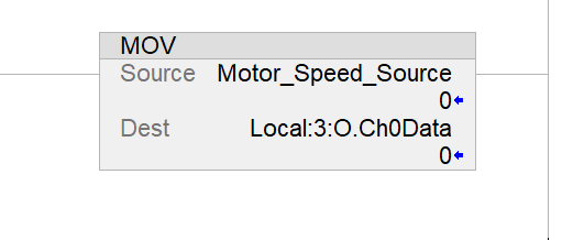

Sending Values to Analog Outputs
Once again, instructions with INT destinations are ideal for driving analog outputs. Such commands might include the DEST tag of math commands, as previously, or a MOV command, which is quite common.
instructions with INT destinations are ideal for driving analog outputs. Such commands might include the DEST tag of math commands or a MOV command
