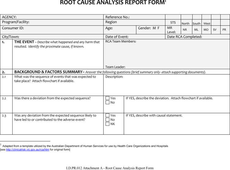

An example of a root cause analysis form. Image courtesy of Microsoft
The team should consist of several people, including the department or section in which the problem occurred. The team should have in-depth knowledge of specific industry standards as well. One of the team members should be leading the RCA. This person is responsible for implementing the agreed-upon solution.
