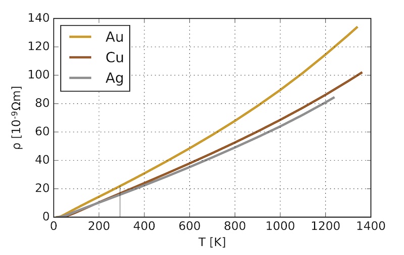

In most materials, the electrical resistance increases as the temperature increases. This makes sense when considering Brownian motion; the higher the temperature, the faster the atoms vibrate, the harder it is to pass an electron through this lattice of vibrating atoms.
Figure 1. The resistance of gold, copper, and silver as a function of temperature. These metals are mostly linear, with only a slight curvature over this temperature range. Image used courtesy of Geek3
RTDs take advantage of this motion. Their operating range covers the linear region of this change, where the resistance varies linearly with temperature. Temperatures outside of this linear region, phase changes, magnetic property changes, and other phenomena can make the resistance hard to predict.

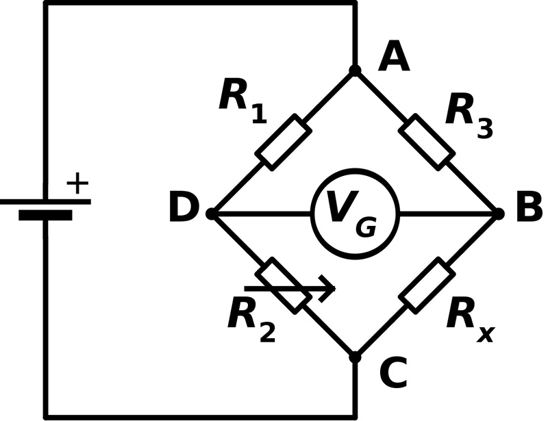

Measuring small resistance changes is difficult and is not typically performed directly. Instead, a Wheatstone bridge circuit is used to measure a small voltage change, which corresponds to a small resistance change, which corresponds to the temperature change. The addition of this Wheatstone bridge circuit requires some additional hardware that must be included in the measurement system.
Figure 2. Wheatstone bridge schematic. The values of R1, R2, and R3 are known, and Rx is the RTD. As the resistance of Rx changes, the voltage measured at VG changes, and VG is used to calculate the temperature. Image used courtesy of Rhdv

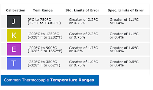

Figure 3. A snippet from a thermocouple chart, with type J, K, E, and T thermocouples. Image used courtesy of OMEGA
Depending on the types of metals used, the thermocouple will have different properties and applications. The types are specified by letter, which lists the wire colors, temperature ranges, environments, and other information about where each thermocouple can be used. Thermocouple manufacturers provide a chart of the different types.

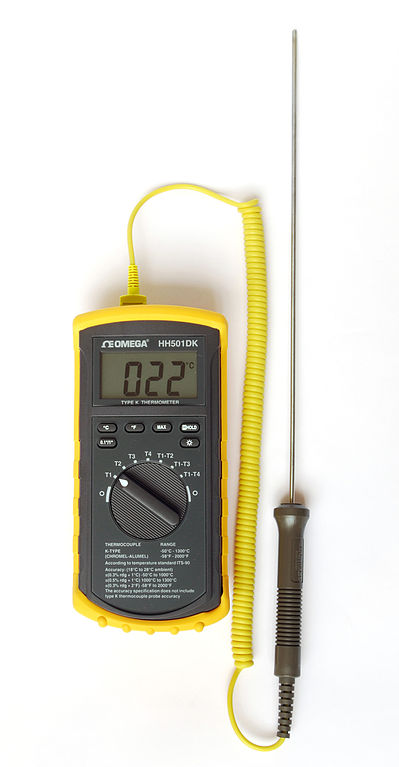

Thermocouples are a quick way to measure temperature. Standalone thermocouple meters are typically inexpensive, meaning experiments can be conducted quickly with thermocouples. Thermocouples with standard connectors can be embedded in a piece of equipment, and a technician with one meter can rapidly check temperatures in multiple places.
Figure 4. A thermocouple probe and reader. Image used courtesy of Harke
