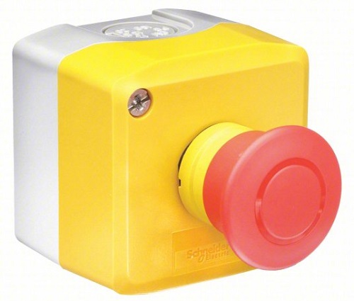

Emergency stop (e-stop) button
Figure 2. Emergency stop (e-stop) button. Image courtesy of Schneider Electric
Emergency Stop Button (E-Stop)
The e-stop is likely the most common safety device, and it is typically the first safety device added to a system. An e-stop push button typically has two normally closed contacts and one normally open contact for monitoring and is colored bright red with a yellow label. The purpose of the e-stop is to stop and de-energize all sources of motion or hazards within the system. For pneumatics, stored pressure will be vented to the atmosphere and STO signals will be off for any motion devices.
There are a few different ways to make use of an e-stop button, and one common way is with a safety relay. The safety relay will have two monitor circuits which pass through the dual contacts on the e-stop button. When the button is pressed, the contacts will open. This causes a break in the redundant safety circuits, triggering the safety relay to open its contacts.
Another way to monitor the state of the push button is with a safety PLC or safety controller using special safety inputs. The PLC will need to be programmed to open output contacts when the push button is pressed. If the system is very simple you might see the control voltage for contactors or STO signals passed through the e-stop contacts.
An e-stop button is a very inexpensive way to easily stop and de-energize any hazards within a system. They can be integrated into very simple or complex safety systems without much hassle. If it is determined that your system contains hazards or poses a safety risk to operators, then an e-stop should be implemented.

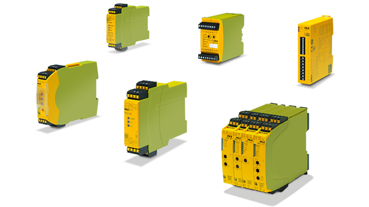

Safety relays
Figure 4. Safety relays. Image used courtesy of Pilz
Safety Relay
A safety relay is similar to a typical relay only a safety relay will have internal logic and error checking. Along with contacts, the safety relay will typically also have a dual-channel monitor circuit which determines if the system is safe. The safety relay may also have a reset input to allow a controllable reset.
If you have determined that your system will require safety inputs, such as a light curtain, e-stop button, or palm buttons to control the equipment then a safety relay will be required to monitor those safety devices and to safely stop the hazardous devices.
The monitor circuit on a safety relay needs to be complete in order for the system to be determined as safe. This requires the monitor circuit to be wired through the normally closed contacts on each input device. Some safety relays will have dual monitor circuits, and both of those circuits will need to close and open with a very short time difference.
A safety relay has internal logic that ensures the dual monitor circuits are separate and they function together. This internal logic can also detect faults within the safety devices themselves. If one of the dual contacts is not functioning, that would cause a fault resulting in opening the safety contacts.

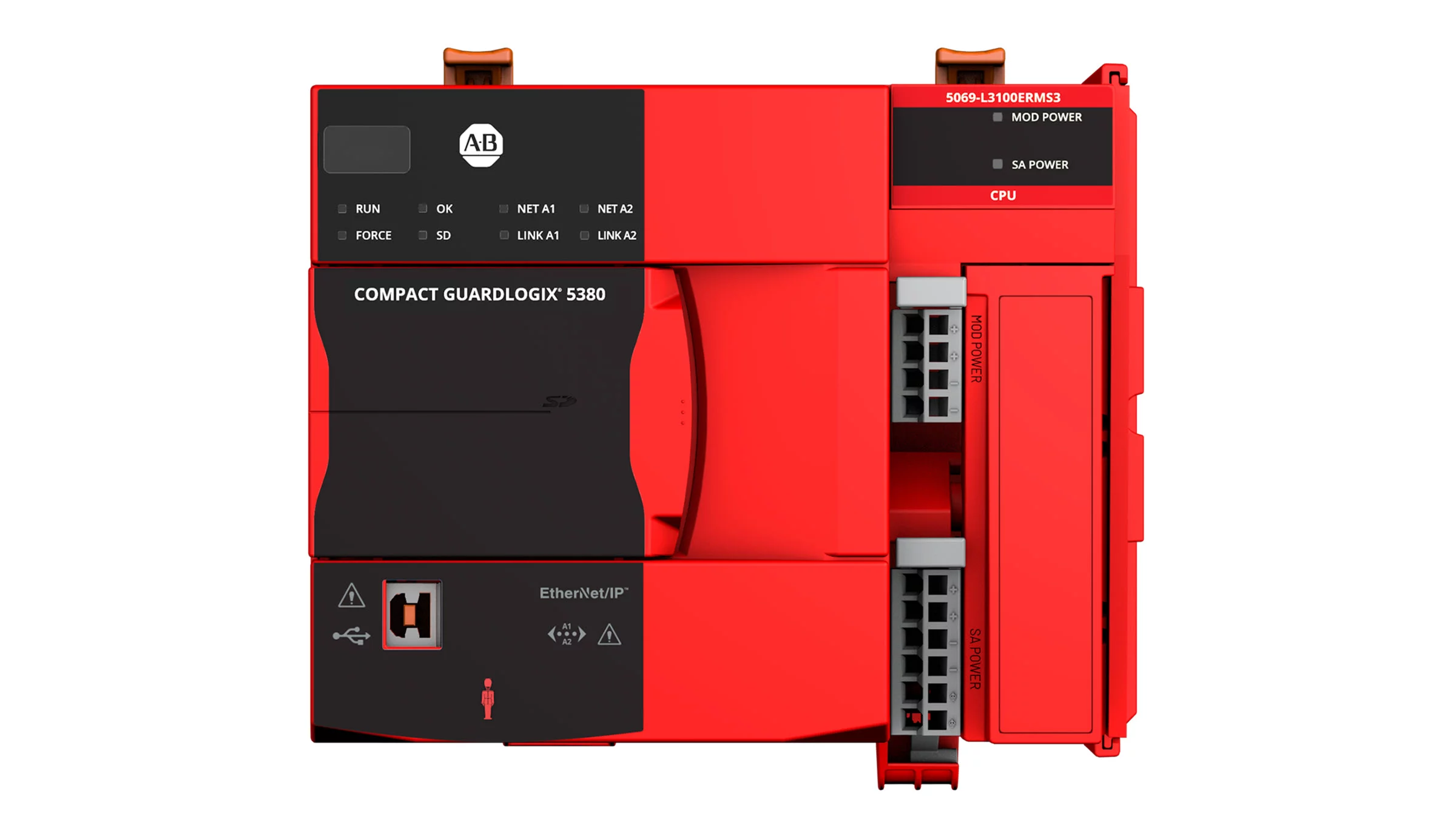

Safety PLC / Safety Controller
A safety PLC uses safe inputs and allows a user to develop safety programs that set safety outputs at appropriate times. When a safety system becomes complicated or requires multiple safety relays, it is best to use a safety PLC. Each of the safety inputs has the same if not more error checking and diagnostic as a safety relay, and the outputs will sometimes have a similar error checking.
Some safety PLCs will use function block diagrams to develop simple logic cases to set or reset outputs, and some PLCs will use standard ladder logic and special function blocks to handle the inputs and outputs. Variables within a safety program are considered safe, if non-safe variables are required they will need to be mapped.
Safety PLCs are becoming more affordable and are very flexible. The I/O can be expanded and a variety of safety input devices and output devices can be used with a safety PLC.
