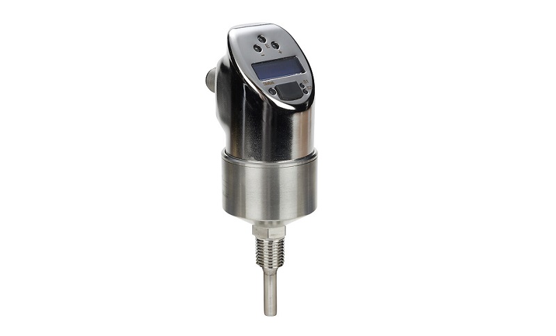

Temp sensor
Figure 1. Analog output (4-20 mA) temperature sensor. Image used courtesy of Automation Direct
Most functions involve linear scaling, often following the slope-intercept equation form y=mx+b. There are other less common nonlinear scaling functions that are capable of creating values to fit nonlinear applications. In order to better understand the application of nonlinear functions, this article will first give a brief overview of linear scaling before looking into the application and functionality of nonlinear value scaling.

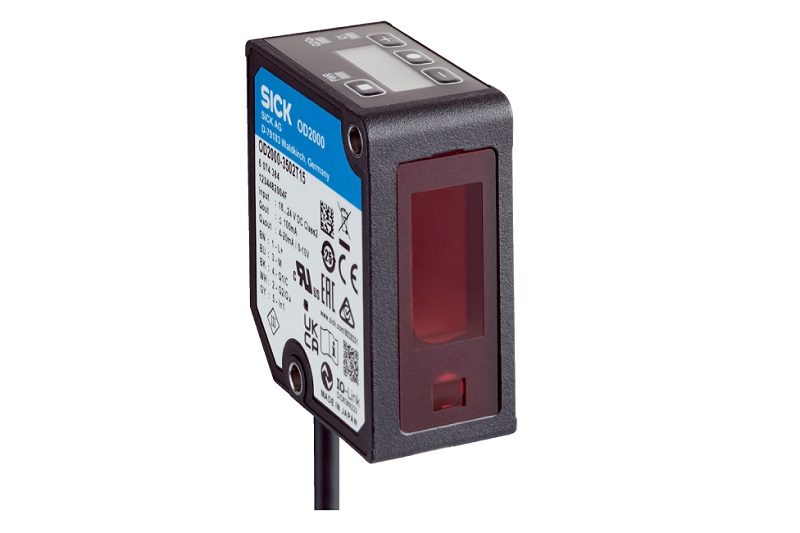

Distance Sensor
Figure 2. Analog output (voltage/current) laser distance sensor. Image used courtesy of SICK
If the sensor outputs 4 mA when the tank is full, a value can be assigned in the program that reflects this information. When the tank is empty the sensor will output a value that is higher than 4 mA since the laser will be reflecting from farther away. If the output value of an empty tank happens to be 10 mA, this output value can be assigned to show the tank is empty. With the high and low values assigned, the control program can now scale the values appropriately when it receives a signal anywhere within that range. If 7 mA is output from the sensor, the PLC will calculate a value that shows the tank is now half full.

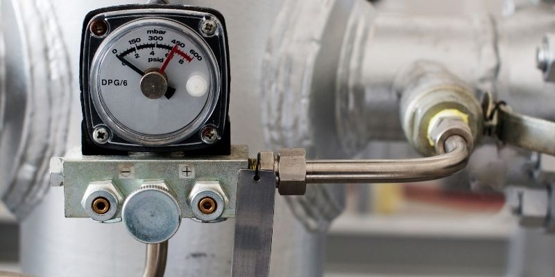

Pressure Sensor
Figure 3. Analog output (4-20 mA) pressure sensor. Image used courtesy of ifm
In order to output the volume of the tank correctly, PLC/robot will have to scale the values nonlinearly. Since the shape of the tank is conical, a deceptive liquid height of ½ full does not produce a volume equal to ½ full as in the cylindrical example. PLCs often have a nonlinear scale block that can be added into the ladder logic which will accept many input and comparable output values to create a mathematical function that is more accurate for all values between minimum and maximum. This block gives PLCs the same benefits as high-level textual programming for mathematical operations.

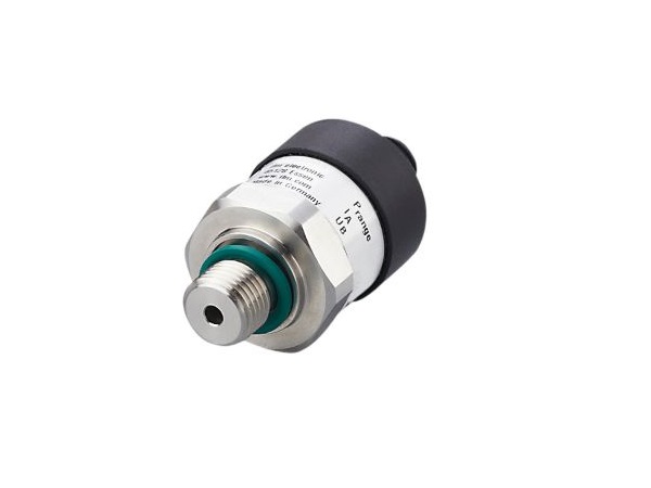

Analog gauges
Figure 4. Analog values can be shown on gauges but must be scaled when converted to digital quantities. Image used courtesy of Canva
If those three values were to be graphed using a linear scale, they would be so far apart that they would not fit together well on the screen and the operator would have a difficult time gaining the correct information. The value of 100 would appear to be way at the very bottom of the screen. By scaling the input values using log base 10, the values can then be graphed in a much more manageable way. With a base-10 log, the values of this production test become 2,4, and 6 respectively. These values are much closer together and are able to relay the appropriate information to the operator. PLCs and written code can be used to scale values logarithmically using the same methods described earlier, but using a logarithmic function instead.
