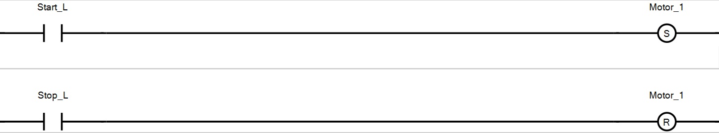

Latching Commands
In pretty much every PLC program, there are latching coils; these coils will set a variable (like an output) to become true when the rung is true, but then remain true even after the rung becomes false. An unlatch coil attached to the same variable will have the reverse logic, it will force the variable to become false as soon as the rung is true.
From a programming sense, it might be easier to think of a latching coil as assigning a value to a variable. When the latching coil is true, the variable is set equal to 1. Then, when the unlatching coil is true, the variable is set equal to 0.
For this reason, they are called latch and unlatch, but it is also very common to see ‘set’ and ‘reset’ which mean exactly the same thing.
Set/Reset ladder logic
Figure 2. An example of input commands being used to either latch (set) or unlatch (reset) a variable. Image used courtesy of the author
This style of programming allows variables to be set true in one routine and false in other routines, and can greatly reduce the amount of visual space the code takes up on the screen. It also allows for entirely different complex conditions to unlatch the variable vs the conditions required to latch the variable.

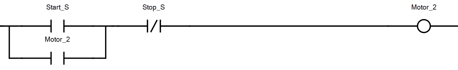

Seal-In Logic Structure
The ‘seal-in’ logic is often used for initializing a process, such as turning on motors with a momentary start and then later ending with a similar momentary stop push button.
The logic works by branching around the input condition(s) using the same variable as the output coil. The stop button, or stop conditions, are then placed in series before or after the branch in a normally closed state.
When the output goes true, the input conditions are said to be “sealed in” since the start command can be removed, but power will still flow to the output. When the stop conditions are met (contact becomes open), the output turns off and the seal is broken.
Seal-in logic for a circuit
Figure 3. Seal-in logic. Image used courtesy of the author
The benefit of this logic is that both the start and stop conditions are kept in one place, making it great for starting a process like a fan motor or starting a robot task.
The downside occurs if you have a lot of start or stop conditions, the series of commands and parallel branches of the rung can get unruly and difficult to read, usually expanding it to two rows on the screen.
Also, when using momentary coils, it is difficult to have multiple stop conditions or multiple start conditions for the same output. Additional handshake bits are required if you want to break the seal from other parts of the program. If not, you can end up with conflicting bit references and inconsistent machine operation.

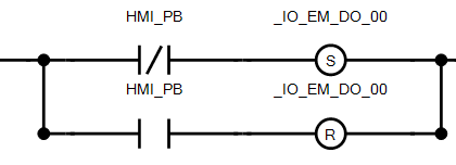

Incorrect latch and unlatch circuit logic
Figure 4. If this is a normally open button, this latching logic will create an ‘always-on’ condition. Image used courtesy of the author
The logic example shown above is a simple erroneous case of an output that would only turn off (reset) when the N.O. button is pressed. As soon as the operator releases the button, the output will turn back on (set). If that output is a fan, it will never turn off.

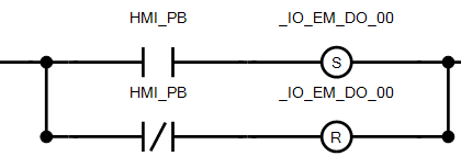

The logic may have been intended to look like the image below. When the N.O. button is pressed, the output turns on (set). Then when released, it turns off (reset). A simple mistake of a normally closed vs open can result in output being on all the time.
Correct latch and unlatch conditions in a circuit
Figure 5. Proper latch/unlatch logic for a normally open button. Image used courtesy of the author

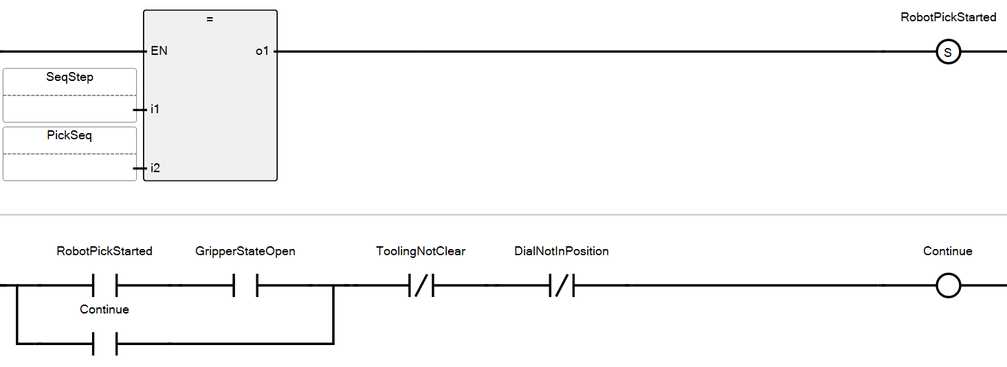

I typically use latching logic when I want to handshake to another piece of code or another task, such as setting expected bits from a sequence. Instead of having complex code or calculations in my sequence, I’ll simply latch a bit from the sequence and then unlatch it when the calculation code is complete. The same is true with devices like cameras. I might latch a trigger bit in the sequence and then unlatch when the camera is done.
I often use seal-in logic when commanding motion devices such as servos or robots, this way I can add conditions where I might want to stop the motion before the end of the command. If I’m commanding a servo to move a linear actuator but some other tooling moves when it shouldn’t I can use a seal-in condition to issue the stop. HMI and physical push buttons often use seal-in conditions when you have a single function button like start and stop.
Uses for latching versus seal in logic
Figure 6. Comparing scenarios for latching (set) logic versus seal-in logic. Image used courtesy of the author
