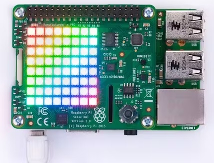

It is a simple Internet of Things starter for the Raspberry Pi offered for a low cost of around 30 USD at the time of this writing. The most notable visual feature at first glance is the 8x8 RGB matrix.
Raspberry Pi Sense HAT with the RGB LEDs
Figure 1. The 8x8 RGB matrix of the Sense HAT. The HAT is stacked on a Raspberry Pi using the GPIO header. Image used courtesy of Raspberry Pi

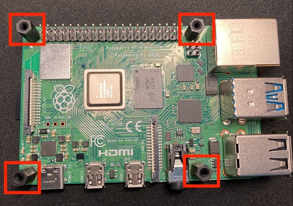

After covering that basic setup, install the 4 provided posts to the Raspberry Pi indicated by the red boxes below:
Adding the mounting posts for the Raspberry Pi HAT
Figure 2. The four posts have been added to the Pi. Image provided by the author

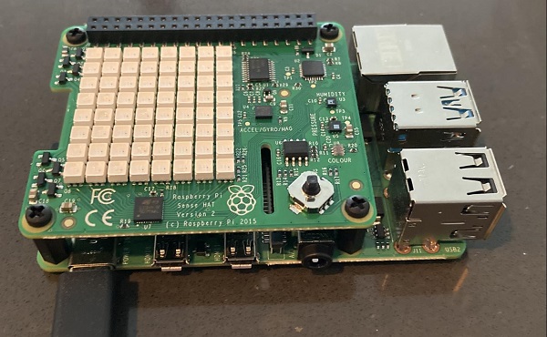

The Sense HAT should then be connected firmly (but squarely) straight down onto the GPIO pins and screwed lightly in place to the added posts with provided screws. The completed unit should appear as below:
Raspberry Pi with Sense HAT on top
Figure 3. The HAT is attached to the Pi and secured by the Phillips-head screws included. Image provided by the author

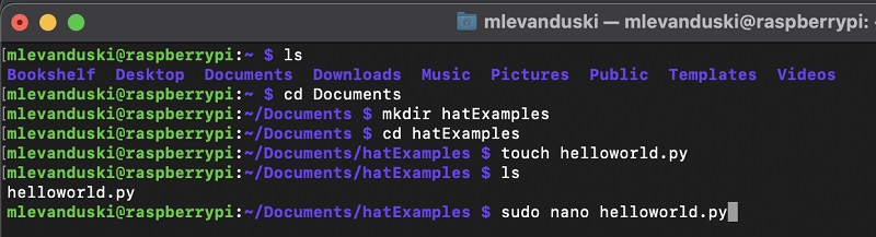

Access terminal or powershell on your local PC and connect to the Sense HAT. This process also is covered in the previous Raspberry Pi Setup article. Once connected to the Pi, follow the series of commands below. Please do not worry if the Linux commands are foreign. We are creating a new directory (mkdir) and adding an empty python file (touch) to house the example code as shown below.
Creating a new file in Python

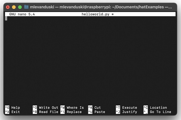

The last command line prompt will open a text editor called Nano upon being executed. The editor environment will be initialized below:
Terminal window for the Raspberry Pi
Now we will copy and paste the boilerplate hello world code in the nano editor window, which will cause scrolling text to appear on the RGB LED matrix on the top of the HAT:
Hello World code for the Sense HAT
Saving the file is a 3-step process:
  • Ctrl + x to exit
  • Enter “y” to save changes
  • Hit the enter/return key
