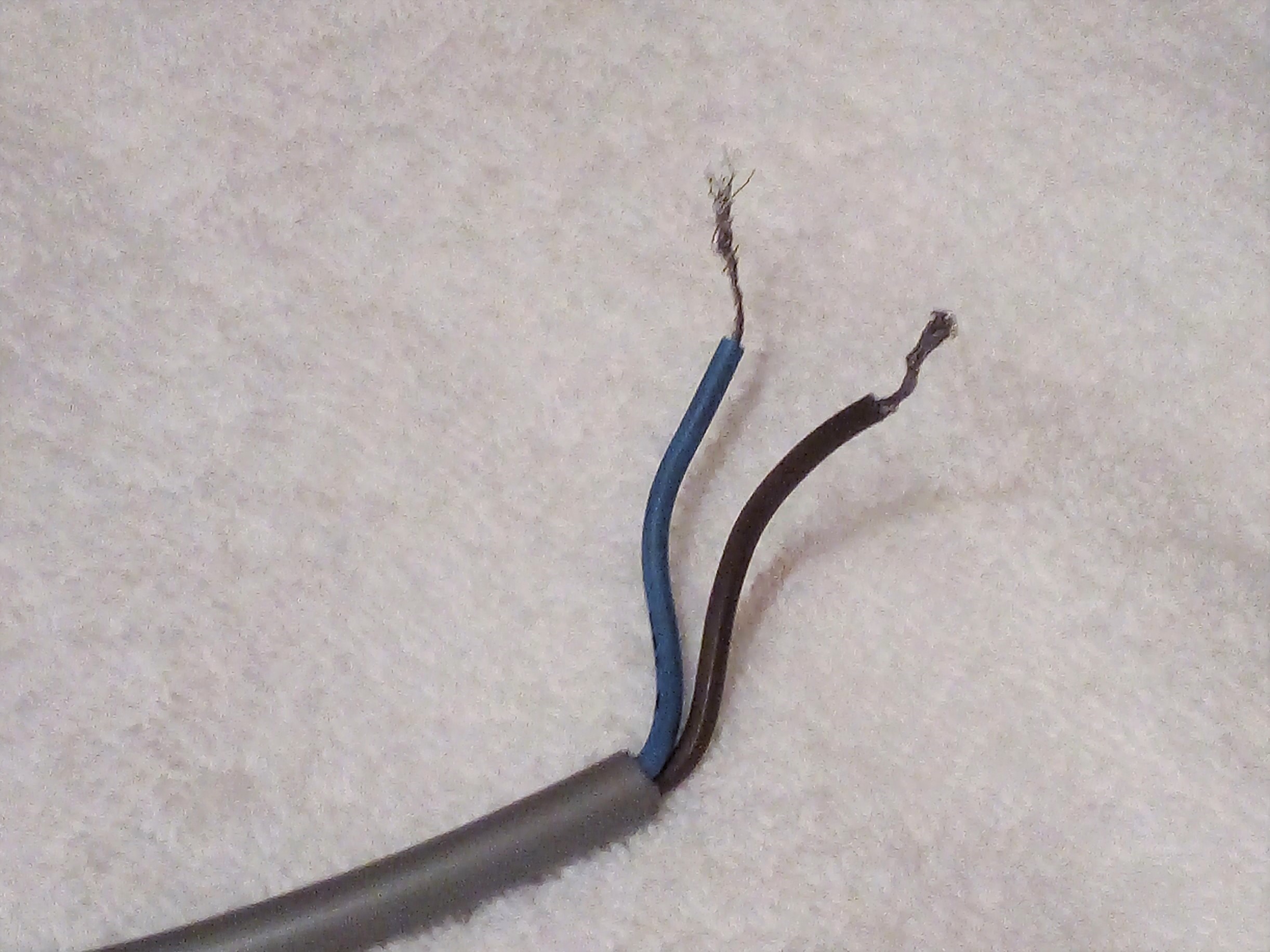

the end of a wire harness for a 2-wire sensor
The end of a wire harness for a 2-wire sensor. Although this is an AC powered inductive proximity sensor, a DC sensor may often have the exact same brown and blue wires.
2-Wire Sensors

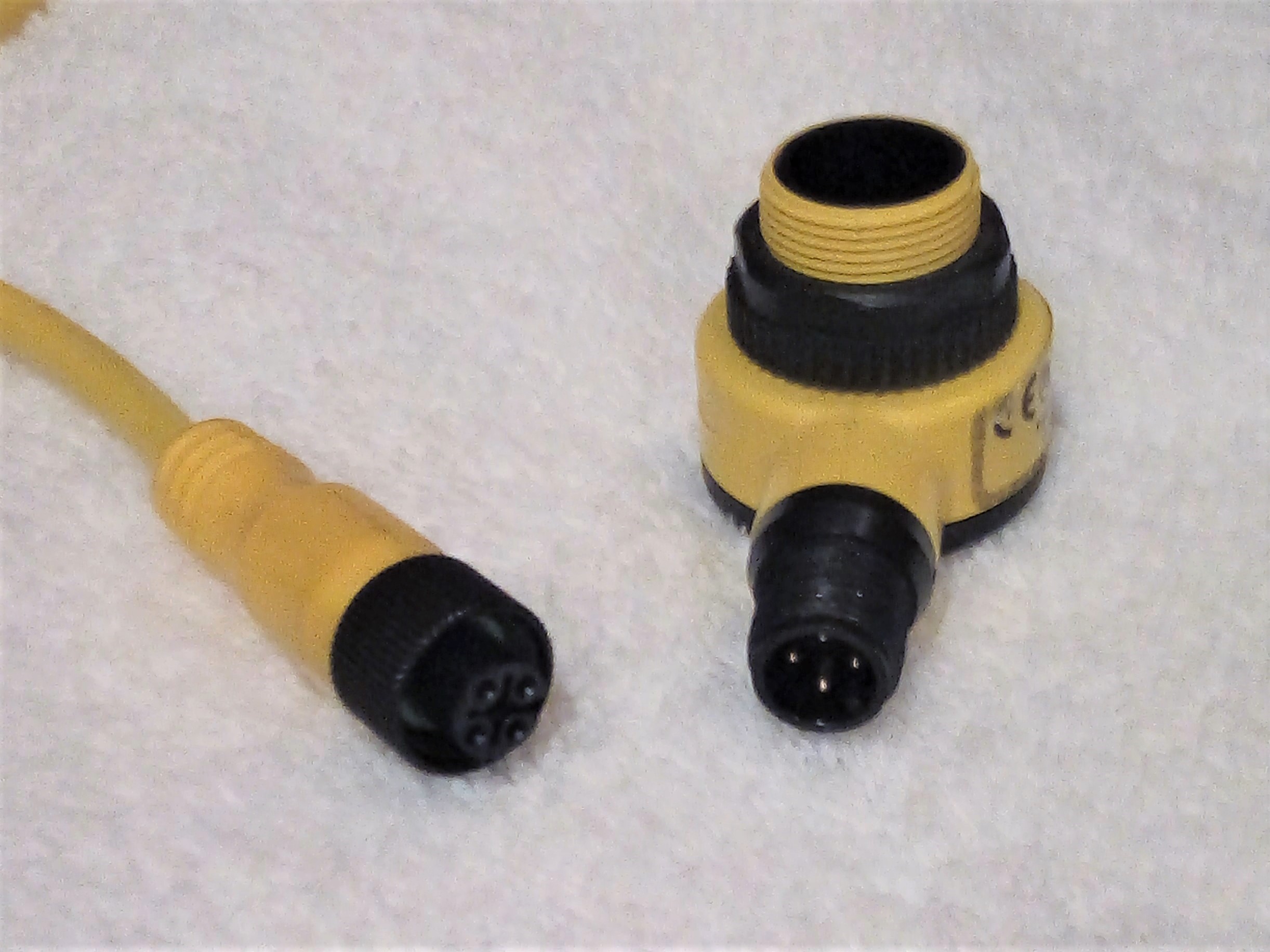

These sensors will be used for in-line sensors that either close or open a circuit when energized. The most common wire colors to be seen are Brn/Blu and Red/Blk depending on the origin of the sensor.
Sometimes, these wires will stick out the end of the exposed wire harness, but other times, a mini- or pico-style Quick-Disconnect (QD) cable will be required. If this is the case, you can count on seeing the Brn/Blu structure. This will be the case for either AC or DC sensors, so be very careful to read the datasheet. I witnessed a DC sensor explode once after someone connected 120 vAC to the wires and applied power.

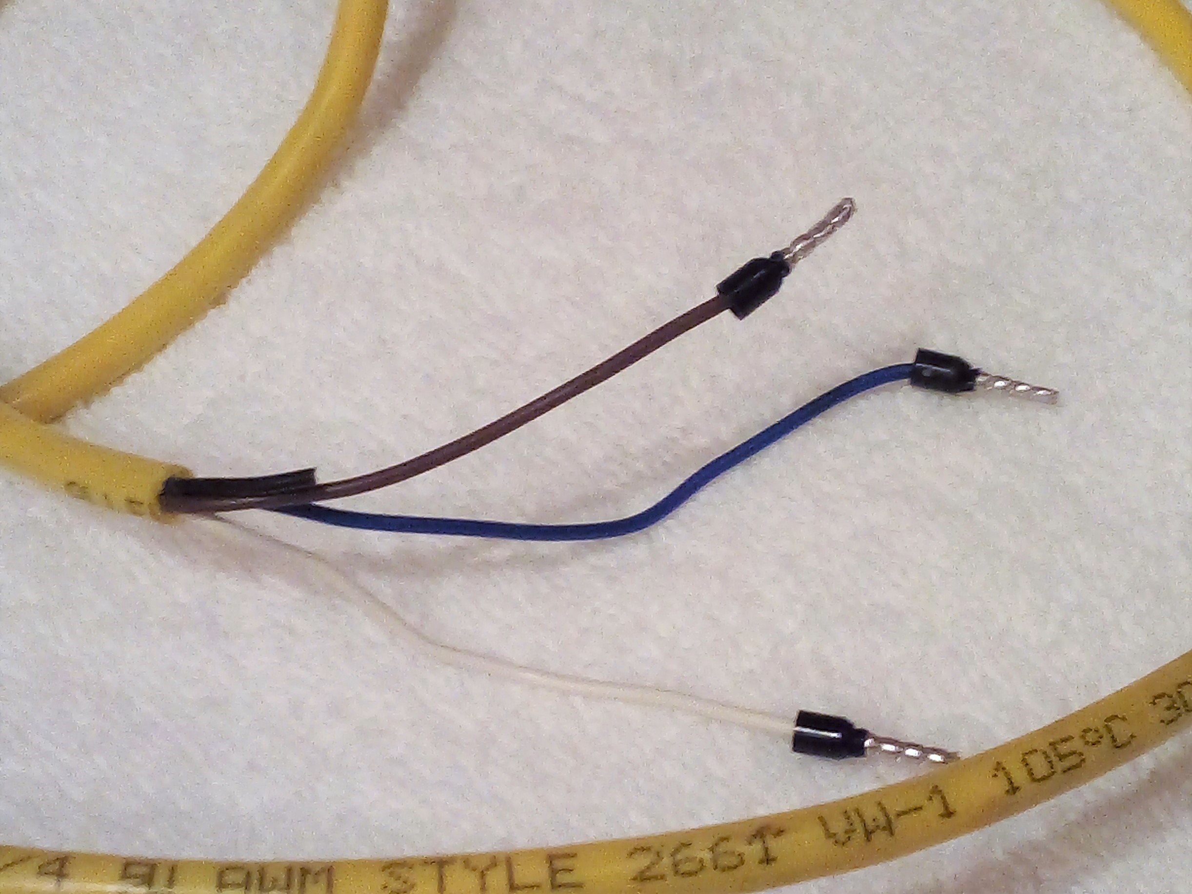

the connection end of a wire
The connection end of a Quick-Disconnect (QD) cable. This cable has been used in a past life with Brn+, Blu-, and the Wht used for the signal to the controller.
Normal 5-Wired
If the cable uses all 5 wires of the normal 5-wire QD cable, the Grn/Ylw striped wire is most often tied to an Earth grounded part of the circuit. This may often be employed to reduce EMI noise, although it is common for the sensor to include no such wire.

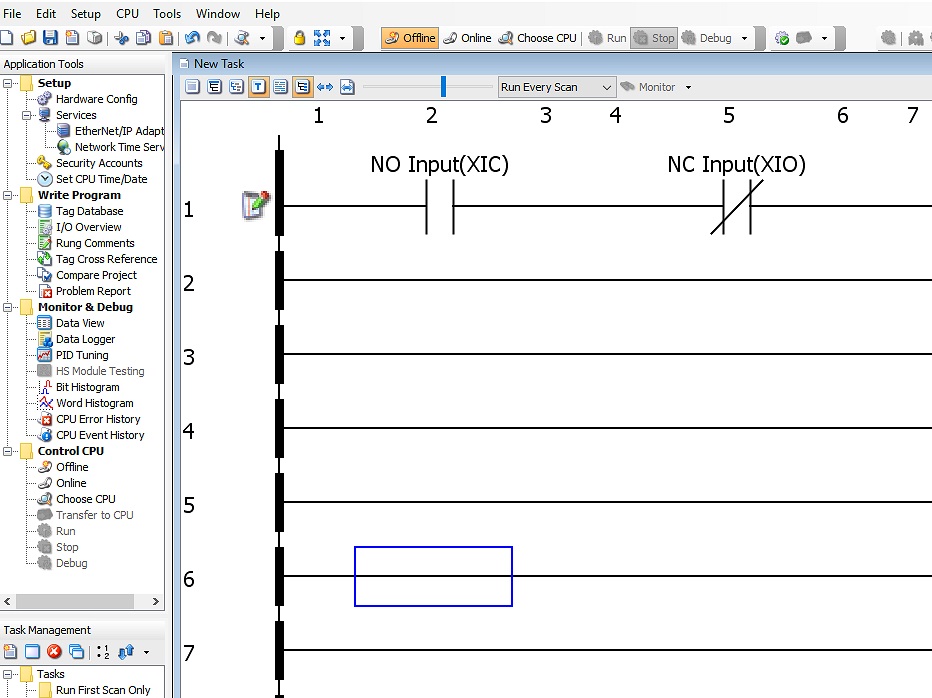

The Normally Open, or XIC instruction will be ‘true’ whenever current is flowing in the real-world circuit. If you have installed a Normally Open sensor, this instruction will be ‘true’ when the sensor is energized. A Normally Closed sensor allows current to flow, and is, therefore ‘true’ when it is non-energized.
The Normally Closed, or XIO instruction is the exact opposite. This instruction will be ‘true’ any time current is not flowing in the real-world circuit. For that Normally Open sensor, this instruction will be ‘true’ when non-energized, since that’s when current is not flowing. For the Normally Closed sensor, it will be ‘true’ when energized.
A fairly standard representation of contact symbols used to represent Normally Open and Normally Closed, or more formally XIC and XIO inputs.
A programmer must be able to match the symbol with the appropriate real-world device.
