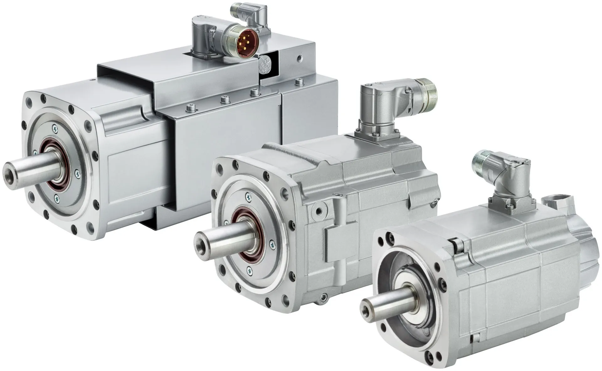

Figure 1. Servo motors differ from continuous motion motors due to their feedback loop and drive system. Image used courtesy of Siemens
What is a Servo Motor?
A servo motor is really quite similar to a normal continuous motion motor—there are AC and DC servo motors, brushed and brushless motors, and synchronous or asynchronous (induction) motors. What sets servo motors apart from regular motors is the feedback loop and the drive system.
Every servo motor has an encoder and drive controller: the encoder reports the position of the shaft back to the drive controller, thus making a closed-loop system. The drive system amplifies and filters the incoming voltage before applying current to the motor. The PLC will tell the drive system the position and velocity of the motor. The speed of the motor is controlled by fairly typical PWM and sine-wave signals, depending on the AC or DC nature of the motor.
Just like a typical AC motor, adjusting the frequency will change the speed of the motor. Similar to a typical DC motor, varying the voltage will change the speed. With an AC servo motor, the drive will accept an electric signal from a PLC or other controller, and the drive system will output current at a specific frequency until the desired position of the motor shaft is reached.

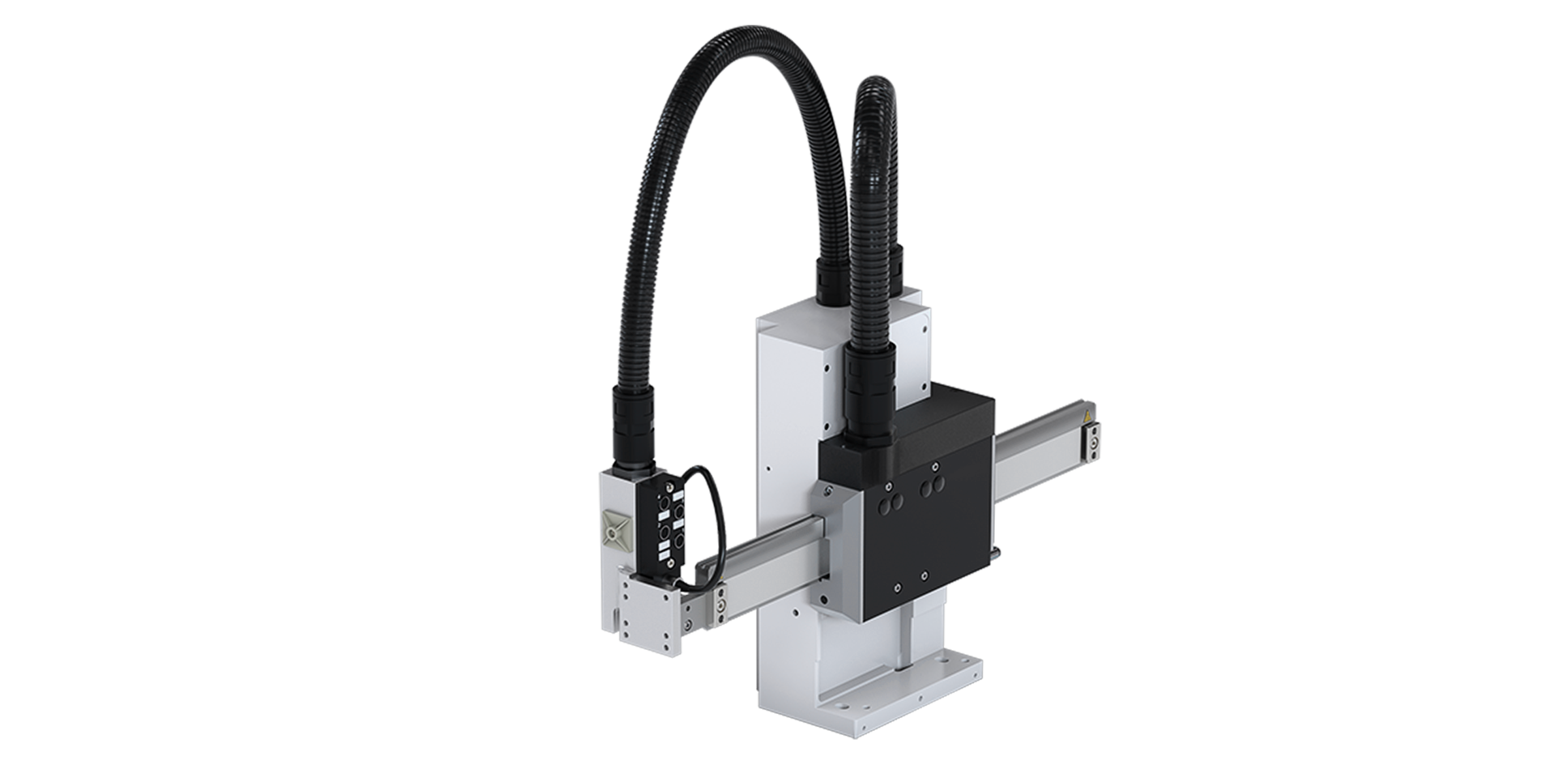

servo motors work well in pick-and-place applications
Figure 3.  Servo motors work well in pick-and-place applications because of their speed and accuracy. Image used courtesy of Weiss World
Applications of Servo Motors
Typically, a servo motor is combined with a gearbox, drive controller, and a linear actuator, which can be a lead screw or belt and pulley system that converts rotary motion to linear motion. This system is used to accurately and precisely move tooling from one point to another.
Within the PLC, the gearbox ratio and the actuator ratios are entered into a scaling algorithm so that when the PLC commands the servo to move a specific distance at a specific velocity, the drive system will be able to calculate the specific frequency and stop the servo after the encoder reports back the correct number of rotations. This type of system is typically found in pick-and-place stations where a component needs to be picked up from one location and placed at another location. Servo motors are a great tool for pick-and-place stations because of their speed and accuracy.

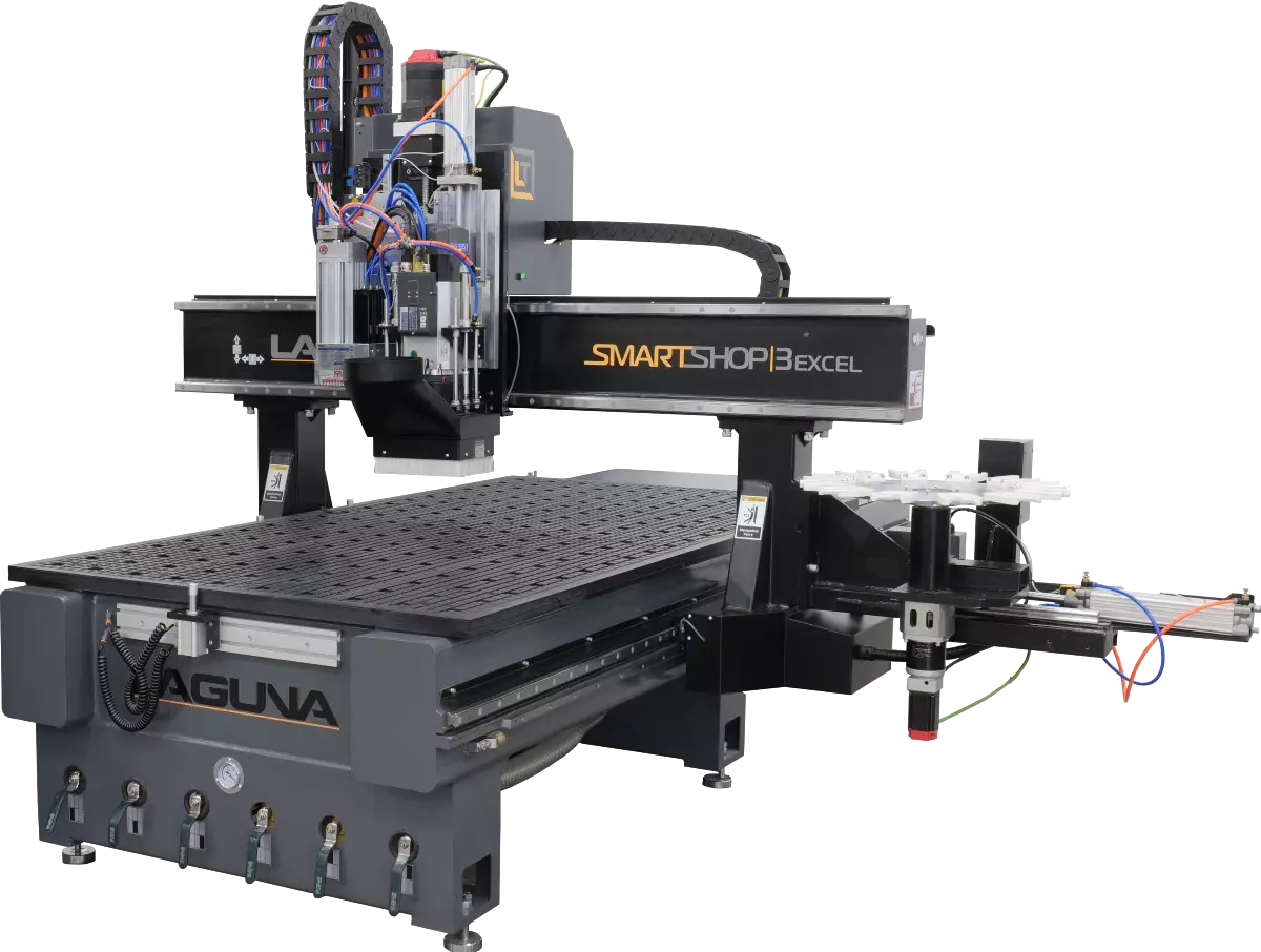

 stepper motors work well in machining because of controlled movements
Figure 4. Stepper motors are suitable for machining because of their controlled movements. Image used courtesy of Laguna Tools
Applications of Stepper Motors
Stepper motors have unique features that make them excellent candidates for highly specific motion profiles. They have the capability of using full torque at a standstill—the speed can be controlled by the frequency of the pulses to each pole and can rotate at very slow speeds without the risk of overheating.
With these special features and a smaller price tag, stepper motors can typically be found in 3D printing machines, CNC machining centers, welding equipment, and small inexpensive robotics. The small form factor, DC voltage operation, and open-loop design make stepper motors a great choice for hobbyists and small electronics. Stepper motors work well in applications where small slow movements need to be made.
