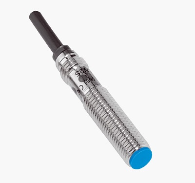

Discrete inductive proximity sensor
Figure 1. This sensor is provided with exclusively a PNP (sourcing) output only. Image used courtesy of SICK
Exclusively PNP or NPN Sensors
These sensors have a rating in the datasheet - they can only be PNP or NPN, and nothing can change the output. If they are connected to the wrong system, no damage will occur, but the signal will not be received.

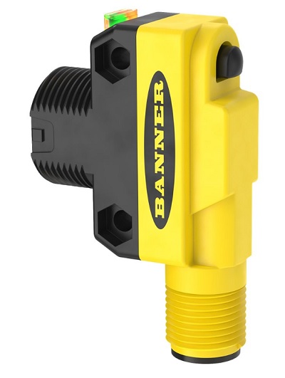

The primary traditional method of adjustment is a potentiometer, which changes the sensor's sensitivity when comparing the real-world input to the measured set point. Simply turning the small potentiometer will adjust the range of the sensor for a particular product. In many other cases, a small rubber tactile button can enter and exit the teaching mode.
Banner Engineering sensor
Figure 3. In this sensor, a small tactile push-button can teach the set limit position. Image used courtesy of Banner Engineering
The only problem with the manual adjustment is that it must be performed while the sensor is installed. It may be difficult to access, or touching the sensor might knock it out of alignment. For this reason, many engineers prefer software adjustments. Sending a short series of pulses to one of the signal wires can enter and exit the teaching mode, just like the button. In the case of IO-Link, adjustment parameters can be transferred to the sensor on startup to accelerate the teach process for a brand-new sensor.
