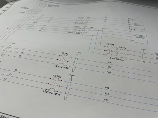

Figure 1. An electrical drawing showcases some of the components discussed throughout the article, namely manual and overload circuit breakers. Image used courtesy of the author

Circuit Breakers
A circuit breaker is a switchable protective device used to safeguard electrical power systems by interrupting the flow of electricity under magnetic or thermal conditions. It functions through a mechanism that disengages two normally closed contacts upon detecting a fault.
Circuit breakers are the preferred choice compared to fuses in situations where swift restoration is crucial. This preference is due to their ability to be easily reset and reused multiple times, which reduces the need for frequent maintenance. Installation is dictated under various national and local electrical codes and guidelines. Breakers are applied to different scenarios including motors with various loading factors, so there are different curves available that determine the trip current and speed.

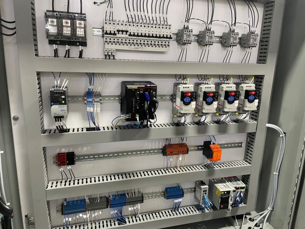

Figure 2. This electrical cabinet also showcases some of the components discussed in the article. Image used courtesy of the author.

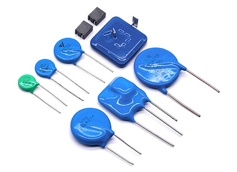

An MOV, or metal oxide varistor, is a small electrical component that protects devices from sudden spikes in voltage. Inside the MOV are many tiny diode-like junctions between the zinc oxide grains. A diode limits electricity to only flow in one direction. When voltage is operating at average capacity, the MOV has a high resistance, not letting too much current through, therefore not affecting the circuit much. During high-voltage situations, the MOV's resistance drops significantly. This allows the current to rush through the MOV instead of damaging the connected devices. So, an MOV’s resistance is dependent on the voltage applied.
A disadvantage of an MOV is it will wear out from absorbing frequent high-voltage spikes, needing occasional replacement. It dissipates absorbed energy as heat, causing deterioration.
Figure 3. A variety of MOV device packages. Image used courtesy of JAK Electronics
In summary, metal oxide varistors (MOVs) are best used for safeguarding against short, high-voltage spikes. On the other hand, fuses and circuit breakers are better suited for offering protection against overcurrent situations. It's worth noting that MOVs are frequently used in parallel with fuses to protect circuits fully.

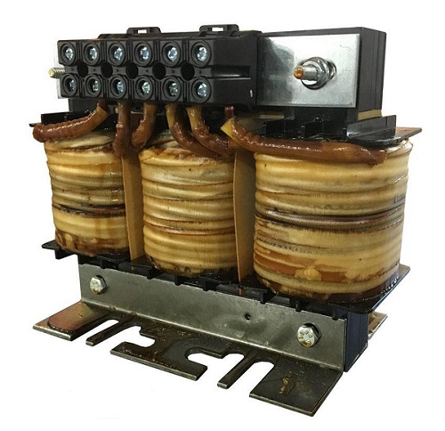

Figure 4. An example of a line reactor device. Image used courtesy of Wolf Automation
Line Reactors
A line reactor is a device that limits current rise, reduces spikes and surges, and minimizes electrical noise. Line reactors are commonly found in VFDs (variable frequency drives).
When electrical current flows through a line reactor, it generates a magnetic field that resists changes in the current. A coil of wire creates the magnetic field. This resistance helps to smooth out fluctuations and reduce noise, making the power supply more stable. Using both a line reactor and a line filter can be beneficial.
