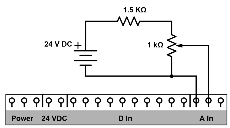

Located at the top right corner of the PLC is a set of three analog terminals, 2M, 0, and 1. As expected, 0 and 1 are the analog voltage signal inputs, but the 2M is the common ground. If the inputs are measured with respect to the (-) 24 V rail, then this 2M terminal should also be connected to the common (-) 24 V rail.
For this example, a simple 1 kΩ potentiometer (3 terminal adjustable resistor) is configured with a 1.5 kΩ resistor in series with the 24 V supply to ensure that the variable voltage never exceeds 10 V.
isual representation of the top of an S7-1200 with the analog terminals on the upper right
Figure 2. Visual representation of the top of an S7-1200 with the analog terminals on the upper right (note: not all digital terminals may be shown).
A keen mathemetician may notice that this voltage divider will not precisely reach 10 V, but as luck would have it, my old potentiometer exceeds 1 kΩ, so the net result is a tutorial that must address calibration in order to achieve a correct output.

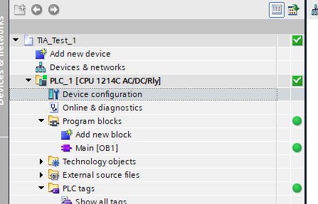

In your project, double-click on ‘Device configuration.’
device configuration
Figure 3. Device configuration.

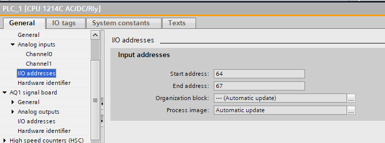

If the PLC is selected, there will be a ‘Properties’ window open at the bottom of the screen. Select the I/O addresses under the Analog inputs, which will display the start and end addresses for both inputs.
As you can see below, the first input consumes addresses 64 and 65, and then the second one consumes 66 and 67.

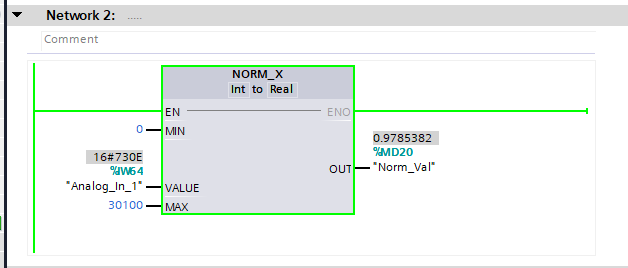

Finally, with all the building blocks in place, we can create a ladder network to examine the anticipated range of the incoming analog value and convert this into the equivalent 0-1 decimal value.
NORM_X serves to normalize a value into a 0-1 decimal value.
Figure 7. NORM_X serves to normalize a value into a 0-1 decimal value.
Several steps are completed in this block.
  • The input and output data types must be determined. In this case, the input is an Int (16 bits, although I do not know why ‘Word’ is not presented as an option to match the data type), and the output is a Real.
  • The MIN anticipated value is 0
  • The MAX anticipated value, as determined by examining the Watch table as I turned the potentiometer, actually exceeded 10 V and was right about 30100.
  • The VALUE is the address of the analog input.
  • The OUT destination is that Real tag we created. If we use an integer value in this command output, it will be truncated and always appear as 0.
Now, you can turn the potentiometer and fine-tune your own values. Perhaps it does not go down to 0 V exactly, and maybe you used a different resistor, and it does not reach 30000 as mine did. The OUT value should swing from 0 to 0.9999 or as close to 1.0 as possible through the entire input value range.
In reality, the input signal will probably not transition from 0 to 10 V. It will likely be a pressure or temperature sensor, which might be capable of a large value range, but only a fractional change will be seen for your process. This NORM_X command allows you to identify the actual MIN and MAX expected values, providing much greater precision to the OUT value of the command.
