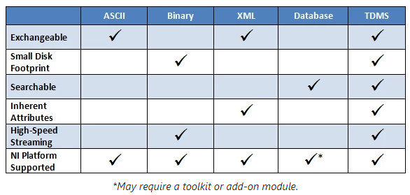

Files can be written in several formats while using LabVIEW. The three most common include binary, technical data management streaming (TDMS), and ASCII.
Figure 1. A comparison of file formats. Image used courtesy of NI
Binary files are efficient in terms of space and can be written quickly to a file. For large data sets, this is a real advantage. However, binary files are not human-readable, and so quick error checking is not convenient.
TDMS files are binary-based, but are searchable like a database, and exchangeable among platforms. TDMS is an NI file format, so it is built into certain LabVIEW packages, though some functions might require an add-on module or tool kit.
ASCII files are human-readable, exchangeable between platforms, and relatively simple to implement. They are not the most efficient for space usage or file writing speed, so their use should be limited to lower sampling rates (under 10 Hz) and shorter times (scale of hours or days). However, it is nice to view the data with a simple text viewer, or have the files imported into a spreadsheet program without any complicated data conversion.

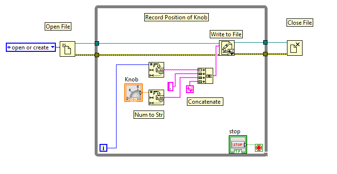

Files must be opened, written to, and then closed in that order. Based on this format, a typical VI will open a file once, write to it many times, then close it once. Therefore, the open and close operations should be outside the loop, and the write-to-file operation should be placed inside the loop. All of the file writing tools are found in the functions palette under “File I/O.”
Figure 3. A simple file-writing routine opens the file and records the loop iteration and knob position every time the loop executes.
In figure 3, when the stop button is pressed, the file closes. Numbers are converted to strings and then concatenated into one big string for each loop iteration. The “open file” function must be configured for use. The top left terminal can either be hardwired to a filename or, if left blank, will ask the operator for a file name when the VI runs.

The concatenate function is simply an addition tool for strings. The strings will be added together in the order they are placed (top to bottom) in the concatenate function. However, the programmer should place a delimiter between each string to delimit between data, which will show up as different columns in spreadsheet software. This could be a tab, space, or comma (the most common).
Figure 8. This concatenate function inputs data from the two fractional number to strings, separated by a comma. The last character is an “end of line” constant.
After all of the strings have been wired to the concatenate function, place an “end of line” constant as the final string. This will drop the cursor to the next line for the next loop iteration. Without it, the data won’t be arranged in neat columns.
