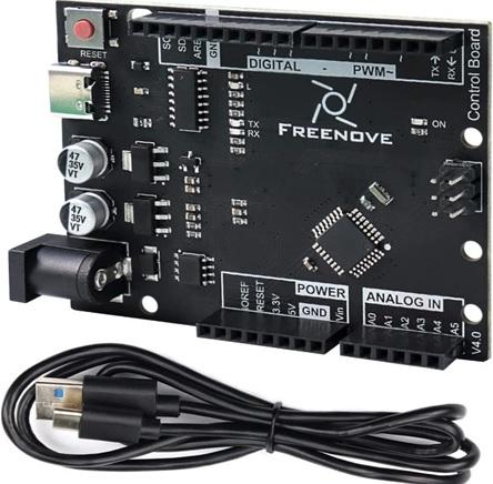

Like the traditional Arduino Uno, this model uses a surface mount device (SMD) microchip ATmega328 microcontroller. Another difference between the FPK control board and a traditional Arduino is the USB connector, which is a version C instead of the traditional USB 2.0 A-male to B-male cable connector.  The footprint of the FPK control board has the same physical dimensions as the traditional Arduino Uno. Therefore, the traditional Arduino can easily replace the FPK control board.  Figure 1 shows the FPK control board.
The Freenove Project Kit control board is Arduino Uno compatible
Figure 1. The FPK control board (An Arduino Uno Compatible). Image used courtesy of AliExpress

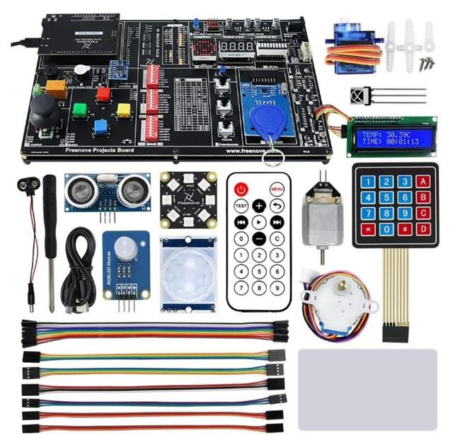

Various through-hole and SMD components like shift register ICs, an LED matrix, a four-digit seven-segment display module, an LED bar, four tactile pushbutton switches, four potentiometers, bus transceiver ICs, Cadmium Sulfide (CdS) photoresistor, thermistor, and brushed motor IC are all mounted directly onto the black printed circuit board (PCB).
Also included with the FPK are additional component accessories like a DC motor, a liquid crystal display (LCD), a keypad, red, green, and blue (RGB) LED, a servo motor, a radio frequency identification (RFID) module, and an infrared receiver. Figure 2 illustrates the FPK with some accessory components.
Freenove Project Kit with side items including electrical-electronic components
Figure 2. FPK with electrical-electronic components. Image used courtesy of AliExpress

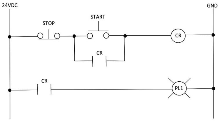

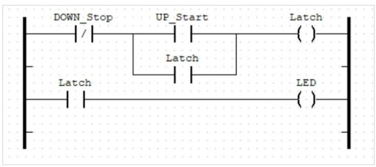

Start the OpenPLC software and open the Start-Stop Control Station LD program created in the previous project article.  Here is the relay wiring ladder diagram implemented with the OpenPLC software.
start-stop control relay ladder diagram
Figure 3. Start-stop control relay ladder diagram.

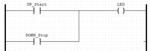

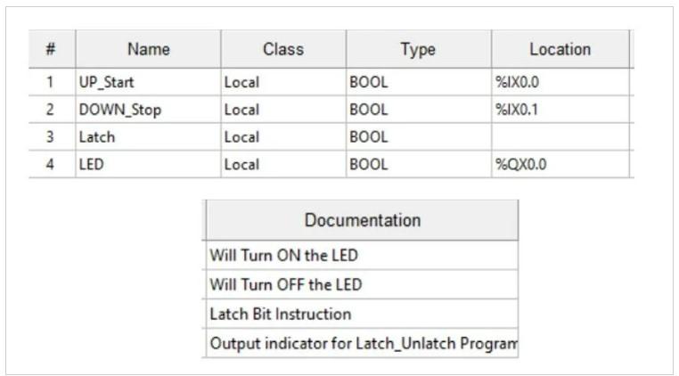

Using Figure 3 as a schematic, a start-stop tag listing is created, as shown in Figure 4. The equivalent OpenPLC LD program is shown in Figure 5. After creating the tag listing and the LD program, save the OpenPLC project program to your computer, which is now acting as the OpenPLC control automation development system. Saving the project will ensure the created software files’ integrity are error-free. Traditionally, to distinguish between this version of LD developed for the FPK, a new LD project would have been created.

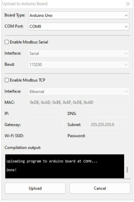

The next step in this evaluation exercise is to upload the LD program to the FPK control board. Therefore, attach the control board to your control automation development system. Click on the Arduino logo. A configuration panel will appear. Click the down arrow to display various microcontroller-embedded devices from the Board Type drop-down list. Select the correct microcontroller device, then select the correct communication (COM) port in the next drop-down list with your mouse. Figure 6 illustrates this step.

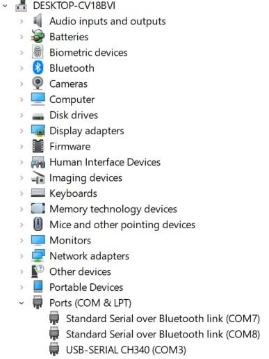

Note: To ensure the correct COM port is selected, you can check by opening the device manager on your development system. Look for the Ports (COM & LPT) category item. Click the arrow with your mouse to expand the selection. You should see an established COM port for the attached control board.
Figure 7 illustrates the COM port validation check.
Using COM port to find the correct control board
Figure 7. Finding the correct Control Board COM port.
Note: The COM number will change when connecting to another USB port. To ensure proper communications between the FPK control board and the control automation development system, validate and select the correct COM port before downloading the LD program.

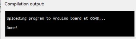

You are now able to download the start-stop LD program to your FPK Control Board. Click the configuration panel’s Upload button. After successful compilation, the Done message will be displayed in the compilation output window.

Pressing the S1 tactile pushbutton will turn on the relay-controlled LED but not latch it. To correct the switching function, change the DOWN_stop to a non-inverting (normal) bit instruction. Change the UP_start to an inverting (negated) bit instruction. Upload the revised LD program to the FPK control board. Pressing the S1 tactile pushbutton switch latches the relay-controlled LED. When you press the S2 tactile pushbutton switch, the LED turns OFF (unlatch). Congratulations on successfully building and programming an FPK PLC!
correcting latching function of the start-stop control LD program
Figure 10. Correcting the Latching function of the Start-Stop Control LD program.
