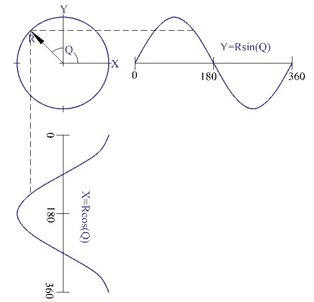

In a recent design, we needed to drive X and Y positioners to create circular and spiral motions. Our client for that project, Island e-Beam, manufactures vacuum deposition equipment. The material to be deposited is evaporated by bombarding it with an electron beam. They needed to sweep the beam in a controlled fashion. More specifically, they need a controller to modulate currents to the X and Y beam-positioning coils. Figure 1 illustrates circular motion.
using x and y positioners to drive circular motion
Figure 1. Using X and Y positioners to drive circular motion. Image used courtesy of SRQ Technology
The system was to be controlled from a small microcontroller. Operating speed requirements and limited memory ruled out using full sine and cosine functions. This application did not need high accuracy, so we mathematically studied three approximations. The third, and simplest, met our requirements, so we used it.

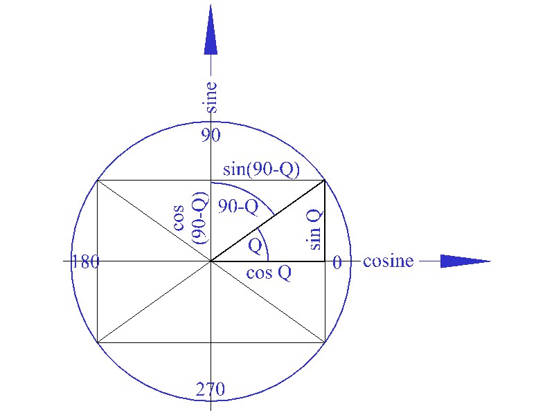

Angles Beyond 45 Degrees
Going back to high school geometry, using degree notation, remember:
$$sin( \theta) = cos(90- \theta)$$
$$cos( \theta) = sin(90- \theta)$$
sine-cosine relationships
Figure 2. Illustration of sine-cosine relationships. Image used courtesy of the author
Figure 2 illustrates sine-cosine relationships. You can use this between 45 and 135 degrees. Above 135 degrees, looking at the figure:
From 135 to 225 degrees:
$$sin( \theta) = -sin(180- \theta)$$
$$cos( \theta) = -cos(180- \theta)$$
*Note that these are negative.
From 225 to to 315 degrees:
$$sin( \theta) = -cos(270- \theta)$$
$$cos( \theta) = -sin(270- \theta)$$
*Again, these are negative.
Remember that, for higher angles:
$$sin( \theta) = sin( \theta -360)$$
$$cos( \theta) = cos( \theta -360)$$
For angles over 315 degrees or below -45, simply add or subtract 360 until they are between -45 and +315. Once they are, you can use the above equations.
