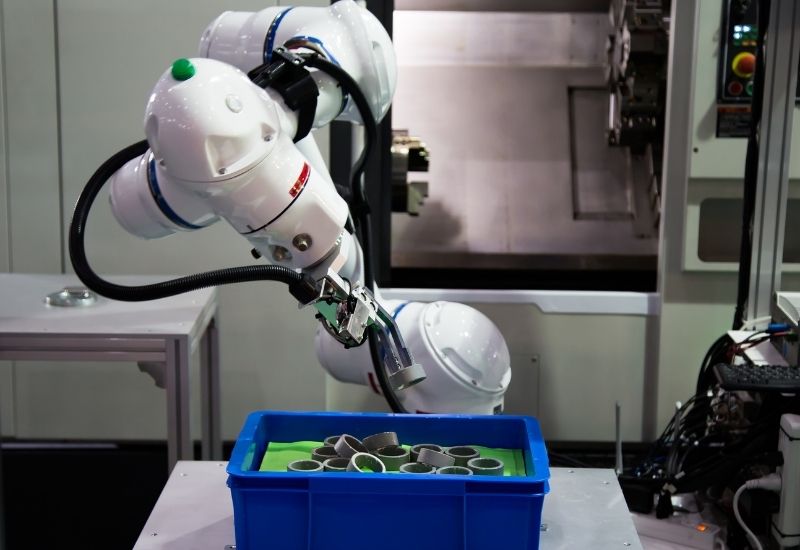

Figure 1. Robotic singularity impacts robot performance and occurs when a robot loses one or more degrees of freedom. Image used courtesy of Canva

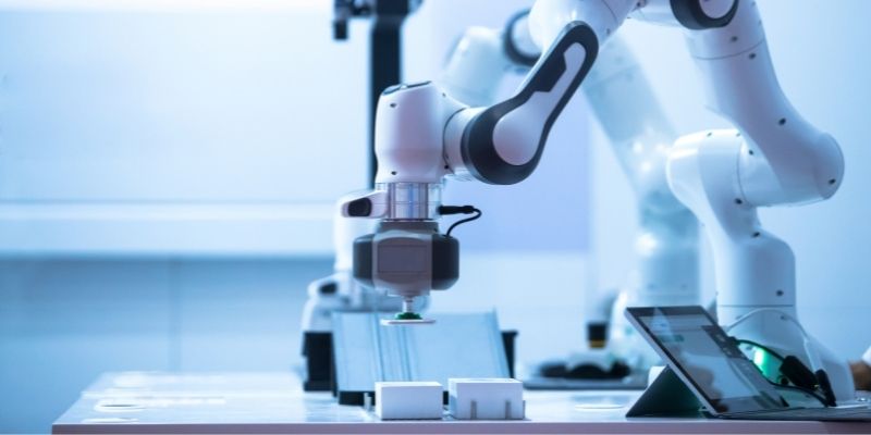

Figure 2. Common types of singularity that occur in six-axis robot arms include wrist, elbow, and shoulder singularity and inner and outer workspace limit. Image used courtesy of Canva

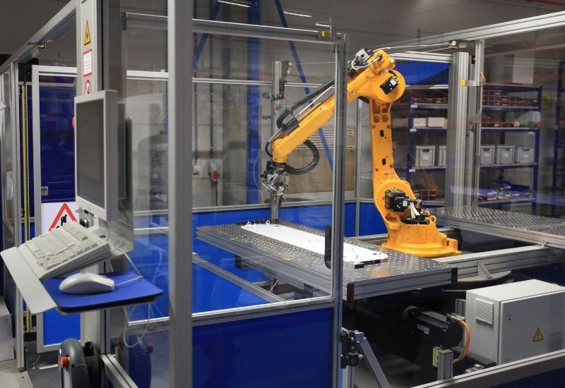

Figure 3. A robot’s cell should be designed to avoid operating near singularities. Image used courtesy of Canva
It is best to avoid designing a cell where the robot must operate near singularities. In the case of workspace limits, robots should not be used near the extremes of their reach. When the robot is used at the far limits of its reach, a larger robot is probably a necessary addition to the cell. In order to avoid problems with inner workspace limits, designing the cell in such a way that the robot can work farther away from its center is likely the best viable solution.
