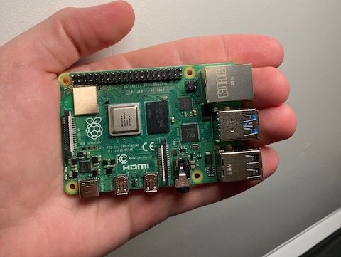

Raspberry Pi 4 system
Figure 1. The palm-sized Raspberry Pi 4. Image provided by the author

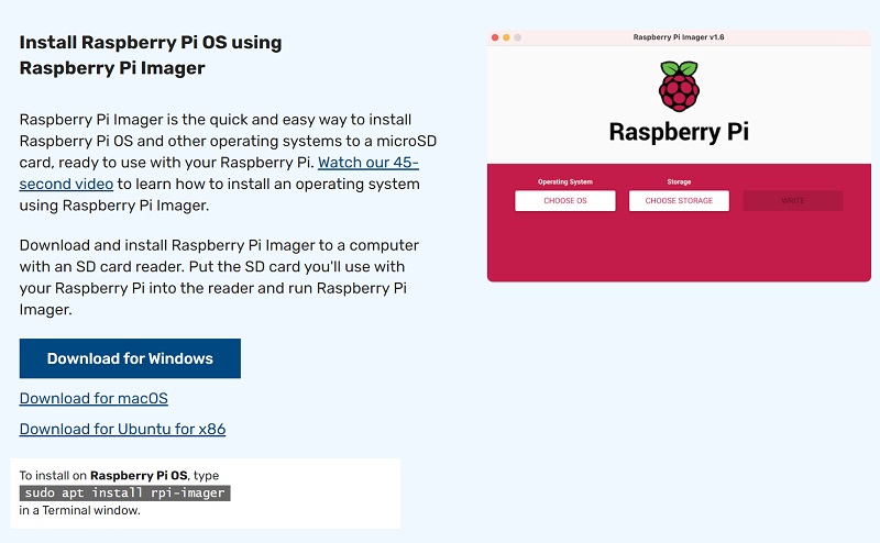

The first step is to install the native Raspberry Pi operating system onto the SD card. Raspberry Pi OS, the latest version of the system, was initially called Raspbian. The Unix-style OS is based on the Debian Linux distribution. If you are a Mac user, this OS will feel very familiar, especially in the terminal environment. The OS can be found here: Raspberry Pi OS. Once redirected to the official Raspberry Pi page, there is an option to download the imager. This OS software loads the operating system properly onto the SD card; simply copying files will not work.
Select the appropriate option for your respective local machine.

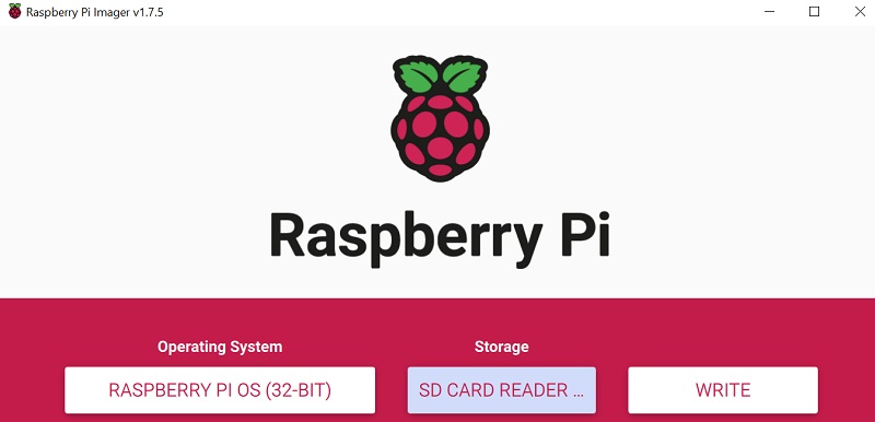

Once the Raspberry Pi Imager is installed, execute the program. In a nutshell, this program facilitates the transfer of the Raspberry Pi OS to the microSD card. First, select the recommended Raspberry Pi OS (32-bit) from the “Operating System” section.

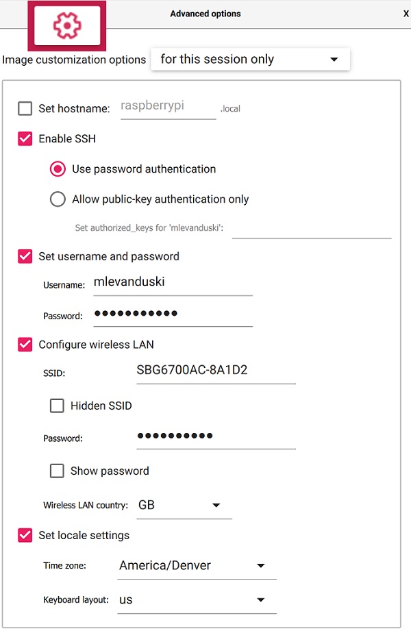

Before we write the image, or operating system (OS), to the microSD card, select the lower right gear icon for advanced settings. Within the advanced settings, we’ll enable a network protocol called SSH or secure shell. This will allow us to remotely access the Raspberry Pi from our local PC without needing a monitor or HDMI cable.
Within this settings page, it will also be a good idea to provide your router information. This will allow the Raspberry Pi to connect to your local home network upon startup, and thus allow your PC to access via SSH.
Advanced imager options
Figure 5. Raspberry Pi Imager advanced options. Image provided by the author

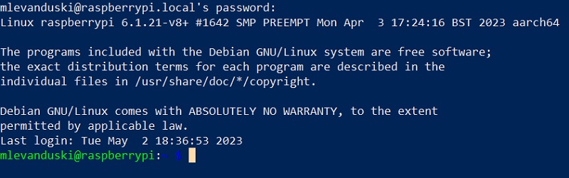

To remotely access the Pi, open up a terminal. In PowerShell on a Windows system or a terminal on a Mac, the command is the same:
ssh [email protected]
You may get a warning that the host cannot be authenticated. Enter yes + enter to proceed with connecting to the Pi. Next, the terminal will prompt for the SSH password set in the advanced options (Figure 5). Enter that password into the terminal. Please do not be alarmed if no keys or visible feedback is being displayed as you are typing in the password. No visual cues are normal. Once you have entered the respective password, select enter. You should now have access to a remote terminal within the Pi from your local PC. You’ll notice the username@hostname preceding each command now.
If you are a Windows user, you’ll also notice that even though you are running Powershell on your Windows box, the command line is now Linux-based, given by the ~$:
SSH login to Pi from computer
Figure 6. Successful SSH login. Image provided by the author

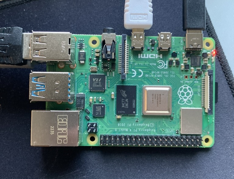

Accessing Raspberry Pi with Physical Hardware
Having a visual display is much easier to navigate than the terminal, but you will need a keyboard, mouse, HDMI cable, and monitor to make this approach successful. With all ports plugged in, the setup should appear similar to below.
Raspberry Pi with mouse, keyboard, and monitor
Figure 8. Raspberry Pi with local hardware for accessing the operating system. Image provided by the author

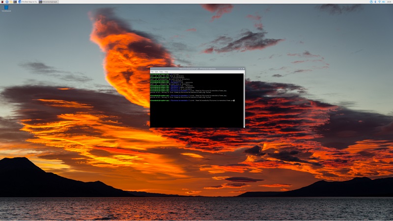

Once booted up, the Raspberry Pi homepage on the monitor should resemble below, although perhaps the command prompt window will not always be active.
Raspberry Pi desktop
Figure 9. Successful boot onto the operating system desktop display. Image provided by the author
