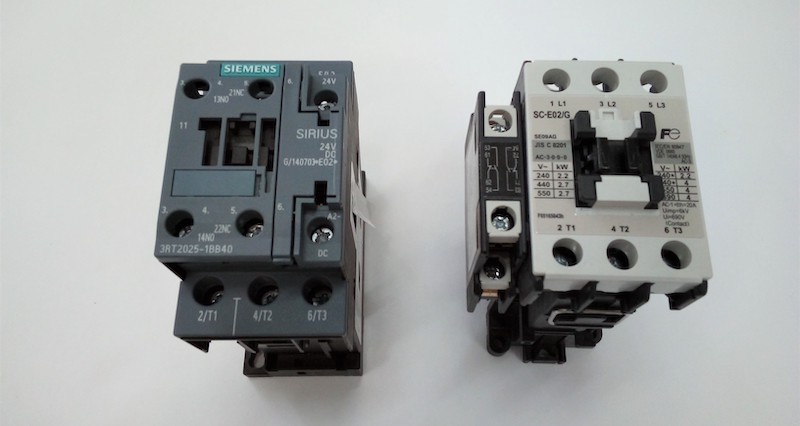

The DOL method is so simple that there really isn’t a wide variety of different components that form the DOL starting system. A main three-phase supply is wired into the circuit usually through a circuit breaker or fused disconnect with a manual handle. The power is sent through a contactor on its way to the motor. Often this contactor may be paired with an overload relay, but this is the entire extent of the direct on-line method.
An example of two different motor contactors which provide DOL starting methods.
Figure 1. An example of two different motor contactors which provide DOL starting methods.
The contactor coil is controlled by a pushbutton or selector switch circuit running at a lower voltage. The only more complex variation exists when two contactors are ganged together with interlocked coils so that only one may be activated at a time. This can reverse the motor.
Again, the disadvantage of these DOL starting systems is the abrupt nature of starting which causes the high in-rush current.

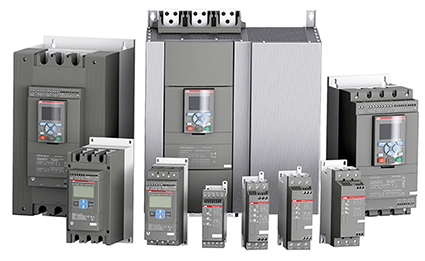

There is a good reason that DOL starting was the only method available for many decades of early control systems. The components that allow a soft starter to control the speed are based on solid-state (usually silicon) devices, which weren’t invented until the mid-20th century.
Figure 2. A selection of soft starting motors. Image courtesy of ABB.
In a very short description, the main operating principle is that a pair of silicon-controlled rectifiers (SCRs) or similar TRIACS which can handle alternating voltages are placed in line with each of the motor phase supply lines. If the entire waveform is allowed to be sent, the motor will receive full voltage just as with a normal contactor.
These SCRs and TRIACs can be activated, or ‘fired’ at very specific times, usually determined by a microprocessor or simple digital control circuit. If the device is fired just as the voltage is at its peak, then only half of the total available energy is supplied to the motor. But even while reducing the energy supply, the full voltage is still applied.
In contrast, many methods such as reduced-voltage starting actually dissipate much of the energy through a resistor. This yields massive amounts of waste heat and reduces the torque output from the motor by lowering the voltage.
Soft starting means to begin with supplying a very small amount of energy just to get the motor turning slowly, but then rapidly ramp up the energy until the full running speed has been reached. Notice that during this time, the peak voltage of the waveform was never reduced, only the percent of the waveform supplied to the motor was reduced.
This operating principle shares some similarities to pulse-width modulation (PWM) in DC motor circuits, but a PWM cannot be used with AC since the voltage is not constant.

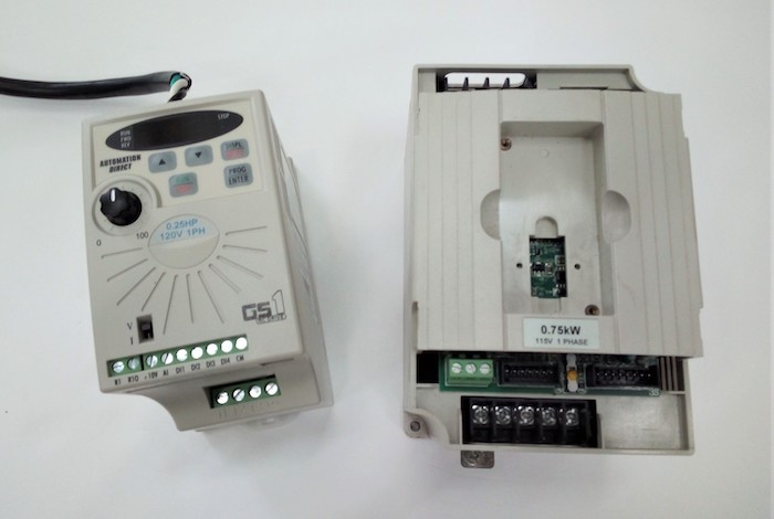

Although variable frequency drives (VFDs) are not soft starters by definition, they can produce the same effects. Usually, they are more expensive than a basic soft start controller, but sometimes the additional benefits are worth the cost.
Figure 3. Two examples of VFDs which provide ramping, but are more advanced than a typical soft starting system.
They add the ability to be networked to a control system and to have dynamic control over changing ramp rates, alarms, system monitoring, data collection, and a wide range of other benefits.
These VFDs are worth mentioning as a very common (and extremely useful) modern alternative to soft starters.
