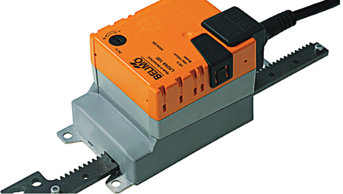

A linear actuator is a device that creates linear motion of an attached mechanical assembly, usually a rod. Linear motion is executed with a built-in motor connected to the linear rod through gears of different sizes and ratios. As the motor rotates, the gears convert the rotational motion into linear motion.
Linear actuators generally use direct current (DC) brushed or brushless motors and a DC power supply, such as 12 VDC or 24VDC. However, DC motors aren’t required. Steppers and induction motors can also move linear actuators, depending on the load and application. The direction of actuator movement can be easily reversed by reversing the power supply terminals.
Figure 1. A linear actuator. Image used courtesy of Bola Systems
Linear actuators contain sensors at both the minimum and maximum ends to detect the rod’s travel at both ends and, if needed, stop further movement to prevent damage to the internal components. The linear actuator’s speed is not fast but can deliver significant power. For this reason, linear actuators are used in applications that require motion against weighted items. Some linear actuators also include feedback signals, indicating their limit reach.
The linear rod cannot move to its initial position when there is no current. Instead, it requires DC voltage in opposite polarity to move the rod back to its initial position.

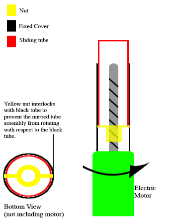

Figure 2. The basic motion of a linear actuator. Image used courtesy of Bcraig15
Linear actuators can move in both forward and reverse directions. It is accomplished by changing the polarity of applied DC voltage at the actuator’s terminals. This allows controlling the attached assembly in both directions. The linear actuator’s position remains fixed at its current position, even in the applied voltage absence.

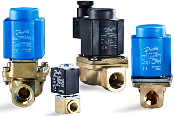

Valves: Solenoids can be used in combination with valves, called solenoid valves. Solenoid valves are common in industrial applications where fluids, such as water and steam, are involved.  They turn valves ON and OFF and provide an effective way of switching fluid supply without human involvement.
Figure 3. Solenoid valves are used for industrial refrigeration. Image used courtesy of Danfoss
Common areas of application for solenoid valves include equipment for food and beverage, pharmaceutical, HVAC, and utility.
