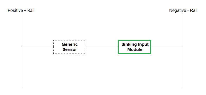

The common ‘sinking’ input terminal means that the path back to the (-) supply goes through the terminal, and usually out through a common terminal nearby. If you want to supply a proper signal, you must provide a +24 volt level at the terminal in order to complete the circuit. In a simple line diagram, it would appear as shown below.
Sinking input circuit
Figure 4. Sinking input circuit diagram
This means that any device attempting to send a signal to the sinking input terminal must be 0 V when de-energized, and 24 V when energized.

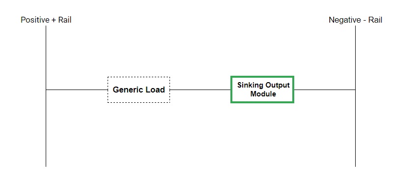

In the less common case of a sinking output, the terminal supplies the direct path back to the negative voltage supply. Therefore, when energized, the voltage should be 0 volts. However, when de-energized, a voltmeter will not show 24 volts unless the load device is connected and functioning properly. So in the case of sinking outputs, they cannot be tested with the load disconnected. The diagram below is an output circuit with a sinking output configuration.
Sinking output circuit
Figure 7. Sinking output circuit diagram
