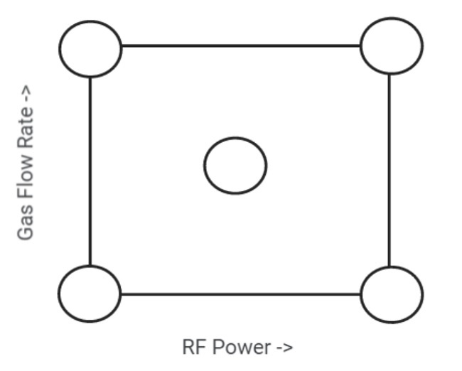

In factorial analysis, two or three controls are varied and their effects on a single output parameter are evaluated. If two controls are chosen, the experiment is two-dimensional (2D); if three are chosen, the experiment is three-dimensional (3D). All other controls are set constant during these experiments. The controls will vary from the largest and smallest values, as well as one “center” value.
As an example, consider a chemical vapor deposition (CVD) system which produces coatings. The thickness of the coating varies with the flow rate of a gas and the amount of radio frequency (RF) in the chamber.
Experiment options
Figure 2. This 2D factorial analysis shows a graph of the experiments to conduct. Each circle represents an experiment: the bottom left represents the lowest RF power and lowest gas flow rate, and the upper right represents the highest RF power and the highest gas flow rate.

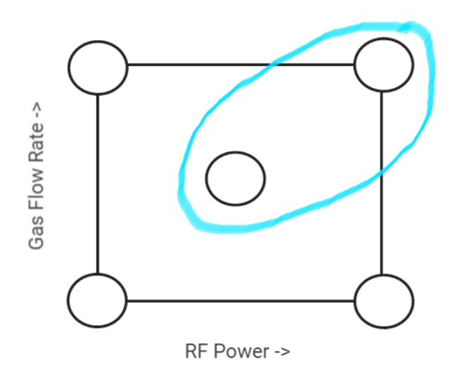

After each of these experiments have been conducted, and the coating thickness measured, the engineer can look for trends. From there, they can set up new experiments with a new factorial analysis.
Focus experiments
Figure 3. Suppose the two circled experiments provided the thickest coating. A new 2D factorial experiment can be created in the upper-right quadrant of this graph, if time and resources allow.
The real advantage of factorial analysis is that new information is acquired with each set of experiments. If time and resources only allow for five trials, the engineer can identify a region of optimized values. If the data is statistically insignificant, this can be noted as well since further experiments are required. However, if more time and resources become available, they can narrow the range of control values and create a new set of experiments.

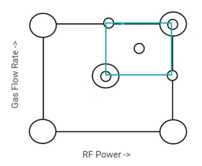

Improved experiments
Figure 4. New detailed experiments are represented by the small circles.
Contrast this with simply rastering through a list of process parameters, holding all control variable values constant, while stepping through adjusting one parameter at a time. It would be really easy to conduct five experiments and learn nothing!
