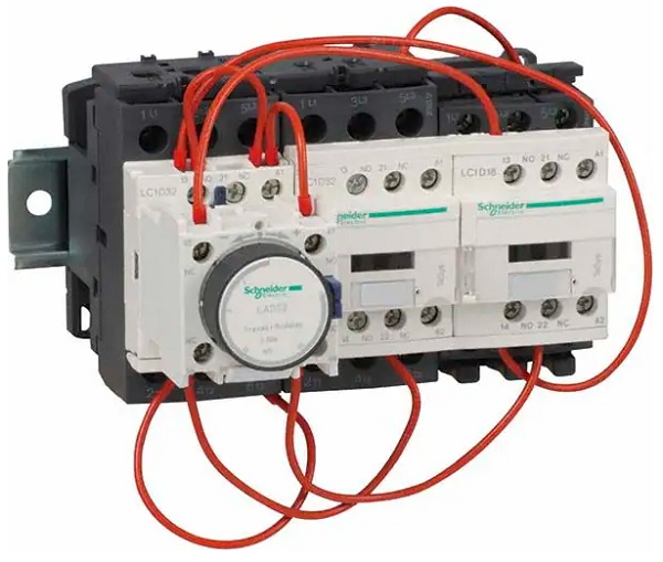

Figure 1. An example of a pre-built star-delta motor starter. Image used courtesy of MSC Industrial Supply

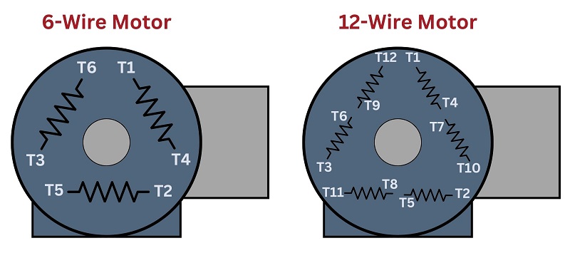

There are four distinct wiring patterns inside 3-phase motors (check out the header links for a deep dive into each pattern), and for star-delta to work, the motor must be able to fully switch between the two patterns:
3-Wire Motors
Inside the motor, the windings have been fixed into a dedicated wye or delta pattern, with the supply voltage also being determined at the factory. The most fool-proof, but most inflexible, and not very common. These can not be used for star-delta starting.
6-Wire Motors
Three independent windings with both ends accessible by the electrician. The pattern (wye or delta) can be changed, but the maximum voltage cannot be changed. If the motor will not be rated for high/low voltage. These can be used for star-delta, as long as the max voltage is observed.
9-Wire Motors
The most common configuration, these have one dedicated wye or delta inside the motor, with three independent windings accessible by the electrician. The voltage (high/low) can be configured by the wiring, but since they have a fixed wye or delta inside, they can not be used for star-delta starting.
12-Wire Motors
The most flexible of all motors, these have six independent windings, with both ends of each winding accessible to the electrician. By wiring them in series or parallel, they can be used to form either delta or wye patterns, in either high or low-voltage configuration. Since they can form both patterns, they can be used for star-delta starting.
Figure 2. The two types of motors that can be used for star-delta configuration: 6-wire and 12-wire motors. Image used courtesy of the Control Automation engineering team

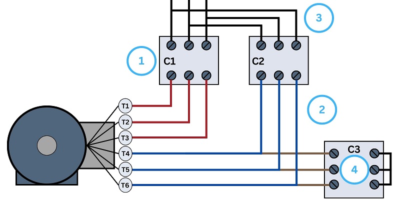

How Do You Wire a Star-Delta Starter?
Understanding a starting method and actually using it are two entirely different matters.
There are two main options for this starting method. The first involves three separate devices: two 3-phase contactors to supply power plus another contactor with three poles, able to create the center of the star (wye). The second method uses a dedicated star-delta starter, which supplies all of the previous devices, but in one single (and often $$$) device.
Figure 3. Diagram of wiring a star-delta starter, with each step labeled in blue. Image used courtesy of the Control Automation engineering team
Wiring a Star-Delta Starter
We will use a 6-wire motor as an example. If you have a 12-wire motor, join T4-T7, T5-T8, and T6-T9 and you have 6 wires left over.
1. The first motor contactor (C1) is connected to T1, T2, and T3, the ends of each of the three windings. Connect the input side of this contactor to the supply L1, L2, and L3.
2. The second motor contactor (C2) is connected to T4, T5, and T6 (which would be T10, T11, and T12 if you have a 12-wire motor), which are the other ends of each motor winding.
Unlike a reversing motor starter, these contactors are NOT interlocked, there will be a very good reason to have them both energized at the same time…. But not yet.
3. To the input side of this second contactor (C2), bond incoming L1 to L3 of the second contactor, incoming L2 to L1 of the second contactor, and incoming L3 to L2 of the second contactor.
Note: DO NOT USE a reversing bus bar for this operation since it only reverses two of the three leads, and you will end up with a short-circuit.
4. Finally, to the third contactor (C3), connect T4, T5, and T6 (again, this would be T10, T11, and T12 if you have 12-wire motor), and jumper all three of the incoming terminals to each other. This will create a single connection between all three when the contactor is energized.
To use the new wiring setup at initial startup, energize C1 and C3 while keeping C2 de-energized.
After a short time (determined by the load factor of the motors), de-energize C3 and then quickly energize C2. C1 stays energized the entire time.
This works because during startup, each winding is supplied with full voltage, but the other sides of all windings are bonded through C3 to create a star (wye) with lower voltage. When switched to run mode, the windings are now connected in a perfect delta pattern with full voltage.
