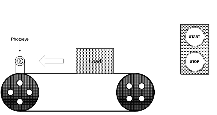

As a simple example, consider the conveying system depicted in Figure 1 below. The operator places a load at the far right end of the conveyor and pushes the “start” button. The load is then conveyed to the left end of the conveyor, and the conveyor stops when the photoeye is blocked by the load.
Figure 1. A conveyor system example is explained above.
The conveyor then waits for an external command originating from another module. When the command is received, the load is transferred off the conveyor, and the conveyor stops once the load has cleared the photoeye. After the operator has pushed the “start”  button but, before the photoeye is blocked, the operator has the option of pushing the “stop” button, causing the conveyor to halt. The operator may subsequently restart the conveyor sequence by pressing the “start” button again.
In this example, a single fault condition is implemented. If the conveyor is running and the load fails to reach the photoeye within a prescribed period of time (10 seconds), a fault is detected, and the conveyor stops.
After correcting the problem, the operator is required to reset the conveyor by clearing the fault through the man-machine interface. Following the reset, the operator may subsequently restart the conveyor sequence by pressing the “start” button.

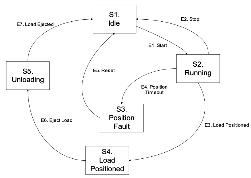

For each module, a state transition diagram is created. The diagram can be hand-drawn, or preferably a software drawing tool can be used to generate the diagrams. The state transition diagram for the conveyor example is illustrated in figure 2 below.
The boxes represent states, whereas the arcs between the states represent events that define the set of transitions between states. The states and events are identified by both a short description and a number. In our example, the conveyor is initially in the “Idle” state (by convention, the first state, S1 is considered to be the initial state).
When the operator presses the “Start” button on the control panel, the transition “Start” (event E1) is taken, and the module transitions to the “Running” state (state S2). While in the “Running” state, the conveyor motor is energized.  Each event is triggered by a set of predefined conditions.  For example, “Start” (event E1) is triggered by pushing the start push-button.

Figure 2. The CV1 State Transition Diagram.
