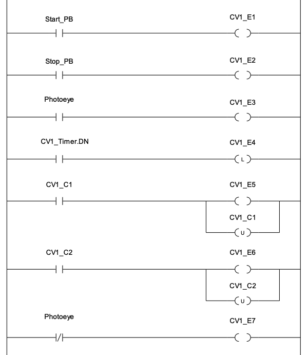

Listing 2 depicts the ladder logic required to implement the event conditions for the conveyor. The output of each rung triggers an event bit. Events are named symbolically, the symbol constructed as the concatenation of the subsystem mnemonic “CV1” (for Conveyor #1), followed by an underscore “_”, an “E” for “event”, and finally the event number as specified in the state transition diagram. A similar naming convention is used for the command and state words as well, substituting instead the letter “C” for command, or “S” for state.
In many cases, an event may simply track an input such as a push-button or a photoeye. Notice that those event condition rungs triggered by a command, are responsible for unlatching the respective command bit. This allows an external entity to simply set the command bit to initiate a module function (it does not have to synchronize clearing the bit with the module).
In effect,  the behavior is much like a momentary push-button. The initiator simply latches the command bit on, the receiving module triggers the event, then immediately unlatches the command. Most events are momentary and therefore remain true only for a single logic scan. However, if an event is considered a “fault” event such as the case for  CV1_E4, it is latched so that when the associated fault state is entered, the operator can determine the cause of the fault (as many faults conditions can lead to a single fault state). Upon exiting the fault state, the associated fault condition bits are cleared.

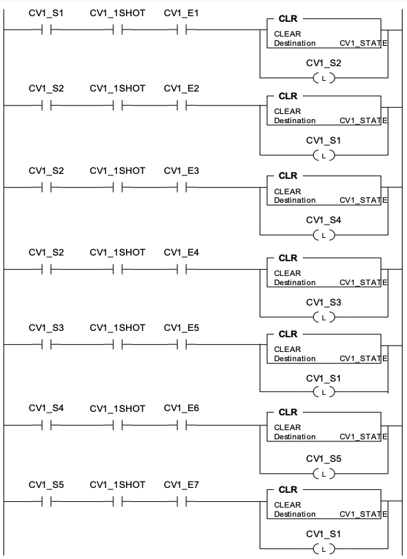

Listing 3 depicts the ladder logic required to implement the state transition logic. Each rung defines a state transition corresponding to an arc connecting a pair of states on the state transition diagram. For example, the first rung implements a state transition from state S1 to state S2 on event E1. Semantically, this can be expressed in structured  English as:
IF
Currently in state S1 (CV1_S1 is “true”),
AND no other state transition has yet occurred during this scan (CV1_1SHOT is “true”),
AND event condition E1 is TRUE (CV1_E1 is “true”)
THEN
Exit our previous state S1 AND clear the one-shot bit
(note that both of the above actions are accomplished by performing the CLR instruction on the entire state word)
AND enter state S1 (latch CV1_S2)

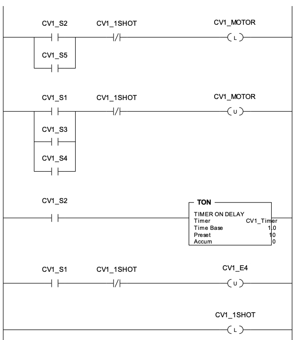

Listing 4. State Processing Ladder Logic.
Finally, Listing 4 depicts the ladder logic implementing the state actions. For example, the first rung turns on the conveyor motor when initially entering the “Running “state S2 or the “Unloading” state S5. The use of the one-shot bit causes these actions to be edge-triggered.
The third rung runs the position timer when in the “Running” state S2.  Since the one-shot bit is not used here, the rung is level triggered and therefore runs continuously while in state S2. Finally, the last rung sets the one-shot bit (remember it was cleared by the CLR instruction when transitioning into the current state) since a full scan of the module has occurred.
