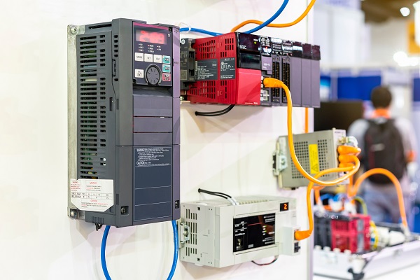

Static IP addressing is a very labor-intensive method. At least with a network connection, you can access the various devices remotely, but you still must apply settings and set each one individually. If you lose count, there may be a conflict. It’s exhaustive enough at first setup, but if the network needs to change, you must repeat the process for all machines.
A typical automation network
Figure 1. A fairly typical simple automation network with a motor drive, network switch, a couple PLCs, and likely a programming PC. Image used courtesy of Adobe Stock
Inserting new machines into an existing network can also create inconsistencies in the static IP numbering, and before too long, the numbers are completely out of order with how the machines are physically arranged.
