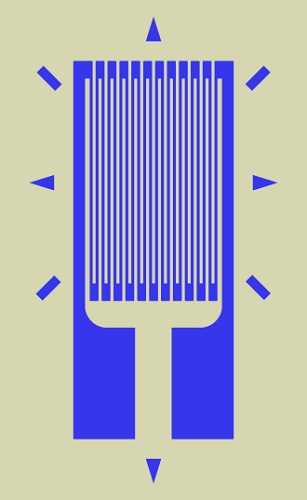

At first glance, a strain gauge is nothing more than a little piece of metal. It gets stretched or compressed as you push or pull it. If it is not stretched very much (a small fraction of a percent), it will return to its original position. The usual arrangement is a zig-zag pattern, having most of its pattern in one direction.
Typical layout of a strain gauge
Figure 1. Strain gauges usually use a zig-zag pattern. Image used courtesy of HBM
Strain gauges are most commonly built with metal foil, but also with fine gauge wire or metal film. They need to be quite thin to have enough resistance. The majority are either 120 ohms or 350 ohms, although there are others. Sometimes they are used in arrays of two, three, or four gauges.

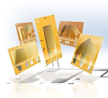

Below is an image of various strain gauge layouts. They include a couple of examples with more than one element on the same backing, which are called rosettes. We’ll cover them in a following article, in which we discuss applications.
Sample of various strain gauges
Figure 2. A variety of strain gauges. Image used courtesy of HBM

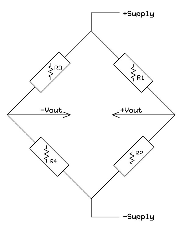

Most strain gauge configurations use two, three, or four elements. Here’s a 4-element circuit that is commonly used, called a Wheatstone bridge. Any single element may be either a strain gauge or a fixed resistor.
Wheatstone bridge circuit
Figure 3. Wheatstone bridge. Image used courtesy of the author
Here’s how a Wheatstone bridge works. In our example, each resistor is 350 ohms (a typical value for a strain gauge). Assume that each resistor is configured to drop 5 volts from a 10 volt supply in the natural state.
Now, if resistor R2 increases by 0.2% (350.7 ohms) and the others do not change, the voltage of R2 (also the value of +Vout) will be 5.005V. However, -Vout would remain at 5.000 volts. The result is that the difference between +Vout and -Vout will become 5 mV (0.005) instead of zero.
Quarter, Half, and Full Wheatstone Bridges
A quarter bridge uses only one strain gauge. The others all are fixed resistors. The fixed resistor, R1, would usually have the same resistance as the strain gauge resistor, R2.
A half bridge uses two identical strain gauges, R1 and R2. If the fixed resistors (R3 and R4) are the same, the bridge will be balanced; that is, zero difference. Then, if one element is stretched (R2, resistance increased) while the other is compressed (R1, resistance decreased), there will be a difference. Using both elements doubles the sensitivity.
In some applications, only one gauge is active: the other is held firm and does not move. The usual reason is that both gauges will vary the same way when the temperature changes so that there are no temperature-related effects.
Sometimes a full bridge is used; that is, all four legs are strain gauges. Two elements are stretched, while the other two are compressed. This arrangement creates four times as much sensitivity as a single element. Of course, there are applications where not all four elements are active or able to move. Again, this minimizes temperature variations.
To be precise, if there are two strain gauge elements but only one is active, the result would be called a quarter bridge. Likewise, a four-element bridge with only two active legs would still only be called a half bridge.

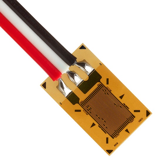

Small strain gauge image
Figure 4. Close-up picture of a small strain gauge. Image used courtesy of Micro-measurements
