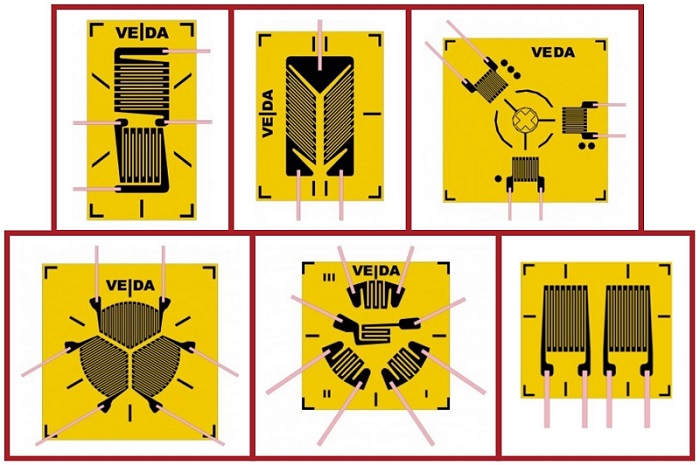

Sometimes you need to have more than one strain measurement at the same time, often three or four, to compute strain at more than one angle. The three strain gauge elements (or four, or two, or sometimes something else) are combined in something called a rosette.
A variety of rosette strain gauge designs
Figure 1. A few examples of strain gauge rosettes. Image (modified) used courtesy of Veda
The most common rosettes have three elements arranged in either 0º, 45º, and 90º; or 0⁰, 60⁰, and 120⁰. Others include 0⁰, 120⁰, and 240⁰, and others. There also are two-element rosettes arranged at 0⁰ and 90⁰, and four-element rosettes arranged at 0, 45, and 90 degrees. There are others.
There are planar rosettes and stacked rosettes. The stacked rosettes are stacked one on top of each other. The planar rosettes are side by side, not on top of each other.
Each element needs its own Wheatstone bridge; in other words, usually three Wheatstone bridges per rosette. Then, each bridge usually has signal conditioning to turn it into a digital quantity. After that, some fancy calculations can compute the strain at multiple points simultaneously.

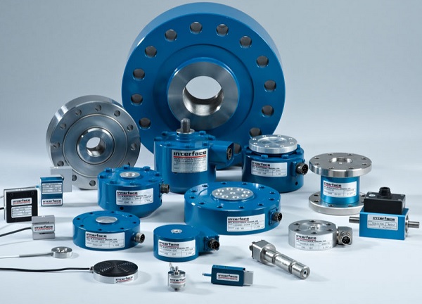

For industrial uses, most people would think about weight and force measurement. A typical device is a load cell. Here’s an assortment of industrial load cells.
A variety of industrial load cells using strain gauges
Figure 2. An assortment of industrial load cells. Image used courtesy of Interfaceforce
Weight is usually a static measurement, varying from grams or ounces to kilograms or tons (or tonnes). Applications run from counting parts to weighing trucks and monitoring railroad tracks.

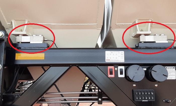

Here’s an interesting weight application: parts counting. Each part can be small, but the total weight may be large and change constantly. Even very small product in large volumes, such as the load in a dump truck, or the seed content of an automated ag seeder, can be measured with load cells.
Two load cells on a tractor
Figure 3. Load cells are used to measure the amount of seed in a cultivator. Image used courtesy of Control Automation

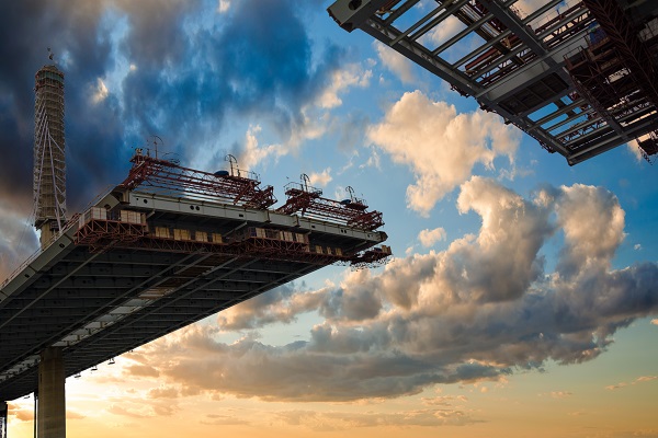

In utilities and civil engineering, strain gauges are used while testing new design ideas and then again after the design is finished. This includes cable bridges, wind tunnels, buildings, dams, tunnels, and more. More strain gauges often are permanently built in to allow repeat monitoring months and years later.
Bridge construction projects use load cells to measure force and flex
Figure 4. Strain gauges are used in many utility and civil engineering applications. Image courtesy of Adobe Stock
