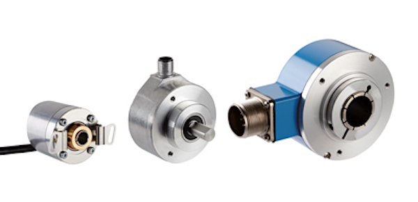

Incremental Encoders
The incremental encoder is used for high-speed, continuous rotations where both velocity and position need to be known. They consist of a simple set of light and dark lines around a disk’s face, with light either blocking or passing through/reflecting depending on the optical type.
Figure 1. A few incremental encoders. Image used courtesy of SICK
The output from these incremental encoders is usually two discrete signals, like an NPN or PNP sensor, high or low. This can determine rotation CW or CCW (clockwise or counterclockwise). There is often a third signal that creates a pulse once per revolution.
There are relatively few signals for incremental encoders, but they must be monitored at a very high speed (e.g., a high-speed counter module). Although your exact angular position can be tracked once the system has started, it’s impossible to know where you are at startup if power is lost.

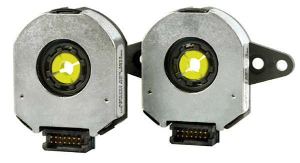

Absolute encoders solve the problem generated by any intermittent power loss by creating a unique series of patterns around the disk. At any time, a reading of that pattern can show the exact position of the encoder. These are useful for servo motors, which typically stop, reverse, and follow complex motion paths rather than being devoted to long constant-speed driving motions.
If the same communication strategy were applied from an incremental to a rotary encoder, each part of the disk pattern would need its own sensor wire. This would create as many as 12 to 14 individual signals. Instead, the data is sent through a serial interface to save wires and signal integrity—this is the purpose of SSI.
Figure 2. A modular absolute encoder. Image used courtesy of CUI Devices

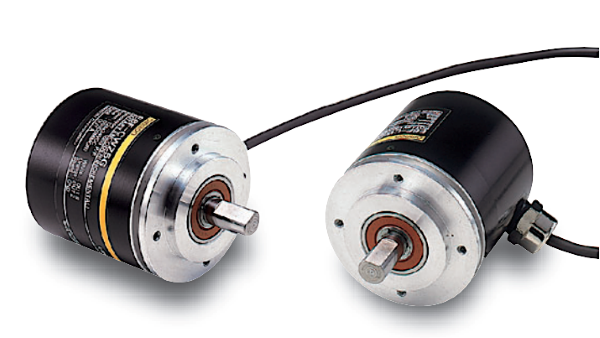

Client Device
The client encoder generates the second signal. Each time a clock pulse is received, a new data bit is placed at the outgoing pin of a shift register. The data stream reflects the light/dark pattern of the entire disk, so there will be 12–14 bits in series, then a repeat of the pattern.
The clock speed must be high enough that a pattern reading is taken before multiple pattern transitions have been crossed. The speed is often a function of cable length (i.e., longer cables reduce speed). A low transmission speed might be around 100 kHz or bits per second.
Figure 3. A rotary encoder. Image used courtesy of Omron

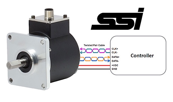

Wiring for SSI Encoders
In a typical SSI device, there are six wires.
  • The first two provide +V and Gnd to supply power for the integrated circuits in the sensor transducer.
  • Each of the other two signals, the Clock and Data, consist of twisted pairs, denoted by C+ (or CLK, or Clock, etc.) and C-, and by D+ (or Data, etc.) and D-.
For most applications, a matching encoder and controller will have a keyed connector, eliminating the risk of incorrect wiring.
Figure 4. Wiring for SSI encoders. Image used courtesy of RoboteQ
