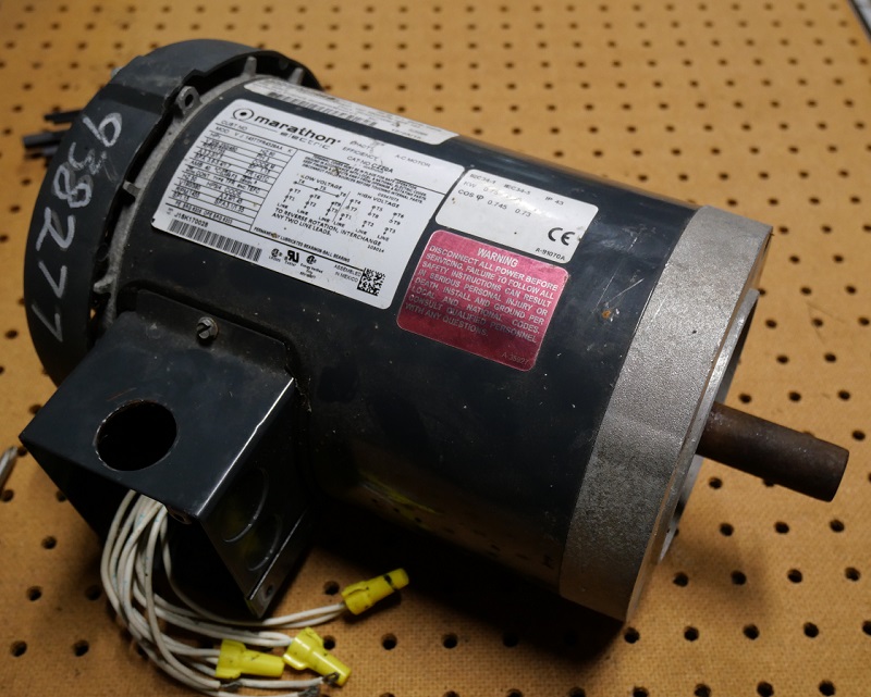

The most visible part of the motor is the outer metal casing. For these 3-phase induction motors, there are likely to be a few similarities. First, a sealed wiring box extends out the side. These can contain 3, 6, 9, or 12 wires, with 9 being the most common variation. Weather-resistant gaskets prevent moisture from corroding the wire nuts or screw terminals inside this wiring box.
Figure 1. Today’s unwilling participant: a 1-HP 3-phase motor.
The data plate on the side of the motor explains the details of proper wiring and the electrical properties which are important both for installation and for setting parameters on a digital drive (VFD).

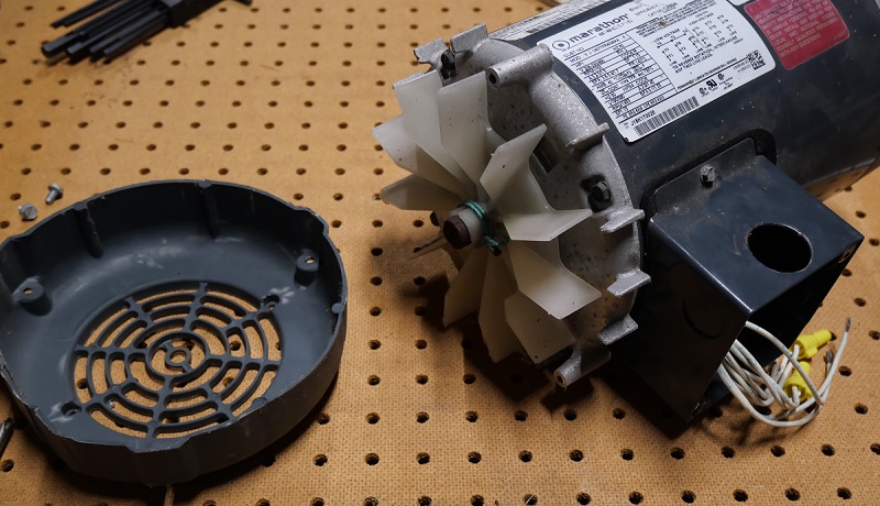

For this general-purpose situation, it is common to find a fan attached to the drive shaft on the reverse end of the motor, covered by a shroud to protect the blades and operators from damage.
Figure 2. Cooling fan with the shroud removed. Note the moisture corrosion on the retaining clip, indicated by its green color.
This fan is usually constructed from plastic to reduce weight and is carefully balanced so that it will not introduce vibration to the motor. In cases of extreme heat or damage, the fan can twist, warp, or break, so it is important to be very careful to keep the casing free from obstructions or conditions that are out of tolerance for the motor model.

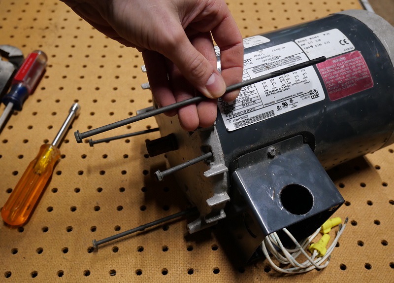

For most smaller motors, a set of long screws secures the front end to the back end, containing the entire assembly together in the middle of the motor case.
Figure 3. Long screws attach the front end of the casing to the back end.
Once these screws are removed, both ends can be removed with little force. If you ever must perform this level of disassembly, there are a few important details to explain.

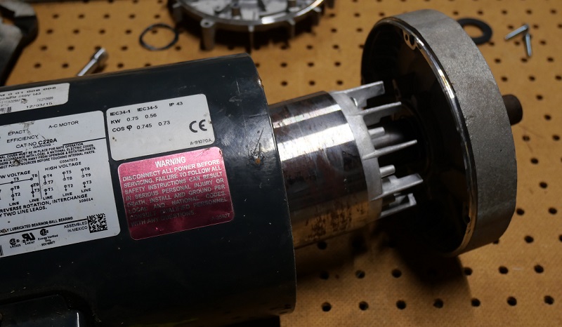

The inner part of the induction motor is the part that actually rotates, and this contains the shaft of the motor, into which the entire external machinery depends. This rotating component is called the ‘rotor’. You can see the end of the rotor extending from the body of the motor in Figure 4 below.
Figure 4. With the end plate removed, the shaft of the rotor is clearly visible. This is the reverse side of the motor, so this is where the fan was installed before it was removed.

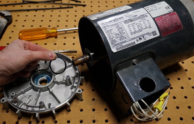

The motion of the rotor is perhaps the most important quality of the motor, aside from the electromagnetic coils themselves. A roller bearing is carefully selected and installed to ensure the shaft rotates concentrically through the coils. A wave washer, along with grease, is installed to be sure that once the screws are tightened, the end cover never comes in contact with the moving race of the bearing. If this were to happen, friction would increase, causing heat, damage, and eventual failure. Take note of any washers that should be included with the reassembly. If missed, you may not notice the problem immediately, but you can expect the lifespan will be shortened.

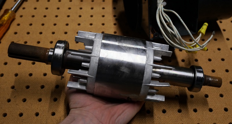

The Rotor
The rotating piece in the center of the motor is one half of the interaction that actually makes a motor work. We’ll get to the winding coils in just a minute.
The rotor is a carefully constructed, perfectly balanced shaft of metal with a high iron concentration. This ferrous content allows it to be influenced by the current in the coils around it. As the current progressively charges the winding coils, the rotor responds with a magnetic attraction in incremental degrees around the outside, pushing and pulling it in a circle. Smooth balanced rotation.

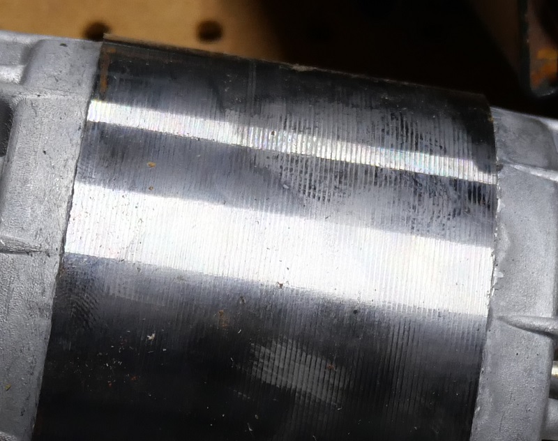

I want you to look carefully at a close-up view of the rotor construction and observe a very important quality about it.
Figure 7. Close-up of the rotor construction.
The rotor appears to be made out of hundreds of thin slices of metal, all bonded together. In fact, this is exactly what it is. This is referred to as a ‘laminated’ construction, with each iron layer separated by an electrically insulated disk. The reason for this construction is a concept called an ‘eddy current’.

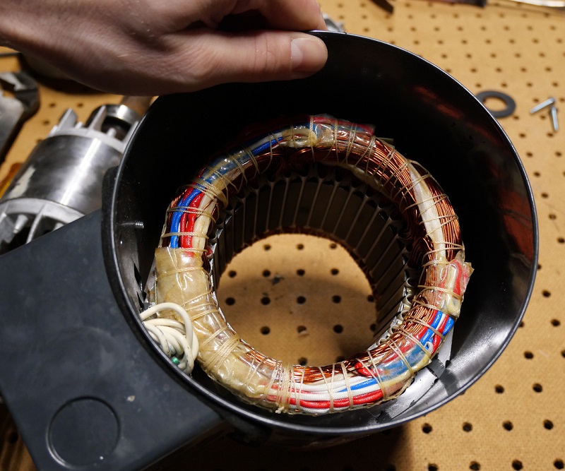

Finally, the last important piece of the motor is the set of windings wrapped around the rotor but never contacting it. Since this part of the motor is stationary, it is called the ‘stator’, to complement the rotor.
Figure 8. The winding coils.

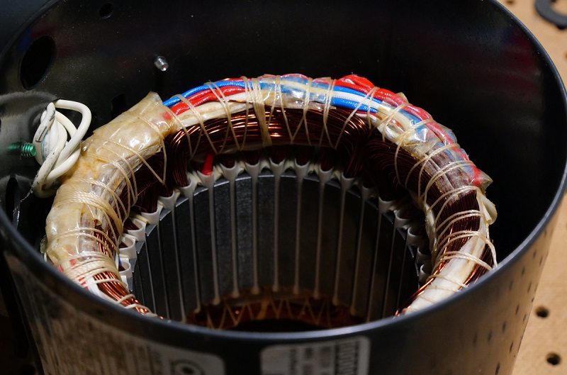

The 3 phases of electricity are not placed in three groups around the outside edge, as might be often shown in simple animated graphics of motor theory. If there were only 3 large windings, the force would be applied only to one edge of the rotor at a time—not very good for balanced rotation.
Instead, the three phases are split and distributed around the perimeter, providing a nice, smooth balance of force.
Figure 9. Close-up of the stator, with the windings passing through isolated slots.
This motor has 36 individual winding distributions. This means that each phase will be energized equally 12x times around the perimeter, as distributed by the 6 individual coils, and wired for high or low voltage by the electrician.
