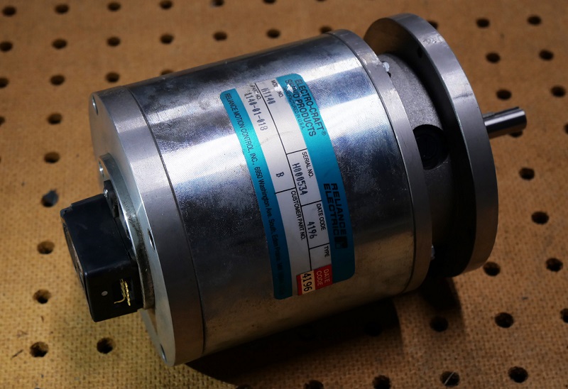

DC Servo Motor
Figure 1. The view of a DC servo motor from the outside.
Outer Casing of DC Motor
Since this is a DC motor, we expect to find a marked (+) and (-) connection for voltage input. On this particular motor, the screw terminal connections are located within the neck at the top, exactly 90 degrees offset from each other. At the opposing sides sit small plastic screw covers. Hidden beneath these four locations are the secret to a brushed DC motor.

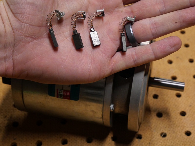

Servo DC Motor Brush
Figure 2. Removal of one brush from this brushed DC motor.
In the image above, you can see a small spring attached to what looks like a block of graphite, reminiscent of pencil lead. In fact, it is very similar. There are several compositions of brushes, but they all contain carbon. The most modern materials are a packed graphite, essentially the same as pencil lead, but mixed with metal powder to provide greater conductivity and strength.
The purpose of the carbon brushes will be explained later in the teardown, as the interaction between brush and rotor happens deep within the motor.
The reason for the spring illustrates one of the disadvantages of this motor variety. As the motor rotates, the carbon wears down, which creates a point of both friction and contaminating dust, as we will clearly see when the rotor is revealed.
Carbon brushes from motor
Figure 3. All four carbon brushes, set 90 degrees apart, can be clearly seen.
Many brushed motors use two brushes, 180 degrees opposed. This allows electricity to enter one side of the motor, be passed to the rotor winding, then exit through the other side of the rotor.
This motor has four brushes, each spaced 90 degrees around the perimeter. Four contact points allows two windings to be equally polarized, but set on opposite sides of the rotor for a smoother rotation. Still only a single circuit is completed, just as with a two-brush motor, but now the current can pass through the rotor windings on each side in a parallel circuit.
