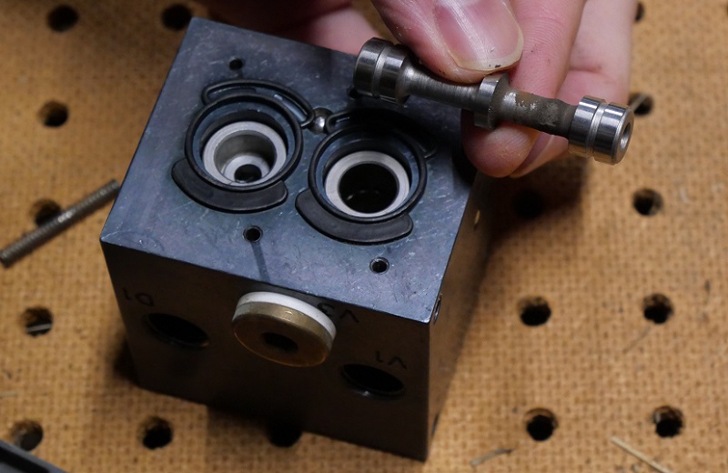

That metal disk is the end of the ‘spool’. This spool is the name for the moving piece inside the valve body which allows or prevents the flow of air in and out of certain ports.
Force applied to stem
Figure 7. Demonstration of the application of force against the spool.
In many valves, an ‘exhaust’ port will allow the emptying of air from a double-acting cylinder. The way the air is routed inside the valve is the job of the spool. In the image above, I use a wrench to show the motion of the spool inside the valve. In actual operation, this force is supplied by the air pressure present in the system. In a sense, the air pressure controls the air flow, but only when the electrical signal allows it to work.
Valve spool
Figure 8. The spool removed from the valve.
In the manufacturing process, this single block of metal must be machined by practical processes, and the internal passages of air are anything but simple. To achieve the correct internal structure, a set of holes are drilled and tapped into the sides of the block, all interfacing with a central drilled hole. This central hole is fitted with a routing piece, with both holes for airflow and gaskets for an air-tight seal.
Internal Air Routing
Figure 9. Air routing component, and it can be clearly seen which passageways are most heavily used in this valve body.

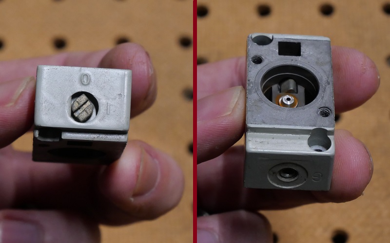

Manual Relief Control
One final discovery about this valve takes us back to Figure 5. What if the valve was de-energized and the port was closed, but in a moment of emergency, it needed to be opened? You don’t have time to disassemble the solenoid, so you turn the manual relief control. This small screw (left side of Fig 11) turns a small cog (right side of Fig 11), pushing against the spring plunger and manually forcing air to flow and change the spool position.
Manual Valve
Figure 11. Top and inside view of the manual relief control screw.
