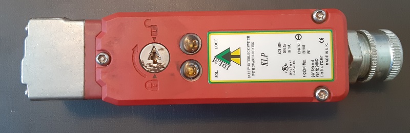

Before we dive inside the switch, let’s have a look at the outside of this particular specimen, the KLP guard interlock from IDEM.
Outside of the safety guard lock switch
Figure 1. The outside of the IDEM guarding interlock. Image used courtesy of the author
This safety switch is unique in several ways. First, the housing with the wiring connectors is closed with tamperproof torx (star) screws. Most automation wiring terminals, if they are covered at all, can be easily opened by depressing a small tab or button. For safety devices, the extra layer of tamperproof design ensures that it is installed and remains securely in place.
The mounting bolts are also hidden under this protective cover. The device can’t be uninstalled unless the cover is removed.

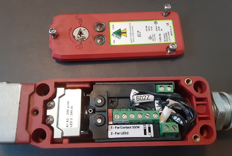

Removal of the top cover shows the wiring blocks for the power and for the signals.
There are multiple signals inside a safety switch - even more than inside standard E-stop buttons. Four of the terminals are dedicated to sensing the condition of the switch internally, both the solenoid’s position and the actual position of the lock. Two terminals provide control power to the solenoid (supplied from another safety circuit). Two other terminals provide an auxiliary monitor for the status of the lock. Finally, the last two terminals provide a selectable input, either to provide power to an indicator LED or to monitor the position of the solenoid.
Cover removed with wiring terminals visible
Figure 2. Terminal block connectors for wiring. Image used courtesy of the author
It’s important to note that this is just one example of a safety switch wiring configuration, other models and manufacturers may provide some slight variations. However, the power supply and redundant monitoring circuits are integral to all safety lock switches.

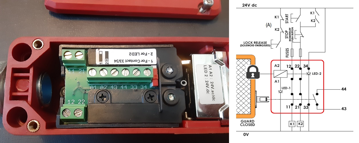

A slightly closer examination of the terminal block numbering alongside the installation guide shows the arrangement and purpose of each terminal with the existing wires removed. By the way, for a quick review of those numbering conventions, like 11-12, 21-22, and 43-44, have a look at our article that talks about relay numbering; it’s quite interesting…
Detail view of terminal blocks and wiring diagram
Figure 3. Terminal block and wiring diagram. Image used courtesy of the author and a modified excerpt from IDEM (click on image to view larger size)

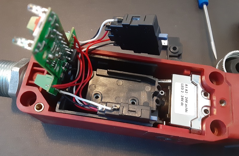

The next layer of the safety switch lies underneath the terminal connection board. With this PCB removed, there are two limit switches visible, tucked along each side of the housing. When I first saw this arrangement, I incorrectly assumed that these two switches were redundantly switching the same target.
In reality, one limit switch senses the position of the solenoid by means of a small plastic bracket fixed to the solenoid shaft. The other limit switch detects the movement of a spring-loaded gate which only moves when the lock mechanism is opened.
Limit switches inside the guard locking switch
Figure 4. Dual limit switches, each with redundant contact sets. Image used courtesy of the author
In Figure 4 above, you can see the two limit switches, one removed for clearer detail. Each switch has 6 wires: 2x red, 2x black, and 2x white. These sets of wires are easily accounted in the wiring diagram. 1x set on each switch is wired in series for contact set 1 and 2 (11-12 and 21-22). The remaining pair on each switch is used as an auxiliary monitor for the state of either the locking mechanism (43-44) or the solenoid (33-34 when the switch is in the correct position).
The element of redundancy exists in the series configuration. The circuit verifies that not only is the solenoid energized, but that the lock has responded appropriately. If either mechanism sticks or fails to respond, the safety circuit will not open.

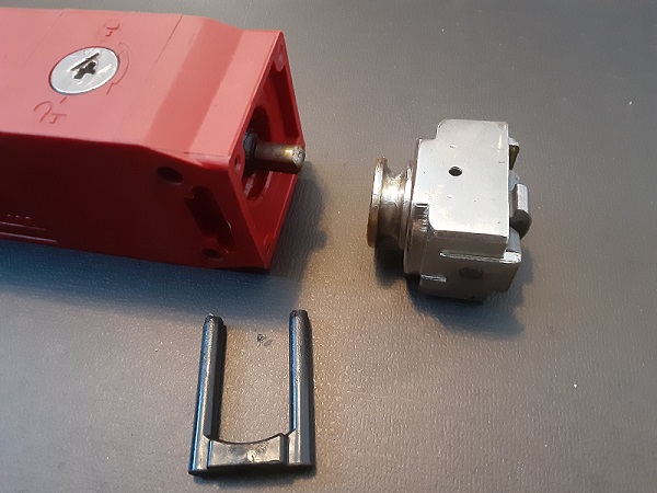

When the four screws are removed from the end, it can be rotated so that the door latch can enter from either of 4 sides, or 4 positions at the end, each rotated by 90 degrees. In this way, there are 8x total locking position configurations available in this switch.
When the entire locking mechanism is removed, a small greased rubber dust cover prevents contaminants and moisture from getting inside the main housing.
Examining the end latch mechanism
Figure 5. Attachment of the end locking mechanism. Image used courtesy of the author

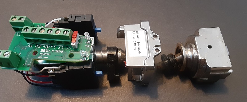

When the solenoid is energized, the rod pulls back into the housing, allowing the latch mechanism to rotate. This allows the gate latch to open and close, but only when the solenoid is energized.
If power is lost or if the solenoid is simply non-energized, the mechanical spring ensures that the solenoid remains extended and the gate latch cannot be removed.
Detail of electrical, solenoid, and mechanical interactive components
Figure 6. Complete electrical and solenoid interaction from the terminals to the latch. Image used courtesy of the author
