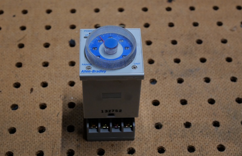

This particular Allen-Bradley timer relay (model number 700-HR for those following along at home) has two sets of contacts and a single ‘coil’ input, which does not actually directly interface with the coil, as we will investigate later.

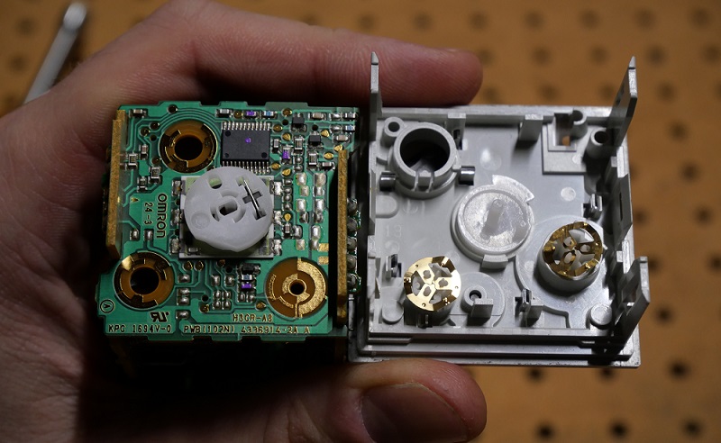

Although the dials on the face are geared together in the top cover, the admustments must interface with the ICs below. All three of the dials (main adjustment, plus range and time base) are set above brushed sliding contacts that meet at the intersection of the top cover and the main relay base.
bottom side of adjustment dials with top side of main relay base
Figure 3. Bottom side of the adjustment dials along with the top side of the main relay base.
One interesting note is a comparison of this Figure 3 with Figure 1.
The left side of Figure 3 above shows the main center dial with white plastic and three other contact pads distributed around. This relay only has two mode configuration dials around the center time adjustment, meaning that there are a few different models of top cover allowing access to more advanced functions.
Understanding Dial Adjustment Types
At the intersection of each of the dials and the main body, there is a coded set of contacts that provide information to the ICs regarding the current position. Examining the figure below, there are two distinct types of dial contact interfaces.
adjustment dial contact pads
Figure 4. Adjustment dial contact pads.
In the center is the main time adjustment. This contact is a continuous (analog) dial, much like a potentiometer, common for motor speed control or volume in an analog circuit. A small, spring-loaded carbon brush slides around the center, making contact with both the inner and outer black conductive rings. As the dial rotates, the resistance changes, also changing the voltage drop, which is converted to a digital quantity indicating the current dial position.
This is not unlike a potentiometer at all, except a slight change in the wiper arrangement.
The smaller remaining pads are more complicated in nature. These are, in fact, very low-resolution absolute encoder disks. The shiny copper contact pads create a binary pattern outward from the center. As the dial is rotated by ¼ or ⅛ of a turn, a sudden change in the binary pattern indicates to the IC that a new time base or time range has been selected, and it can properly handle this new configuration.

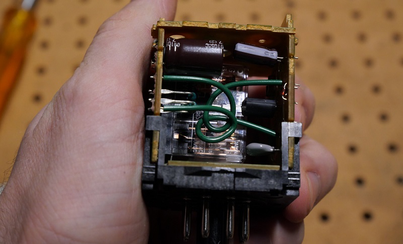

Is it redundant to say that this relay contains a relay?
It sounds odd to say, but this is the case. There is a standard DPDT relay that is energized by the logic from the IC, provided by the supply voltage.
Figure 5. Surprise, this relay contains a relay. I just had to say it…
Since the internal circuitry indirectly supplies the relay coil, it is actually far more tolerant of various voltage ranges than a typical ice cube counterpart. This relay is rated for 24-48 VAC, or 12-48 VDC, and the voltage regulation inside will ensure that the voltage reaching the coil is sufficient for operation.
