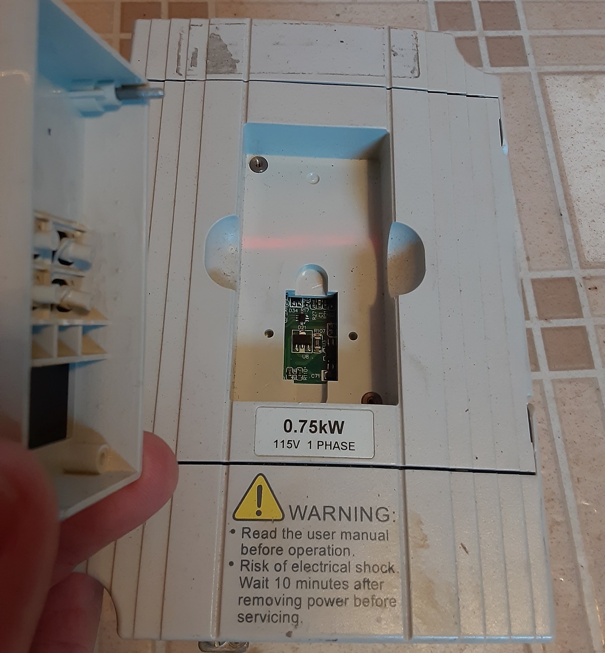

Human Machine Interface (HMI) on a VFD
The top layer of any VFD is a forward-facing HMI, usually with push buttons and a display. In modern VFDs, these might even be touch-screen capable. This device provides access to monitoring critical stats and changing process parameters.
slot for HMI or blank cover to prevent access
Figure 1. Slot for HMI or blank cover to prevent access.
Once the programming is finished, these HMIs can be replaced with a simple blank cover or a cover with only display abilities to prevent unauthorized adjustment which can create hazards.

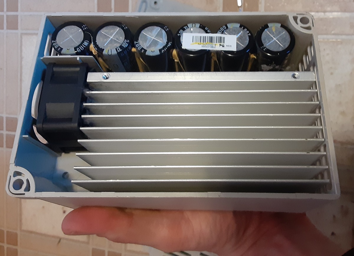

Heatsink and Fan
This IGBT module is attached to the heatsink through an electrically insulated but thermally joined junction. The large aluminum fins of the heatsink pull the heat away from the transistors, and the fan forces cooler air over the fins.
installed heatsink and fan and capacitor bank
Figure 5. Installed heatsink and fan. The capacitor bank (discussed later) can also be seen.

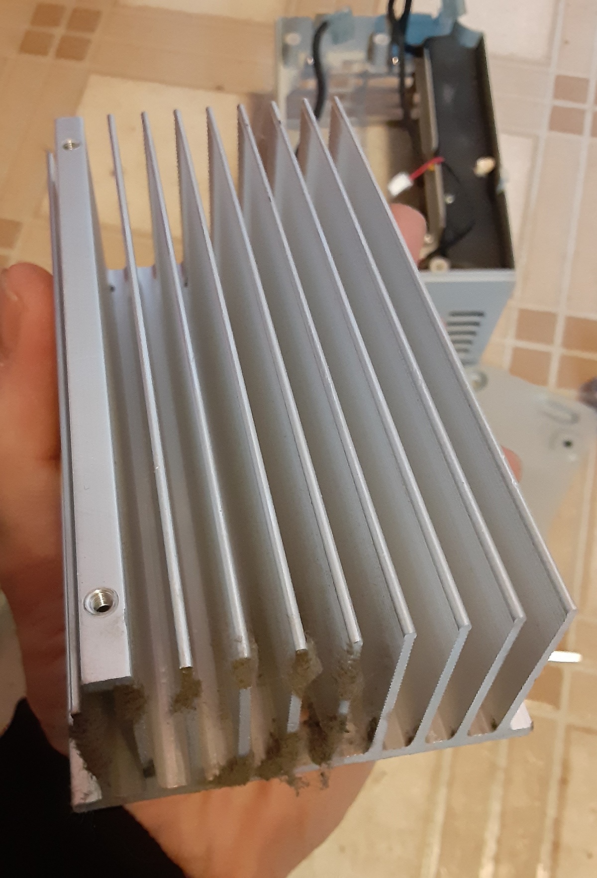

Two main problems can prevent proper cooling and premature failure. The first problem is a lack of proper ventilation. If the VFDs are mounted too close to other components, or inside an enclosure that cannot properly vent the air, there will be limited cooling.
Aluminum heatsink
Figure 6. Aluminum heatsink. The dust buildup on the bottom indicates a dirty operating environment in its previous life.
The second problem is the failure of the fan itself. In dusty environments, the bearing can wear out and stop operating. This VFD, along with most others, has a removable red and black wire so the fan can be replaced with relative ease. Keep your ear out for grinding noises when the VFD is running, as this might indicate that you should replace the fan before the VFD fails at the worst possible time.
Bus Filtering Capacitors
The final layer of this VFD is a bank of capacitors—six of them in this case—all wired into a set of two parallel resistor banks. These capacitors create a smoothing, or filtering, effect for the voltage that comes into the VFD, being immediately converted from an AC sine wave into a single-directional, but still fluctuating, waveform.
Capacitor bank to smooth out DC voltage ripple
Figure 7. Capacitor bank to smooth out the DC voltage ripple
Once the DC voltage is smoothed into a constant voltage, the current can be directed back through the IGBT module to recreate the AC output.
Sometimes, when electrolytic capacitors sit for a very long time (years), they can become dry. It is a good practice to fire up a VFD every once in a long while to ensure that the capacitors will be in good working order when it comes time to call the VFD back into service.
