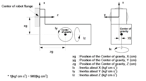

  • Center of Gravity: Knowing the CoG allows engineers to optimize the design of the EoAT for efficient operation. By aligning the payload's center of gravity with the robot’s axes of rotation, engineers can reduce the torque required to move the payload, thereby improving the robot's overall energy efficiency and performance. An aligned CoG is essential in applications where the robot needs to handle heavy or bulky objects, as minimizing torque requirements can extend the lifespan of the robot's motors and actuators.

Center of gravity example
Figure 1. Visual representation of equation factors used to calculate your center of gravity. Image courtesy of FANUC

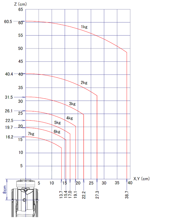

Most robots are accompanied by a wrist load diagram, offering insights into the permissible distances for tool manipulation in the X, Y, and Z axes before experiencing a decline in payload capabilities.
X, Y, and Z deviation as related to payload capacity
Figure 2. The further the robot reaches across all 3 linear axes, the more the payload capabilities decrease. Wrist load diagram used courtesy of FANUC
For example, despite a robot's nominal payload capacity, exceeding specified distances in the z-axis can significantly reduce payload capacity. Therefore, it is vital to consider the robot's reach within the workspace and refer to the wrist load diagram before designing your end-of-arm tooling. Without such guidance in the manual, reaching out to the robot supplier for clarification is advisable.

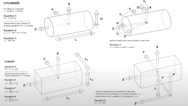

Inertia calcuations for certain shapes
Figure 3. Although it's easier to calculate your inertia in Solidworks or AutoCAD (or alternative), you can manually calculate it. Image used courtesy of FANUC
