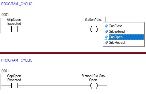

Mapping I/O Tags Manually in Ladder Logic
Rockwell Automation control systems do not offer a hardware-level mapping feature, any mapping that needs to be done is typically programmed in a sub-routine before and after the sequence logic.
Manually mapping I/O with Ladder Logic instructions
Figure 3. The process of manually mapping a single bit to an output coil. Image used courtesy of the author

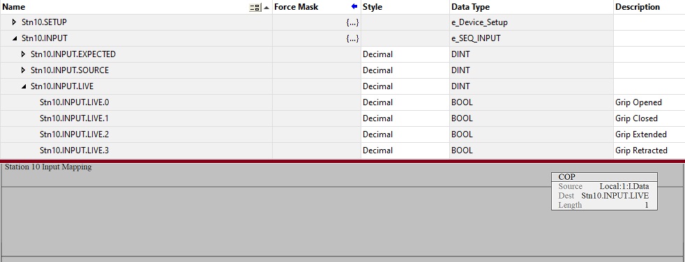

To reduce the number of tags used, it can be beneficial to create a user-defined type that will house all of the station or machine inputs and outputs. In my experience, I like to create an input UDT and an output UDT, then a station UDT that only has two tags: “i” and “o,” with the newly created input and output UDTs. The “i” and “o” tags will consist of all the different inputs or outputs used within that station. Now, with one tag, I can access all of my station-level inputs and outputs by name.
The mapping takes place in a sub-routine called “Input Mapping” and I use a copy instruction to copy the raw data into my input tags. In the “Output Mapping” sub-routine, I copy my station output tags into the raw data tags.
Copying mapped variables from one location to another
Figure 4. Using a single line of logic to copy a DINT from an input module directly into a DINT with descriptive tags. Image used courtesy of the author
If you want to use a more generic method you could create a UDT that doesn’t use the input and output names but rather a double integer type (DINT) for the “i” and “o” tags. This will give you 32 inputs and 32 outputs for each station. Comments can then be given to each bit representing the action that is connected. The mapping would similarly take place as described above.
